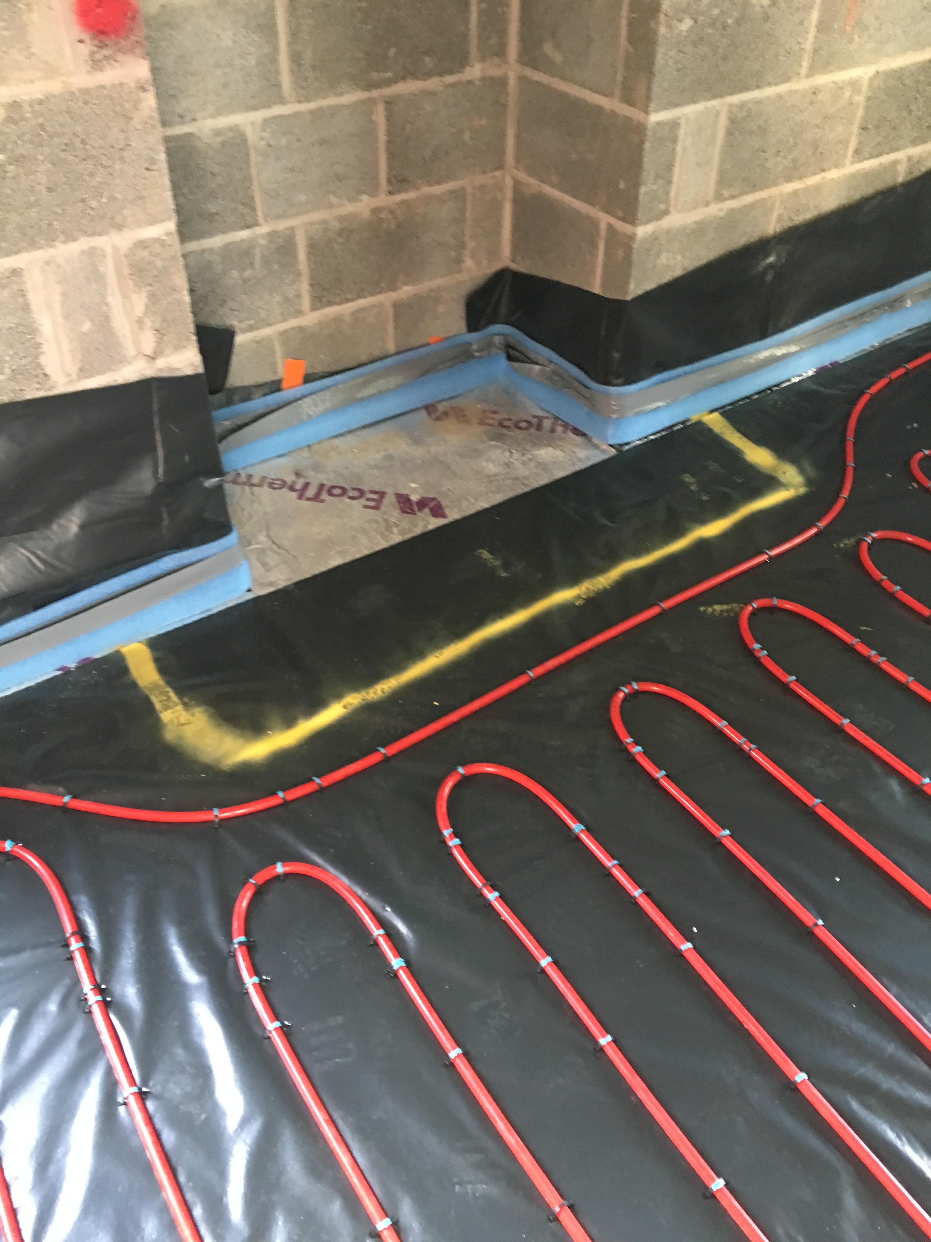

You want a perimeter expansion strip too I think?

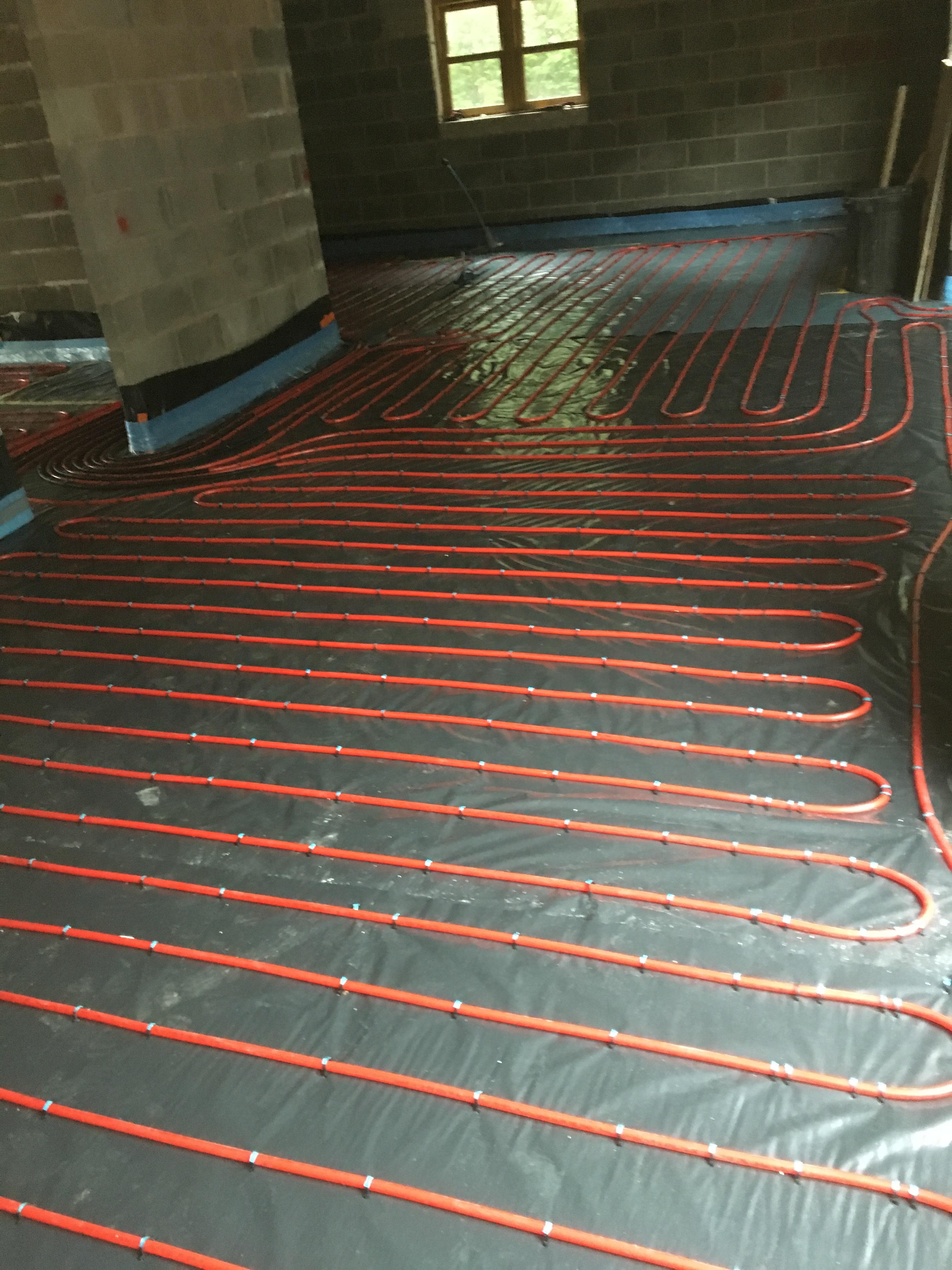

SAM_3091
SAM_3092
I used Polypipe panels instead of an actual sheet of DPM to both isolate the foil from the screed (wet concrete in my case) and to clip the pipes to.
SAM_3103

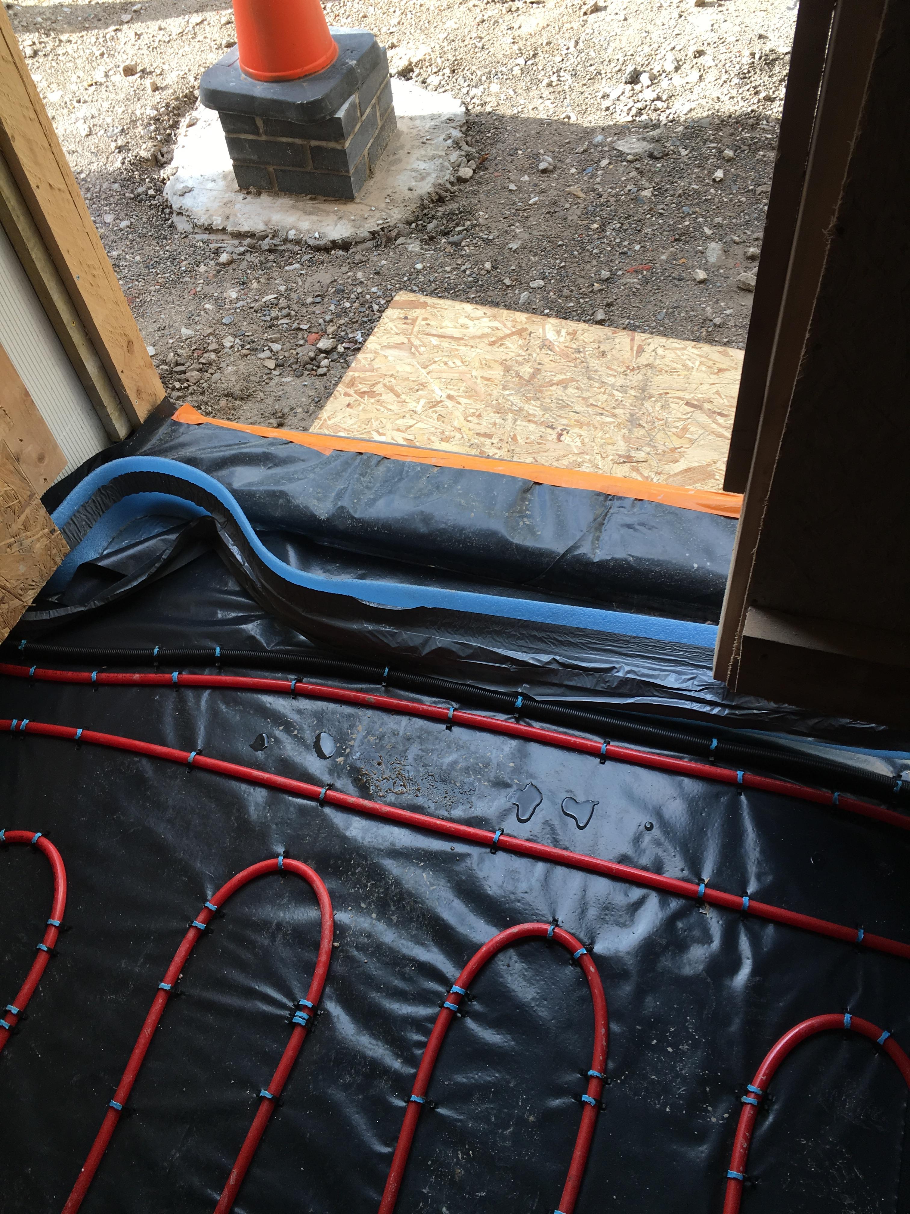

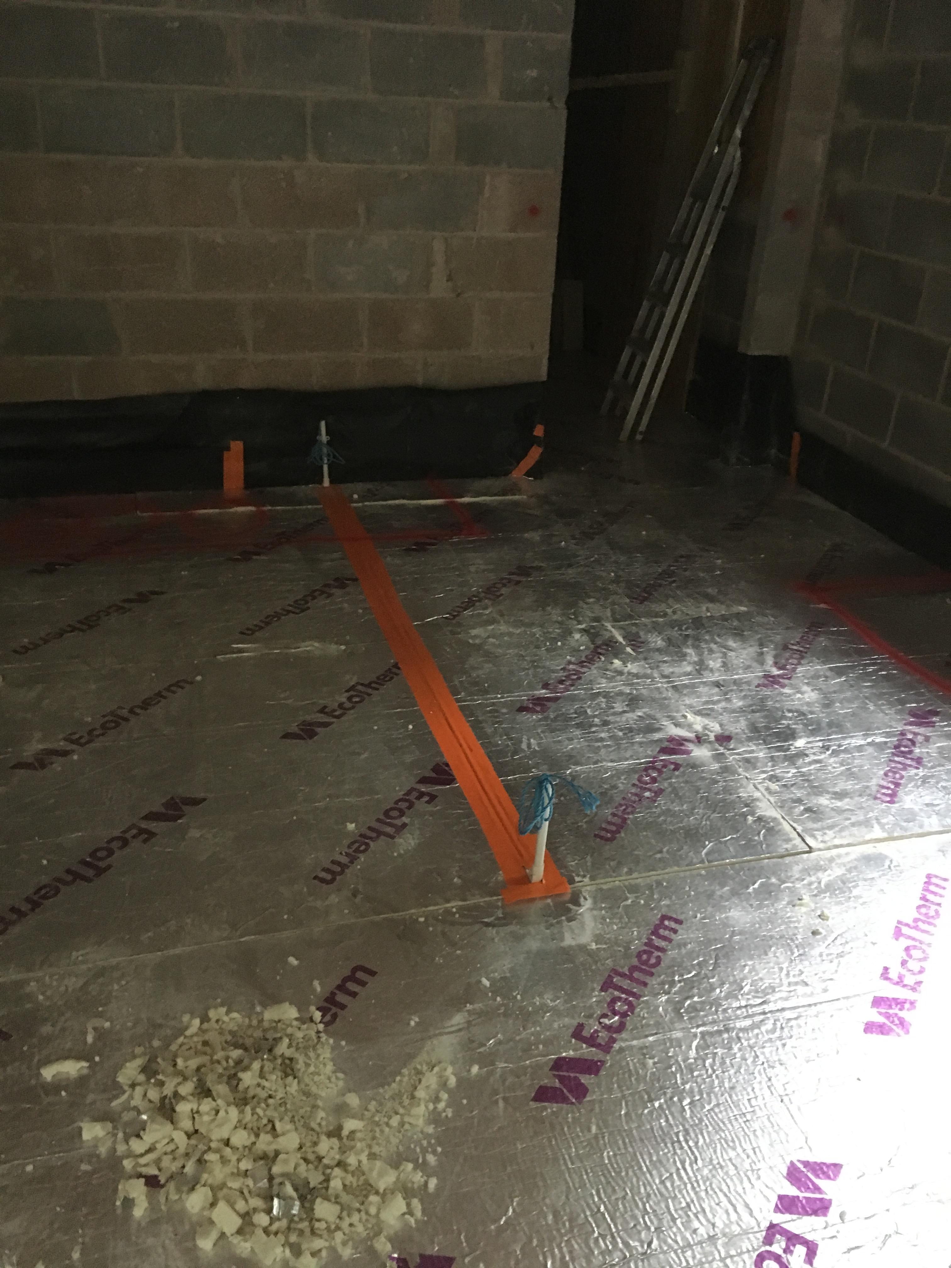

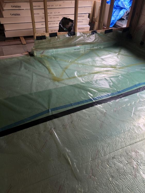

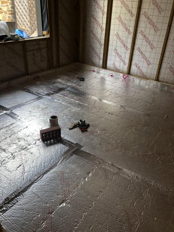

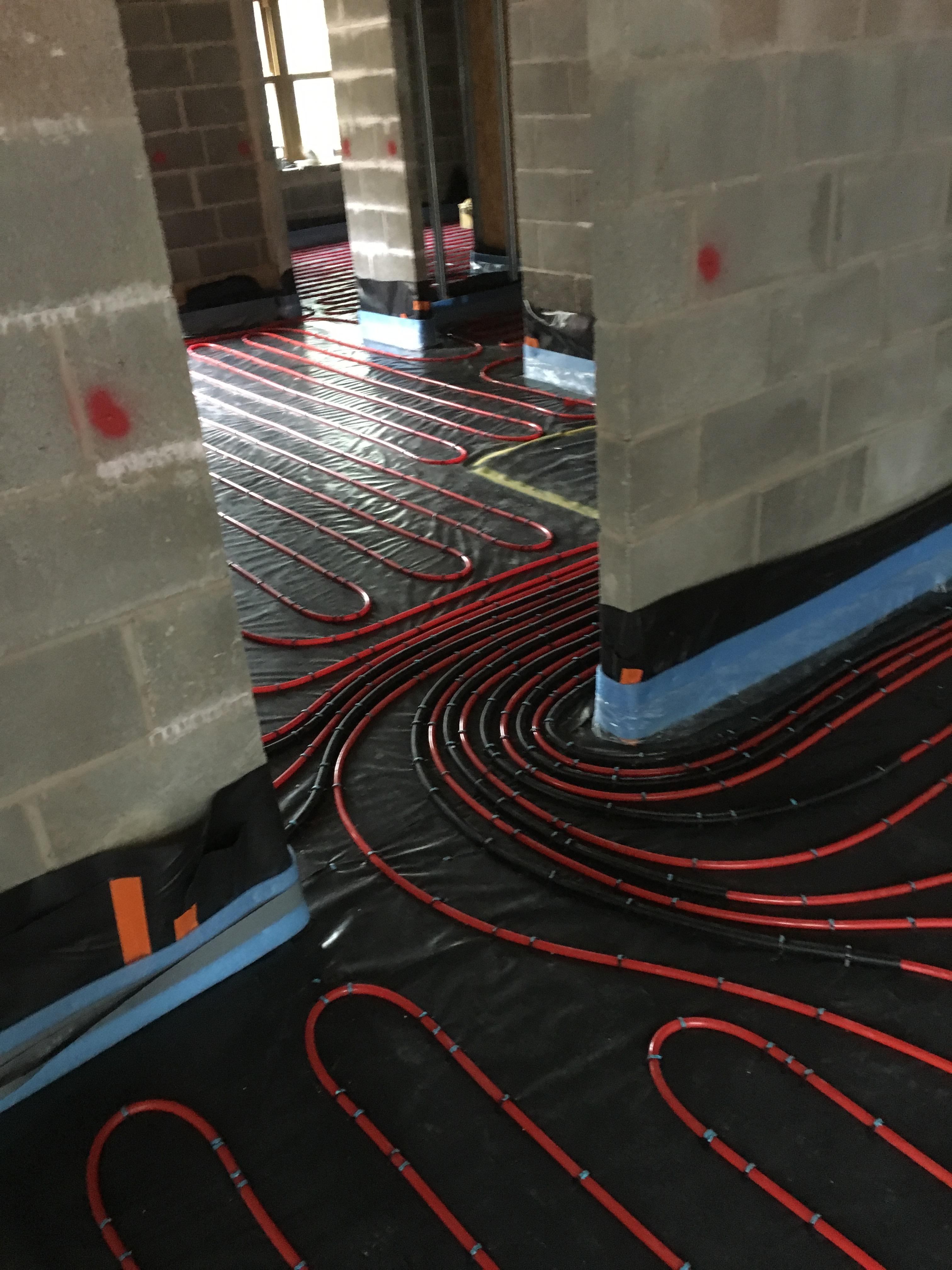

I put a 1 mtr membrane around the perimeter and taped it to the dmp
Then ran then ran another layer up against the walls
and and another layer on top of the 250 insulation
Few pics may help you
  • Thanks 1
Posted
I too did similar taking blue DPM a metre up the two external walls as my picture above. This sits behind the (again blue) DPM that's under the PIR. The window wall was damp as the outside path was above the dpc and the original bathroom floor was on or at the dpc of the internal leaf. I figured any damp getting behind the wall DPM would go straight down and stay under/behind the DPM under the pir.
Posted
Yep only one chance to do it  Worth being over cautious

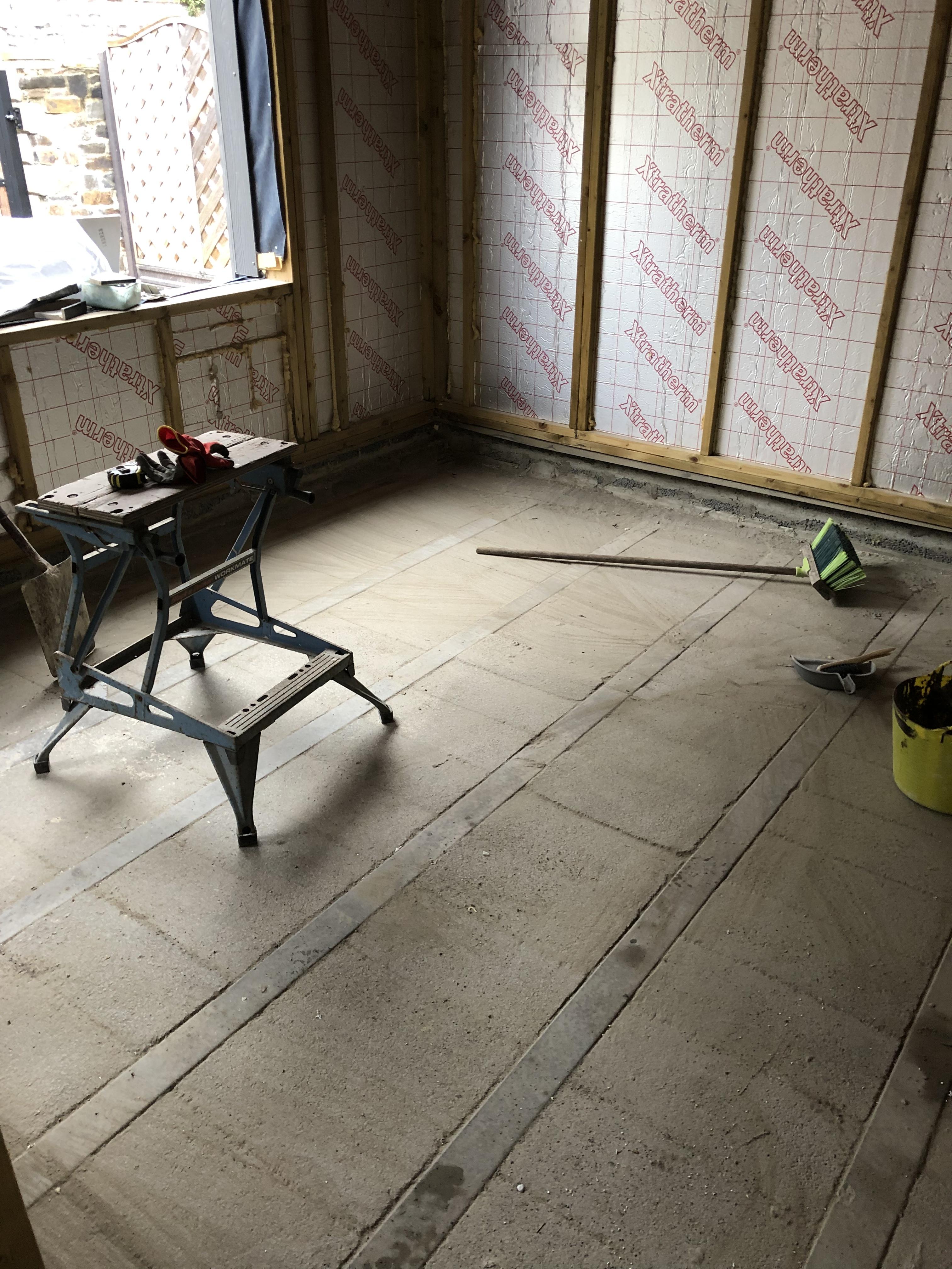

I helped my wife with the sheets of insulation and she did the rest

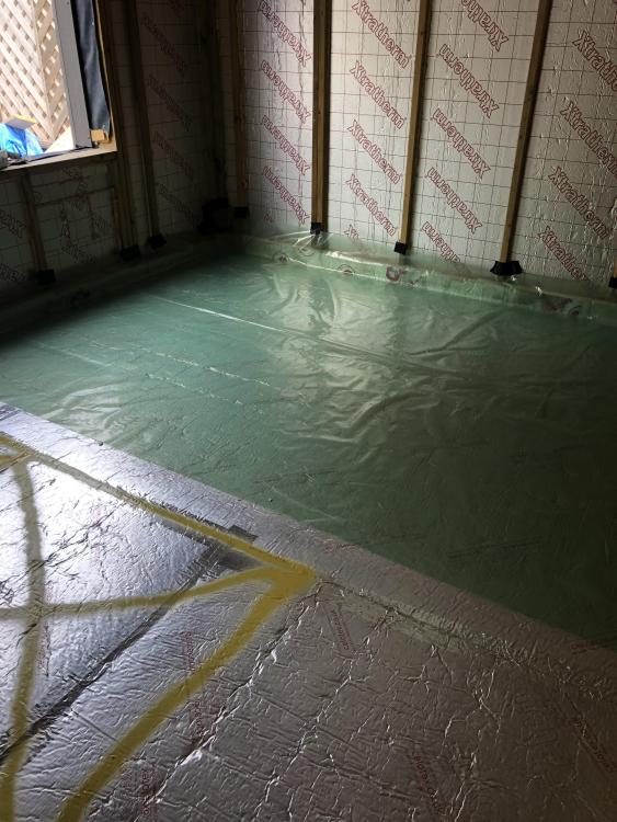

UFH company says for upstairs
"We recommend a heavy duty 500G (polythene gauge) / 125m u (micron thickness) polythene membrane for the vapour barrier, green/clear so that you can see any markings made below."
I'm guessing by "marking below" he means any markings I place on the PIR to show (for example) where I don't want pipework.

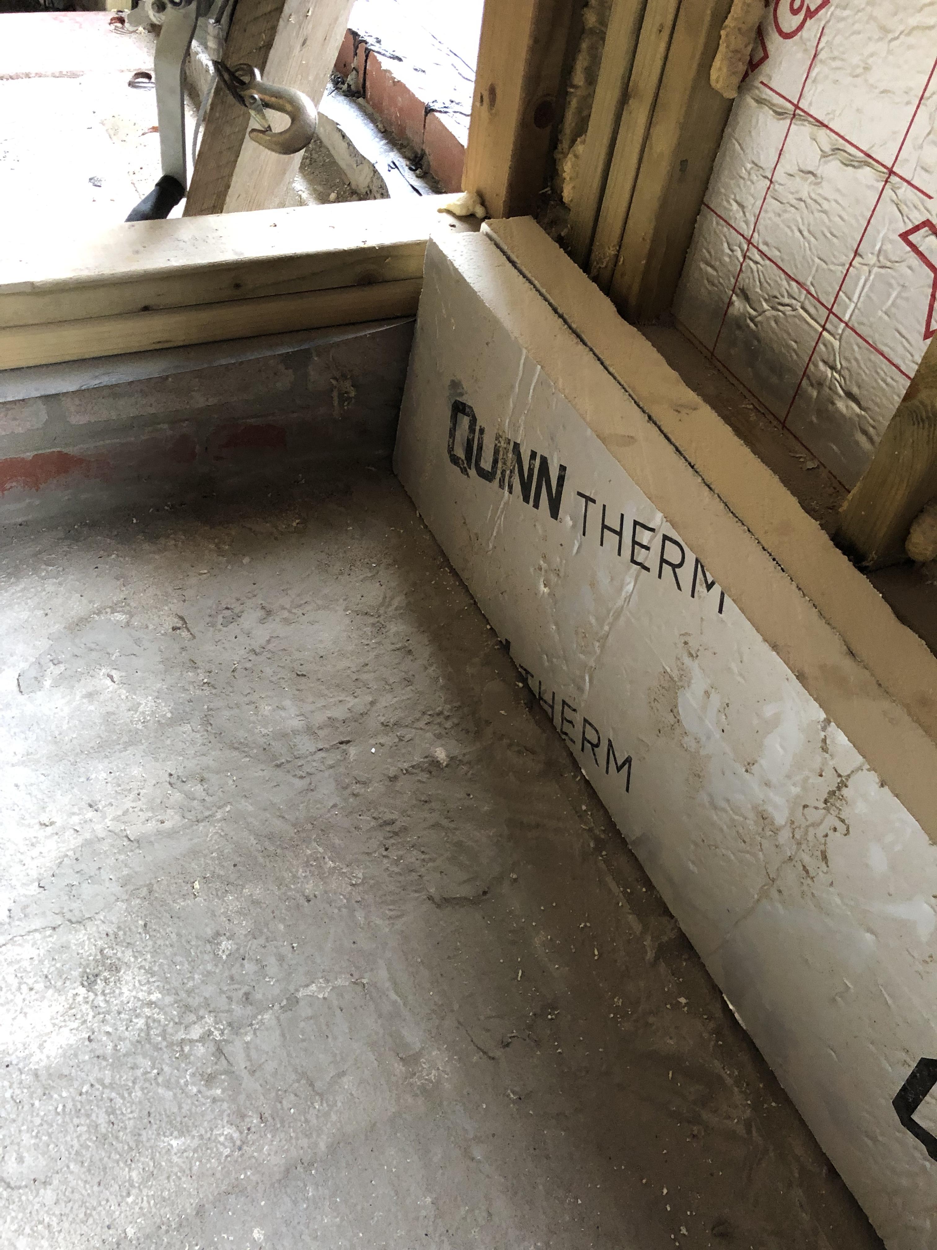

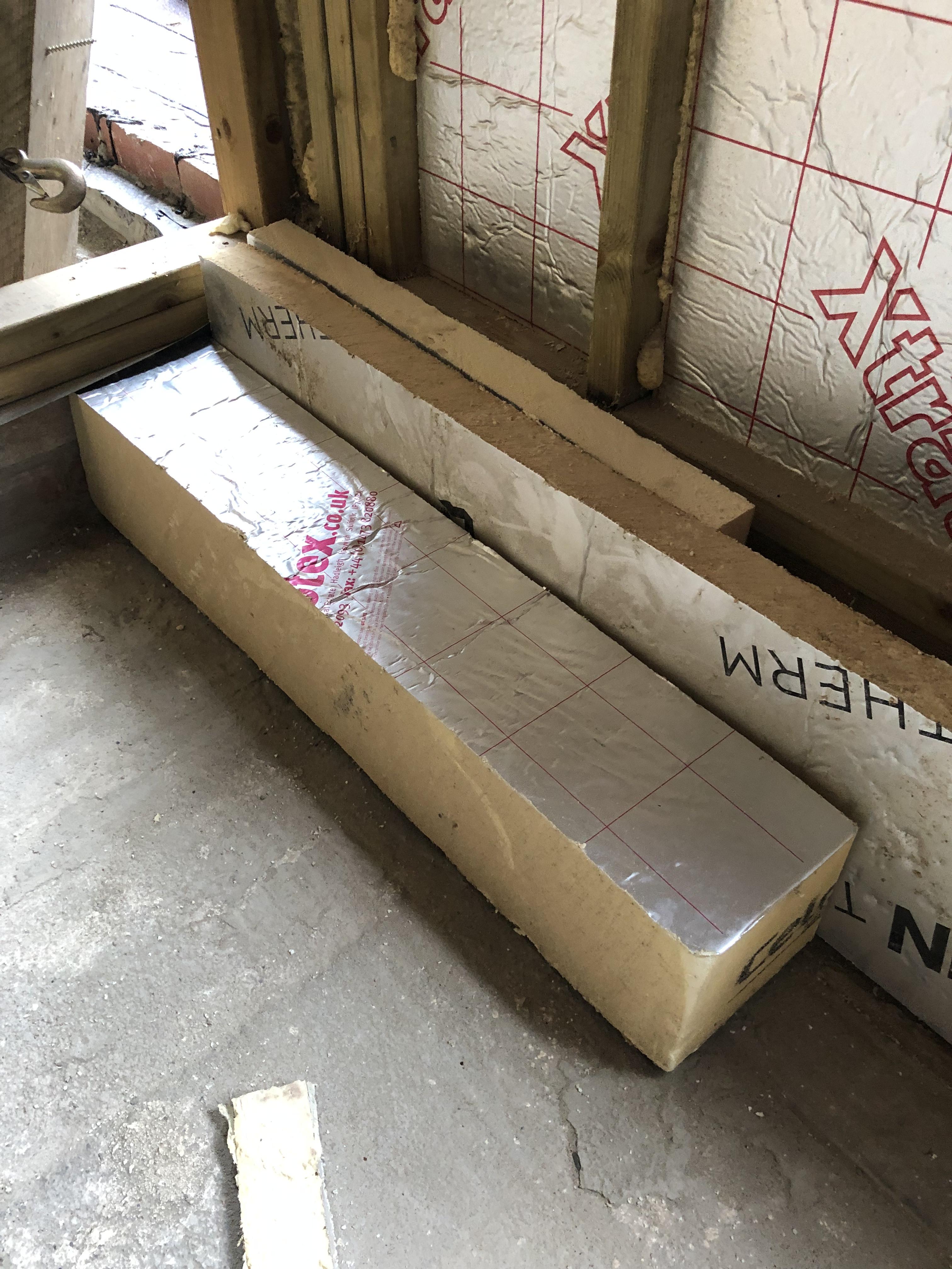

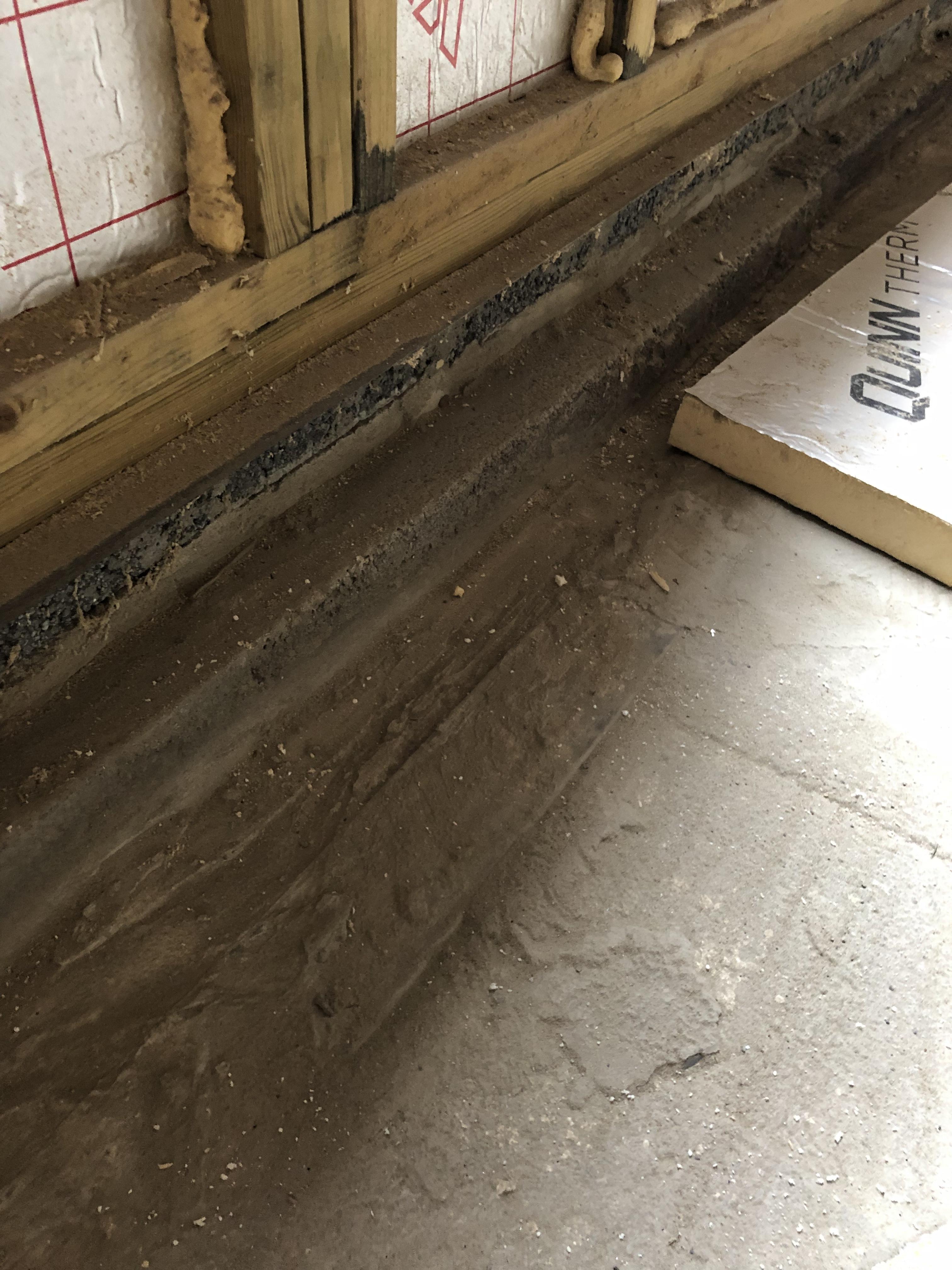

Step in block work at front wall - can’t remember why .
Pack out with pir ; then our upstand in place . Just demo at the moment until someone says it’s wrong . If ok will foam in

Should the upstand be the same height as the floor pir ? I.e in my case 150mm - so it’s all flush ??
