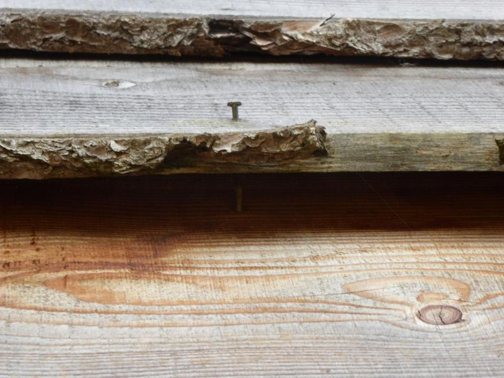

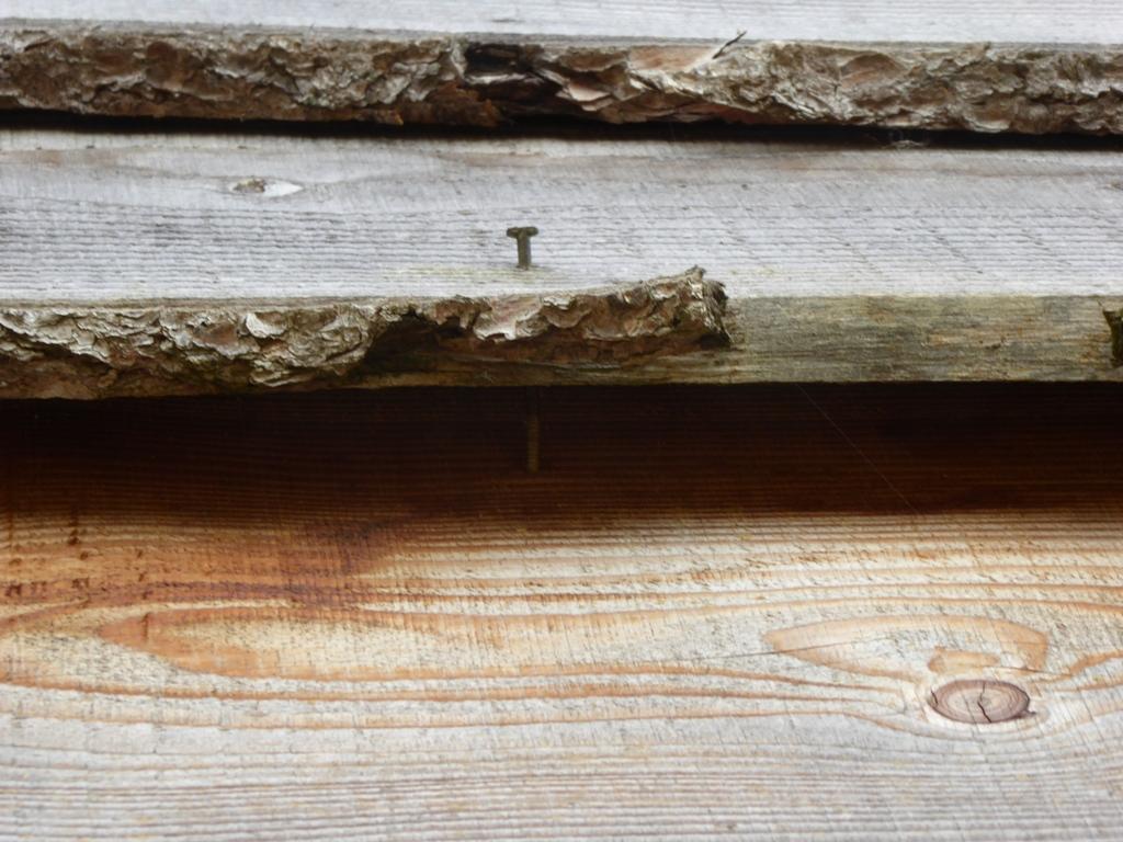

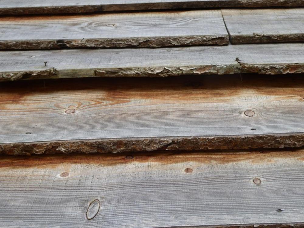

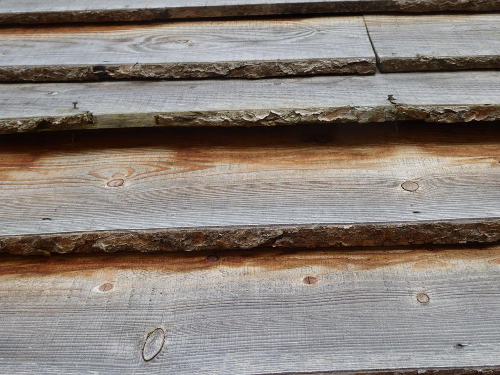

I've been regularly going around our cladding replacing ring shank nails that have been pulling out, just from movement of the wood, with screws.  Here's two more that have worked their way out and need replacing:

Thanks, I'd not heard of these.  The nails we used were galvanised ring shanks from NailFast, not the Paslode ones.  One of the guys had a Paslode gun, the other had an Hitachi, but I can't see any difference in the way the nails are performing between the two (in general the Paslode nails are towards the right hand side of the boards and the Hitachi ones towards the left).
One mistake I made a couple of years ago, was to replace some of the pulled out nails with screws that were both too hard and not that well protected against corrosion (the cheaper Screwfix silver "outdoor" ones).  Several of these screws have broken under tension, again from board movement, and have been replaced with thicker shank screws.
