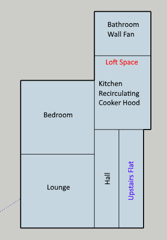

When I think about it then I'm not shocked there is a problem here. Did the refurbishment 8 years ago now so forgot how bad it was. All the windows are double glazed upvc, the walls will be red brick cavity - either no insulation or blown in insulation. The only ventilation is by an extract fan in the bathroom. There is an extract in the kitchen as well... but that's a recirculating one as the hob is on the wall adjoining the next property. She also has a freezer in the bedroom!
This looks a great unit! Thanks for the recommendation. So the unit basically just sucks fresh air in from the loft and heats it if it's below a certain temperature. We could fit that in the access hatch in the kitchen as there is just enough loft space. Where would all this fresh air escape? Do you think it's wise for me to also fit some sliding air vents in the lounge and bedroom as this unit would pressurise the house or do you think there would be enough natural escape?

Just had the surveyor round, a loft kit won't work due to poor layout, it wouldn't really be effective for the rest of the house.
I'm going to replace the bathroom fan with a more powerful one and link it so that it comes on with the light.
Also going to duct in a proper fan in the bathroom and link it with the recirculating cooker hood so that it comes on with that.
Add in an small air vent in the bay window in the lounge.
Under the stairs the surveyor is thinking he can fit a loft PIV system (wall mounted) 200mm vent into the hall which will be inline and will need to core out to the outside. Seems to think the ones designed for flats are nowhere near as good as the loft versions so would rather fit a wall mounted one.

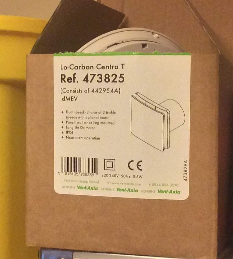

Having observed yesterday only my 2nd occurrence of a T switching off a single room HR Lo Carbon Tempra fan in a number of years (a little thrummy in the setting), I have tipped my policy towards fitting one of these where noise is sensitive eg where it is in the kitchen rather than utility.
It is a similar fan, with a background low setting, and a timed boost wired to the light.
It is a drop in relapcement for a trad "on with the lights") bathroom fan. Cost is reasonable.
