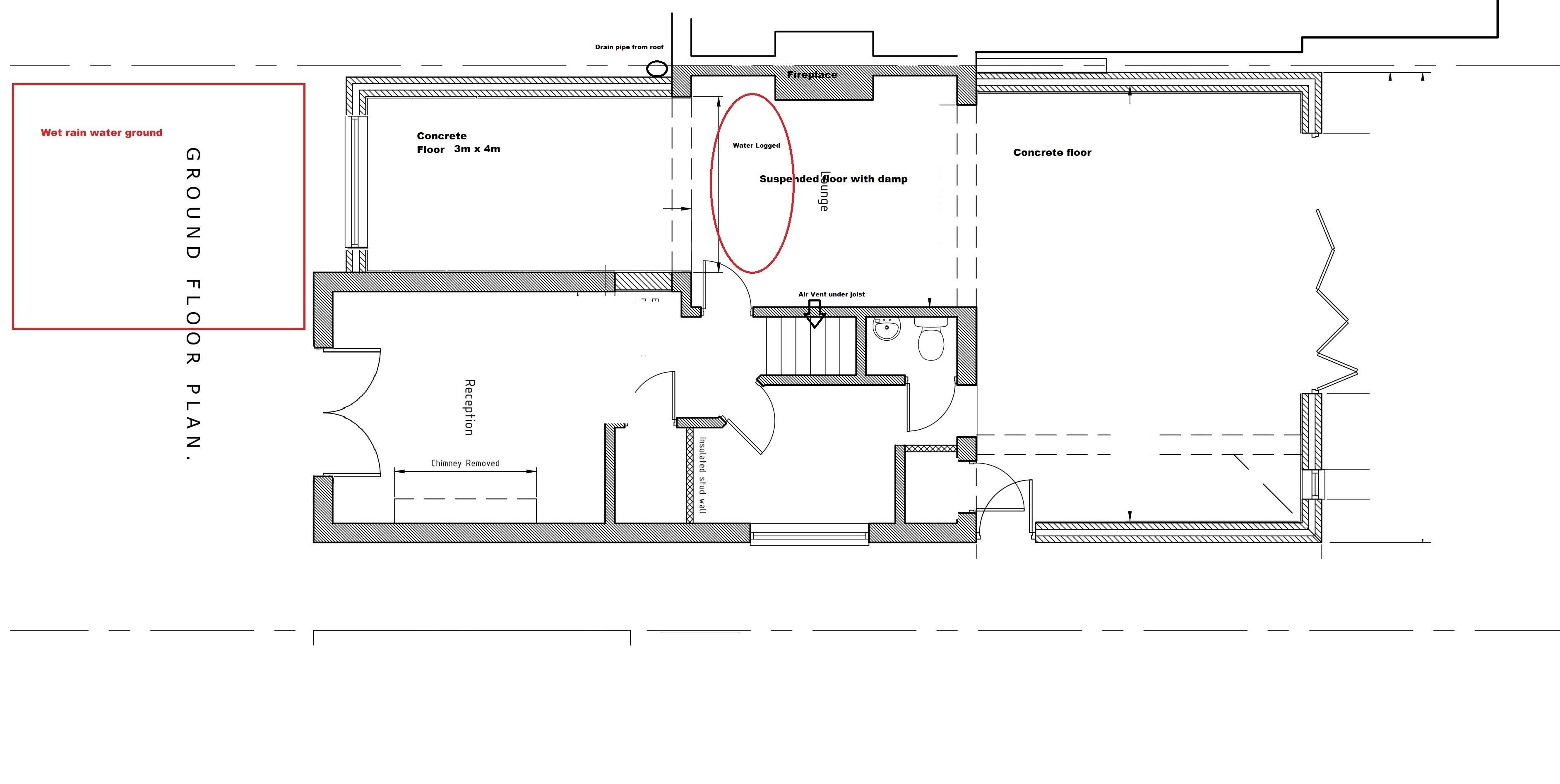

ash132 Posted March 12, 2019 Share Posted March 12, 2019 I’m in the process of renovating my house. I’ve had a rear full length extensions and small front single storey extension to square off the house from the front – it was previously L shaped. In between the two extensions, which have solid concrete floor, I have the existing living room with a suspended floor – I Have had the floorboards up for the last 3 weeks as I’ve been cleaning out the void and insulating between the joists. About 3-4 days ago I noticed some puddles of water on the ground after the heavy rain and then again today. I went to check on the house this morning and the ground looked OK, damp but no puddles. I then came back in the evening and noticed some large puddles of water. I bought a wet vacuum and reckon 7-8 of the 14ltr buckets of water drained out and it was still bad. The ground would literally fill up with water within a few mins of draining it out. I live in a clay area which is prone to water logging. I’ve had land drainage put into the garden and the amount of water running through to the man hole is quite surprising, even when there’s no rain, there’s a steady stream. The front of the house is a bit exposed at the moment - its just ground with no slab or anything and rain water has been forming large puddles where the ground has been taking the weight of the skips. My question is it possible for rain water which is puddling on the drive to make its way under a concrete floor and through to a suspended floor? If not then what is the likely source of the water? Is it possible for that much water to come down a chimney or a faulty drain water pipe? I’m looking to install land drainage on the front but is it worthwhile putting some kind of drainage under the suspended floor before I seal it back up? Any advice would be appreciated. Link to comment Share on other sites More sharing options...

ash132 Posted March 13, 2019 Author Share Posted March 13, 2019 13 hours ago, scottishjohn said: is the drive higher than the underfloor space that is flooding? how much height difference between air bricks and outside ground level --can you see the DPC in the walls outside above the ground level --It must be clear of touching any ground outside must be an old house if that under floor area was not blinded with concrete when built If enough depth to play with then maybe you should drop in a dpc and concrete over that underfloor area keeping that level below the dpc in house wall. 6" is normal height for dpc from outside ground level Yes, I had the drive cleared and some MOT put down before the extension work started. There's probably 2-3 courses of brick between the air brick and ground level Yep, 1930's - still had a back boiler when I bought it! I have thought about it and it would be as a last resort. Now that the house is sealed I’m not keen on having the mess of concrete/ screed barrowed in through the front door. The house is two skinned with cavity. I had a builder around today who could not work out where the water was coming in from. Said he'd never known water to come through a solid concrete floor like I’ve got at the front. Though, there’s a small gap to the side of the front where the drain pipe from the roof is and he reckons the water might be forcing its way through this gap between the foundation and neighbours house through to the suspended floor?! My idea is now is to scrape off a layer of the soil from the front and lay down some DPM, lap it into a land drainage channel and back fill. Hopefully the bulk of any heavy rain then just drains off into the mains... BC have suggested internally, I could use a layer of roof membrane under the joists – allow air up, but stop and water coming through. I’ll see how this works first. Link to comment Share on other sites More sharing options...

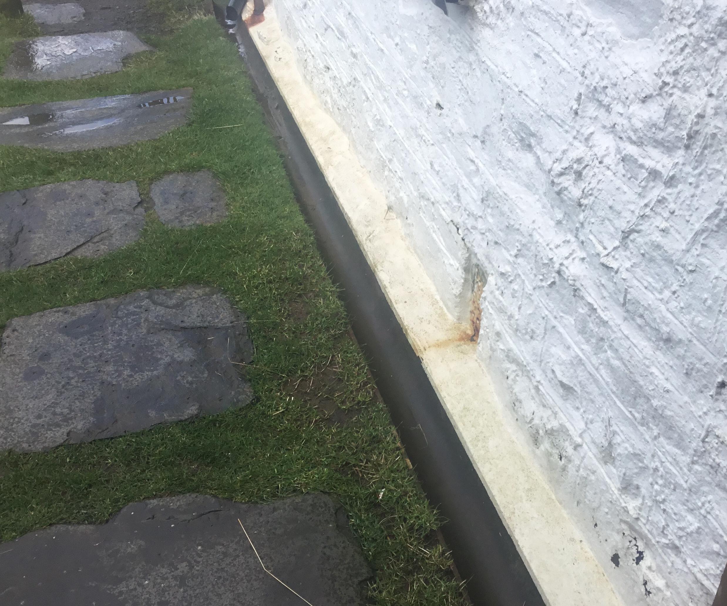

Cpd Posted March 14, 2019 Share Posted March 14, 2019 13 minutes ago, scottishjohn said: he fitted a slot drain,plastic type with removable lids , all round the outside of house and that cured it My living room has a suspended floor below ground level and I was getting water ingress as the house faces directly into the prevailing wind and rain.... huge amounts of water just had nowhere to go quick enough. I extended the base of the house out with an apron and fitted a big old cast gutter pipe and it’s been working really well. Every location will be different but this worked for me, the rusty streak is the air vent. Link to comment Share on other sites More sharing options...
