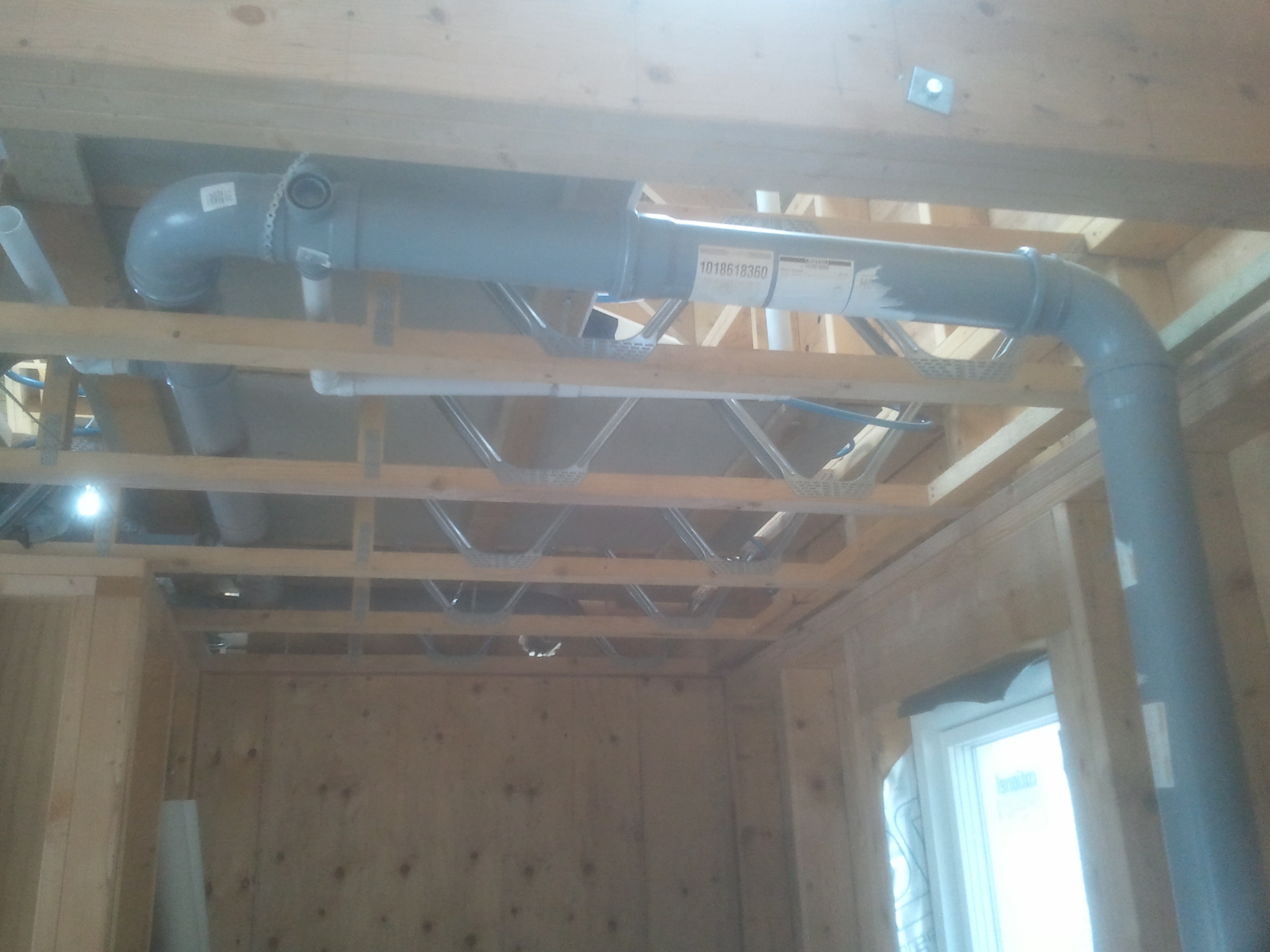

ProDave Posted August 23, 2016 Share Posted August 23, 2016 This is the new build I have been wiring this week. That work of art feeds two bathrooms, so 2 toilets, 2 showers and 2 basins. What you see is under the main bathroom, one 4" branch being for the toilet, the other for the vent pipe. It then passes through a joist at the back of the picture for the en'suite. So by the time it reaches the furthest toilet, that's about 10 metres of pipe with hardly any fall, and 6 90 degree bends. Not a rodding point to be seen!!!!. And how will 2 toilets on the same run work with the vent pipe in the middle? Did I mention this house is being built by a plumber.... Link to comment Share on other sites More sharing options...
tonyshouse Posted August 23, 2016 Share Posted August 23, 2016 Not a plumber, well may be but certainly not a drainage engineer. water flows downhill, simple and very basic, there is even the ammount of fall available, just not used. Link to comment Share on other sites More sharing options...
Nickfromwales Posted August 23, 2016 Share Posted August 23, 2016 The vent can be anywhere. That guys just plumbing it in in the knowledge that it'll work perfectly well just with the flush velocity of the the WC's alone. I've run some near perfectly flat, one for over 5 m's straight, and I'm always surprised at how well they still perform in real life. Agree with Tony, that he's not used the space very well and could have got some basic falls in there with ease. Maybe he'll be doing it again if BCO gets a butchers at it . Is this being checked by BC dave ? Link to comment Share on other sites More sharing options...
Barney12 Posted August 24, 2016 Share Posted August 24, 2016 Giving him the benefit of the doubt perhaps he intends to pop a bit a 4x2 under the pipe at the far end before he's completely finished. Thus creating a gentle fall? Out of interest are rodding eyes as essential as they once were now there are high pressure air/water clearing systems? Or do you sometimes still need to poke the poo with a stick? Link to comment Share on other sites More sharing options...
ProDave Posted August 24, 2016 Author Share Posted August 24, 2016 8 hours ago, Nickfromwales said: The vent can be anywhere. That guys just plumbing it in in the knowledge that it'll work perfectly well just with the flush velocity of the the WC's alone. I've run some near perfectly flat, one for over 5 m's straight, and I'm always surprised at how well they still perform in real life. Agree with Tony, that he's not used the space very well and could have got some basic falls in there with ease. Maybe he'll be doing it again if BCO gets a butchers at it . Is this being checked by BC dave ? Yes, but I doubt they will be doing a visual. On my own build the last BC inspection was when they checked the completed timber frame. I asked what was the next inspection they wanted to make and they said "completion" About the only thing they are ionterested in with drainage is a pressure test. Link to comment Share on other sites More sharing options...
Ferdinand Posted August 24, 2016 Share Posted August 24, 2016 4 hours ago, Barney12 said: Giving him the benefit of the doubt perhaps he intends to pop a bit a 4x2 under the pipe at the far end before he's completely finished. Thus creating a gentle fall? Out of interest are rodding eyes as essential as they once were now there are high pressure air/water clearing systems? Or do you sometimes still need to poke the poo with a stick? Insurance policy? I'd hate to find I needed them 15 years later for some reason. Link to comment Share on other sites More sharing options...
tonyshouse Posted August 24, 2016 Share Posted August 24, 2016 A problem would show up quite soon unless someone puts a chunk of 4x2 under one end and then the pipe could take years to sag and deform. Link to comment Share on other sites More sharing options...
