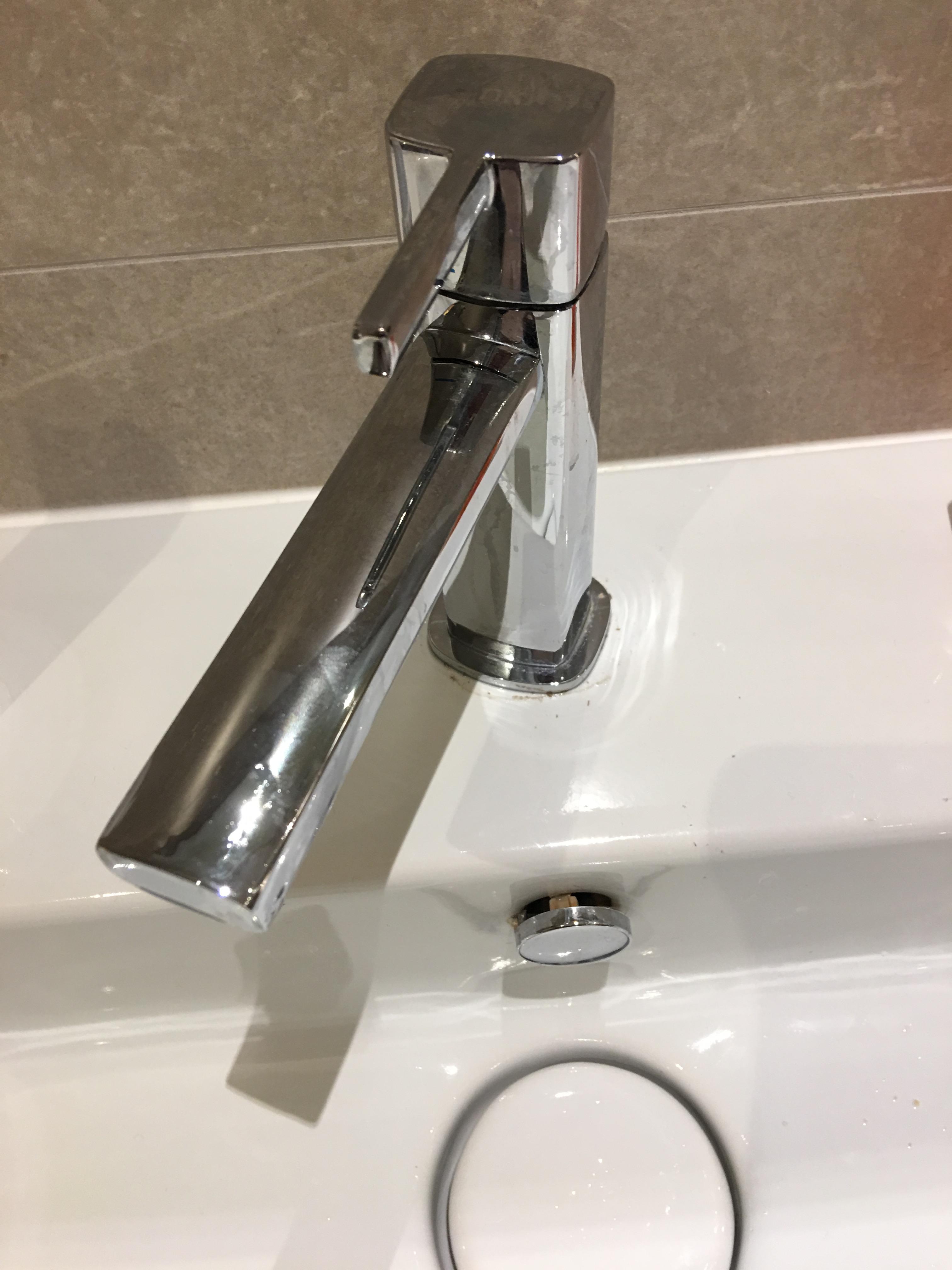

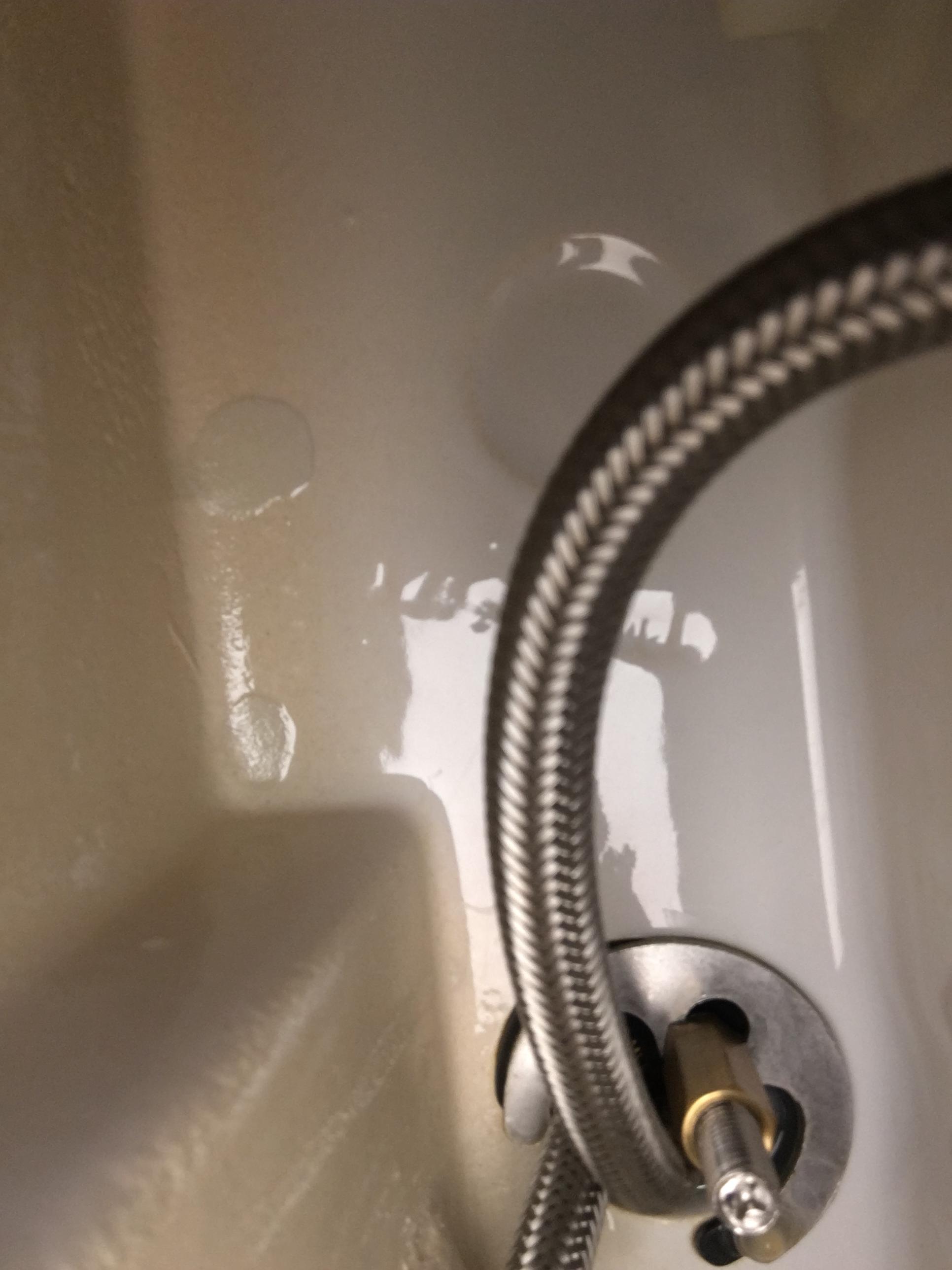

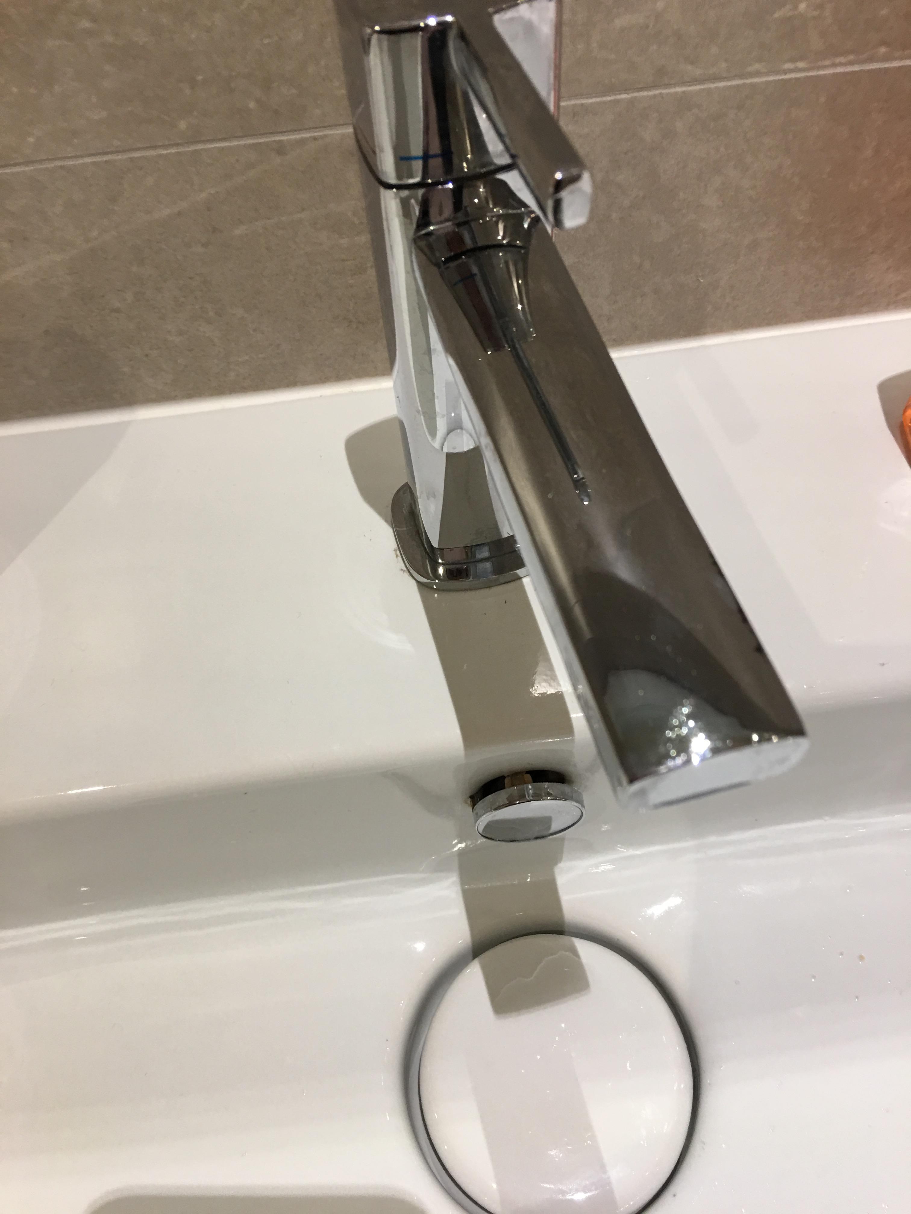

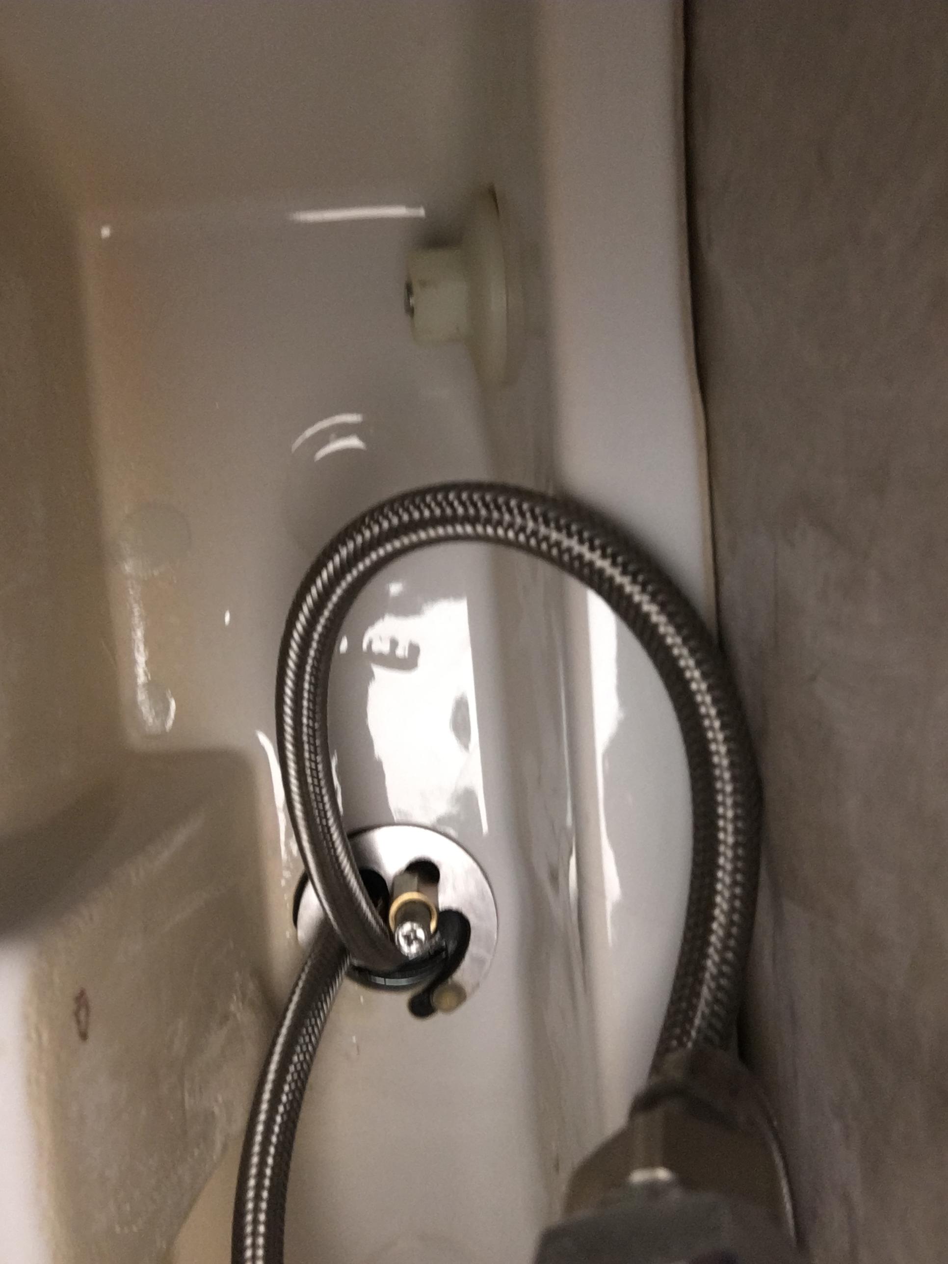

lizzie Posted February 22, 2019 Share Posted February 22, 2019 The basin tap in my wetroom was always a bit 'loose' now it is doing quarter turn when used. The top bit - the pillar - is moving. I have taken a photo of underneath - its really difficult to get at. Is there something I can do to solve this or do I need a plumber? I have no tools beyond usual screwdrivers and pliers and not much use of hands so hoping any solution will be easier than leaking shower screen......got to have another go at that when I get the energy LOL Thanks for any advice you can give. Link to comment Share on other sites More sharing options...
PeterW Posted February 22, 2019 Share Posted February 22, 2019 That’s a 10mm brass nut on a standard stem. Long reach socket is best, or a 10mm spanner. Depending on where it’s from though, it may be nearer 11mm as tolerances aren’t good on those if they came from overseas..! Brass bit needs nipping up to tighten the tap in place but don’t go mad ..! Link to comment Share on other sites More sharing options...
lizzie Posted February 22, 2019 Author Share Posted February 22, 2019 Just now, PeterW said: That’s a 10mm brass nut on a standard stem. Long reach socket is best, or a 10mm spanner. Depending on where it’s from though, it may be nearer 11mm as tolerances aren’t good on those if they came from overseas..! Brass bit needs nipping up to tighten the tap in place but don’t go mad ..! Is a long reach socket a spanner? I dont have any spanners maybe I should buy some! It's a Porcelanosa fitting made in Spain. Link to comment Share on other sites More sharing options...
AliG Posted February 22, 2019 Share Posted February 22, 2019 Here is the installation manual. http://www.noken.com/recursos/pdf/idm/files/100130995_IDM.pdf But yes a long socket pushed up over it should be exactly what you need. You'll never get up there with a spanner. Link to comment Share on other sites More sharing options...

PeterW Posted February 22, 2019 Share Posted February 22, 2019 6 minutes ago, lizzie said: got a dribble of water run done my fingers though, hope thats not a bad sign. It possibly is ... was there any water on the top of the sink when you did this ..?? If there is water under there it could be coming from one of the tap flexi tails that is not done up tight ... do not over tighten these as they have O Rings in them..! Link to comment Share on other sites More sharing options...
AliG Posted February 22, 2019 Share Posted February 22, 2019 In the old place we had a corroded waste in a basin. It was a pedestal basin. I suspect that they put in the basin, connected up the fittings then put the pedestal in. Then we tiled around the base of the pedestal. I couldn't see any way to change the waste, so I just gave up and built a new house. 1 Link to comment Share on other sites More sharing options...
lizzie Posted February 22, 2019 Author Share Posted February 22, 2019 3 minutes ago, PeterW said: It possibly is ... was there any water on the top of the sink when you did this ..?? If there is water under there it could be coming from one of the tap flexi tails that is not done up tight ... do not over tighten these as they have O Rings in them..! No water on top it came from underneath as I was trying to turn the nut with fingers and holding pillar steady with other hand per Pro Dave method....................I thought I felt water on the flexi pipe when I first started looking at it but ignored it. So next question is how do I tighten those tails - not with monobloc spanner I guess. My water system alerts me to a micro leak regularly and I have driven myself nuts trying to find it, could this be it I wonder. Iceberg looming I fear! Link to comment Share on other sites More sharing options...
Jeremy Harris Posted February 22, 2019 Share Posted February 22, 2019 The tails are only done up hand-tight, usually, so maybe one has loosened slightly? To tighten it may mean slacking off the pipe fitting where it attaches, in order to make it free to turn without twisting the flexible pipe. Link to comment Share on other sites More sharing options...
