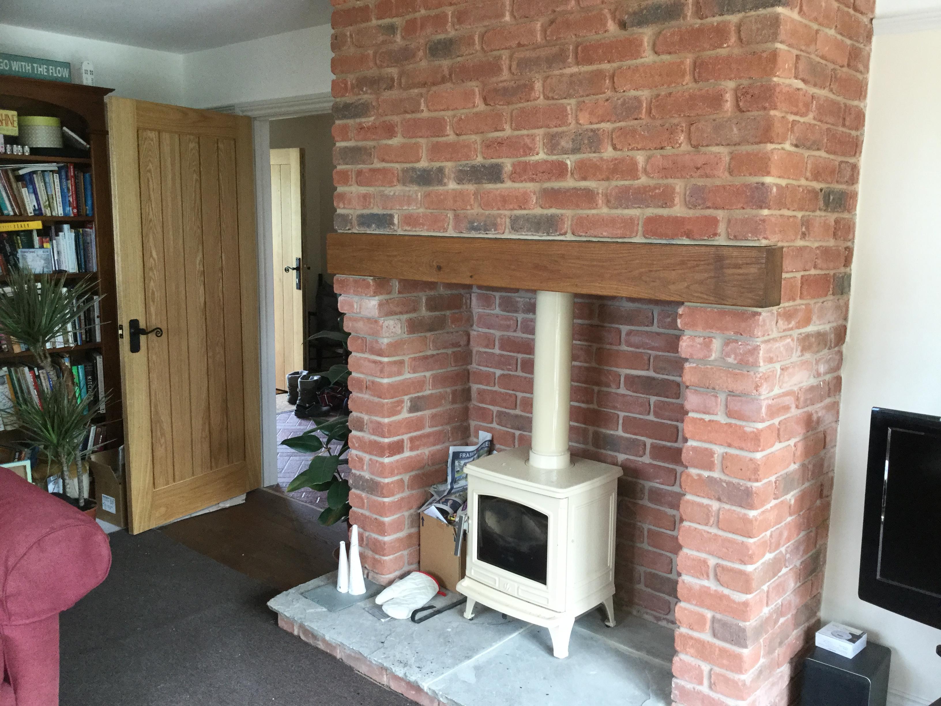

joe90 Posted February 12, 2019 Posted February 12, 2019 (edited) I was also told a WBS was a definite requirement and it’s great, we were told we would overheat (impossible for my missus ?) but a couple of hours and the room gets up to about 28 (toasty), doors open and it has migrated through the house. What is interesting is even by the following morning the lounge is still at about 24, and the UFH has not kicked in all night. I think the brickwork around it acts like a heat store. (Intentional) Edited February 12, 2019 by joe90
Declan52 Posted February 12, 2019 Posted February 12, 2019 30 minutes ago, joe90 said: I was also told a WBS was a definite requirement and it’s great, we were told we would overheat (impossible for my missus ?) but a couple of hours and the room gets up to about 28 (toasty), doors open and it has migrated through the house. What is interesting is even by the following morning the lounge is still at about 24, and the UFH has not kicked in all night. I think the brickwork around it acts like a heat store. (Intentional) Im the exact same. Fire it up and let it heat the house for 2-3 days depending on how cold it is outside. A lazy Sunday with the stove flickering away is hard to beat. 1
