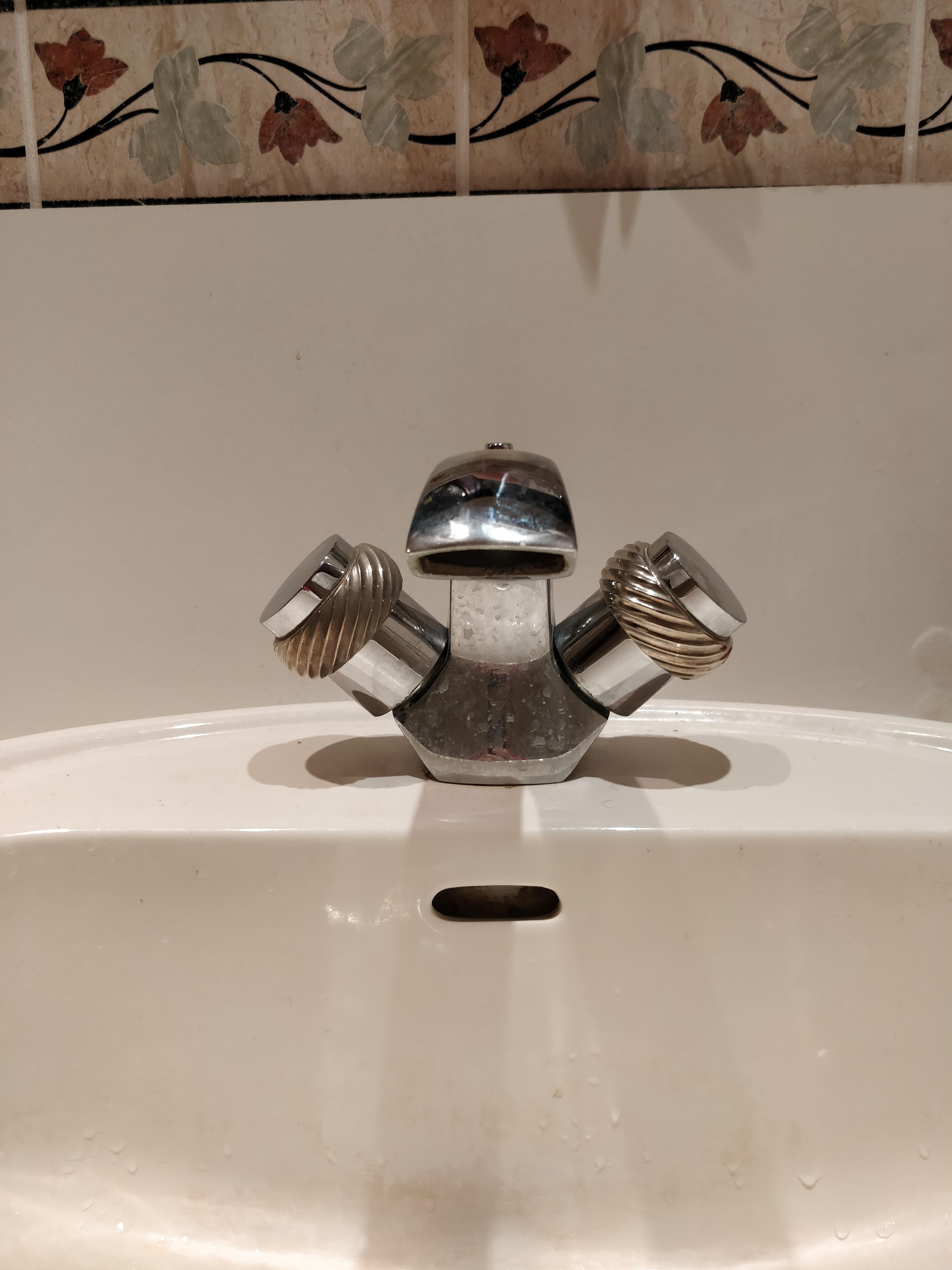

Nickfromwales Posted February 12, 2019 Posted February 12, 2019 Ok so this is gravity fed not mains. With the hot water running, put your hand tight over the end of the spout so the palm of your hand stops the water coming out of the spout. Then turn the cold tap on ( that will be at mains pressure ) and slowly force cold back up the hot pipe. It sounds like an airlock so back off with the chainsaw just yet
Nickfromwales Posted February 12, 2019 Posted February 12, 2019 Any chance of a pic of the spout first? Just to confirm that method will work.
vfrdave Posted February 12, 2019 Author Posted February 12, 2019 This is it @Nickfromwales in all its glory.
Nickfromwales Posted February 12, 2019 Posted February 12, 2019 Just now, vfrdave said: This is it @Nickfromwales in all its glory. Tidy, cheers. As that's a basin the cold may also be gravity fed. Do as I said and try to force cold back up the hot, and if that doesn't work ( after a max of 30 seconds of 'reversed flow' ) then the issue may well be a cream-crackered tap. Does this match the bath taps? If so you'll need to get the cartridge out and get new replacements or you'll have to change both.
vfrdave Posted February 18, 2019 Author Posted February 18, 2019 On 12/02/2019 at 23:10, Nickfromwales said: Do as I said and try to force cold back up the hot Thanks @Nickfromwales that appears to have helped, though I did manage to spray myself and the bathroom with water trying to create a seal with my hand against the tap.
Nickfromwales Posted February 18, 2019 Posted February 18, 2019 8 hours ago, vfrdave said: Thanks @Nickfromwales that appears to have helped, though I did manage to spray myself and the bathroom with water trying to create a seal with my hand against the tap. Prob just an airlock then, or a mixture of that plus semi-knackered tap.

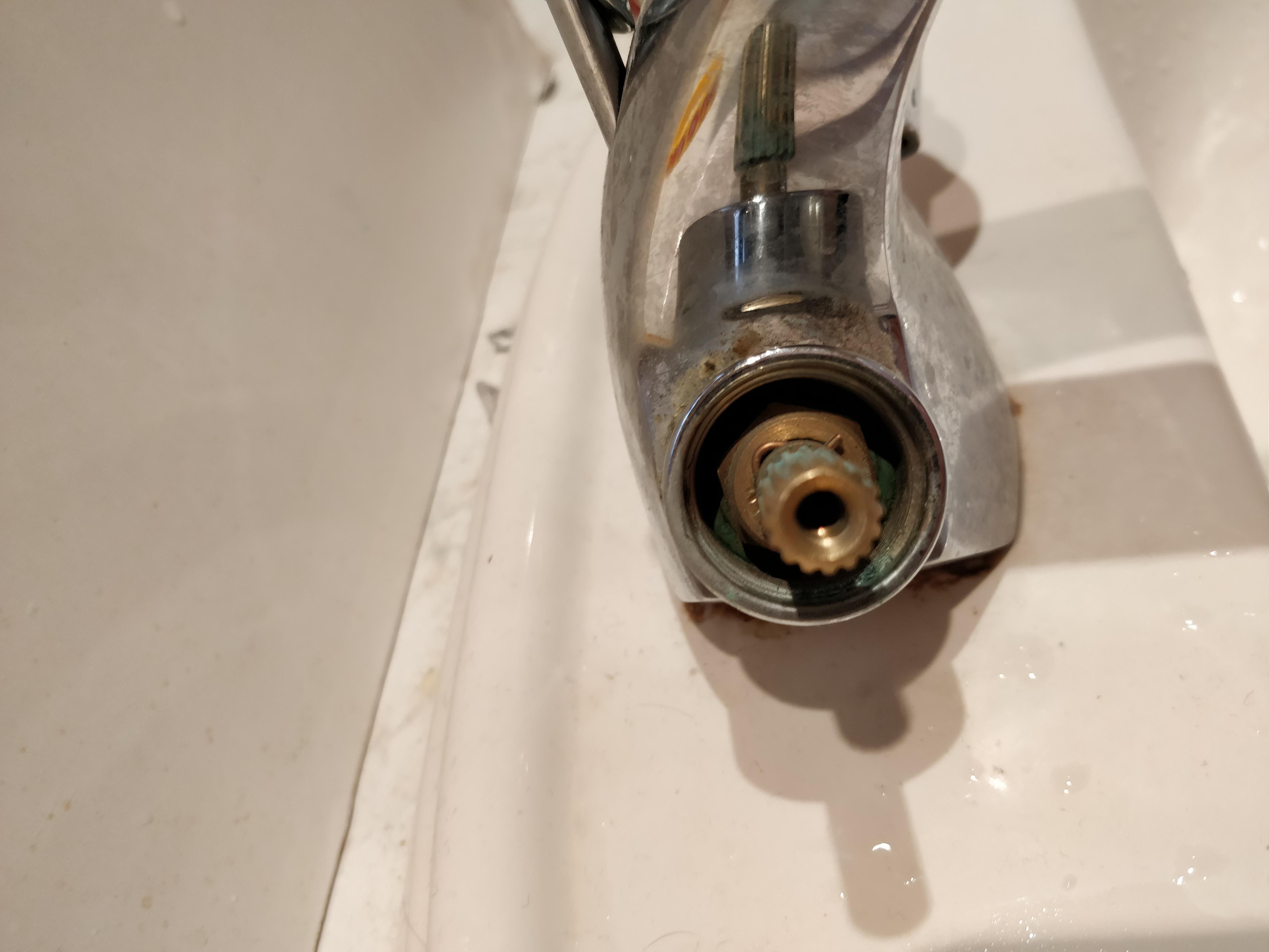

vfrdave Posted April 13, 2019 Author Posted April 13, 2019 So just another update, this has still been an issue and we are persevering with it. Tonight I stripped the tap and the rubber stopper on the end of the cartridge isn't in great shape. Put it back together and tap working alot better but reckon the cartridge rubber washer thing, what's it called, needs replacing.
vfrdave Posted April 14, 2019 Author Posted April 14, 2019 Anyone know where I can get a 16 spline cartridge? Or can I get a 20 and do a mix and match with the old one to suit. Existing one working much better but now not sealing off fully leaving a constant dribble of hot water.
dpmiller Posted April 14, 2019 Posted April 14, 2019 Any good? https://www.notjusttaps.co.uk/spares-valve-sth-16-teeth.html
vfrdave Posted April 14, 2019 Author Posted April 14, 2019 1 hour ago, dpmiller said: Any good? https://www.notjusttaps.co.uk/spares-valve-sth-16-teeth.html Thanks might try a replacement washer from there first.
