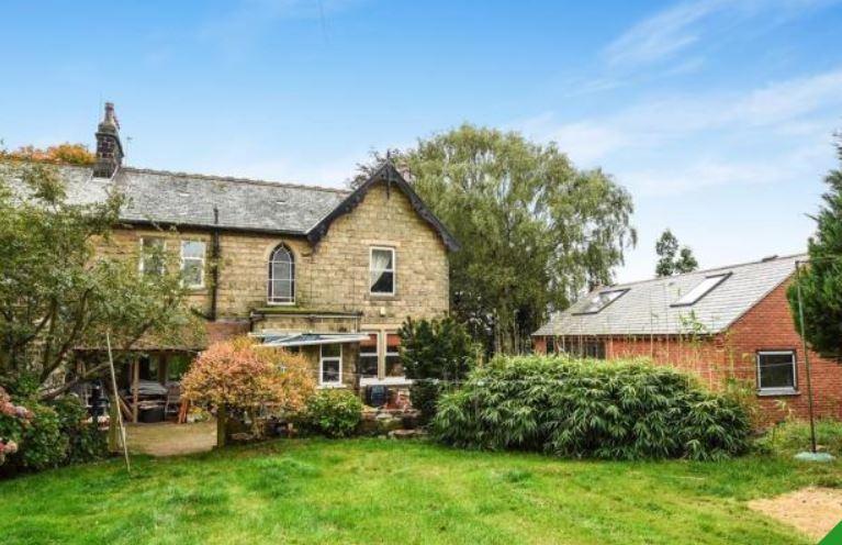

RenoNewb Posted February 11, 2019 Share Posted February 11, 2019 Hi Everyone Sorry, I am new - hope it's ok to dive right in with questions! I am pretty sure I'll be on this site ALOT over the next few years. So we have bought a house (period, 1898 & needs full renovation eeeek) with an unfinished 2 bedroomed detached Annexe. It's about 3-4 meters away from the back of the house, it has been built and has a roof on it, all windows and doors are in and all the steel beams are in place. Approx 10m by 5.8m. We got our first quote back to finish it off, as below. I would love some opinions on this quote. We are in North Yorkshire. *Set up site with WC facilities and skip. *Install new drains. *Bring new services in from existing house. Water, gas and electric. *Insulate and screed floors. *Build stud walls to create new layouts. *1st fix plumbing for new bathroom, boiler and radiators. *1st fix electrics and joinery. * Insulate all areas as necessary. * Plaster board and skim * 2nd fix joinery. New skirting, architrave and doors. * Install new kitchen. Kitchen supplied by client. * 2nd fix plumbing. All sanitary ware supplied by client. *Supply and fit new Combi boiler. * Supply and fit 4 new radiators. * 2nd fix electrics. We have allowed for 1 consumer unit, 16 double sockets, 4 switchesand 18 LED spot lights. All detectors to be hard wired. *Supply and fit new uPVC fascia’s and guttering. * Make good to ground externally. * Clean down. * Remove all debris from site. £39, 660 + VAT £47, 592 Any thoughts on this would be great. Our plan is to move into this Annexe whilst we get the main house renovated, but really didn't think it would cost that much? Thank you for any help. Link to comment Share on other sites More sharing options...

RenoNewb Posted February 11, 2019 Author Share Posted February 11, 2019 6 minutes ago, Tennentslager said: Some pictures of the existing structure will help the good folks get a handle on what you need and what you might be able to save on. the more info the better is best??? and welcome to the forum Thank you...good idea! I don't have many of the actual Annexe, just this one looking from the back garden. It's on the right. Built in red brick. Building work stopped around 18 months ago. Link to comment Share on other sites More sharing options...
Ferdinand Posted February 11, 2019 Share Posted February 11, 2019 (edited) 45 minutes ago, RenoNewb said: Thank you...good idea! I don't have many of the actual Annexe, just this one looking from the back garden. It's on the right. Built in red brick. Building work stopped around 18 months ago. Welcome @RenoNewb We also really need an indication of what standard finishes you have specified (basic, normal, posh - eg for doors eggcrate, wood veneer, solid wood), and a sketch plan if you have one. Your quote does not seem to include a ventilation system, or floor finishes above the screed eg tiles. For the whole thing, fitting OK quality tiles (£10-£20 per sqm) throughout on your screed would add £2-2.5k-ish. My initial impression is that the quote is basically OK for a main contractor package which is that comprehensive, where you have given them the risk, and there is about 6-7k of work outside the annexe included, and they have to allow for things going wrong. I think you could salami slice perhaps 5-10%, but if you want to knock it down by say 25% you will need to take a more personal detailed interest and accept some of the risk back. Expect to spend 100-200 hours of your time on resourcing it in this case, and doing things like sourcing and rubbish disposal. Much of the saving would be in you ferreting out stuff less expensively that they just buy in as there is no incentive for them to work at saving a few £££ here and there in a fixed price. Obvs your other quotes will be key docs to compare. What are the odds that the next one is £57k ? Looks a great place to be. Ferdinand Edited February 11, 2019 by Ferdinand Link to comment Share on other sites More sharing options...
