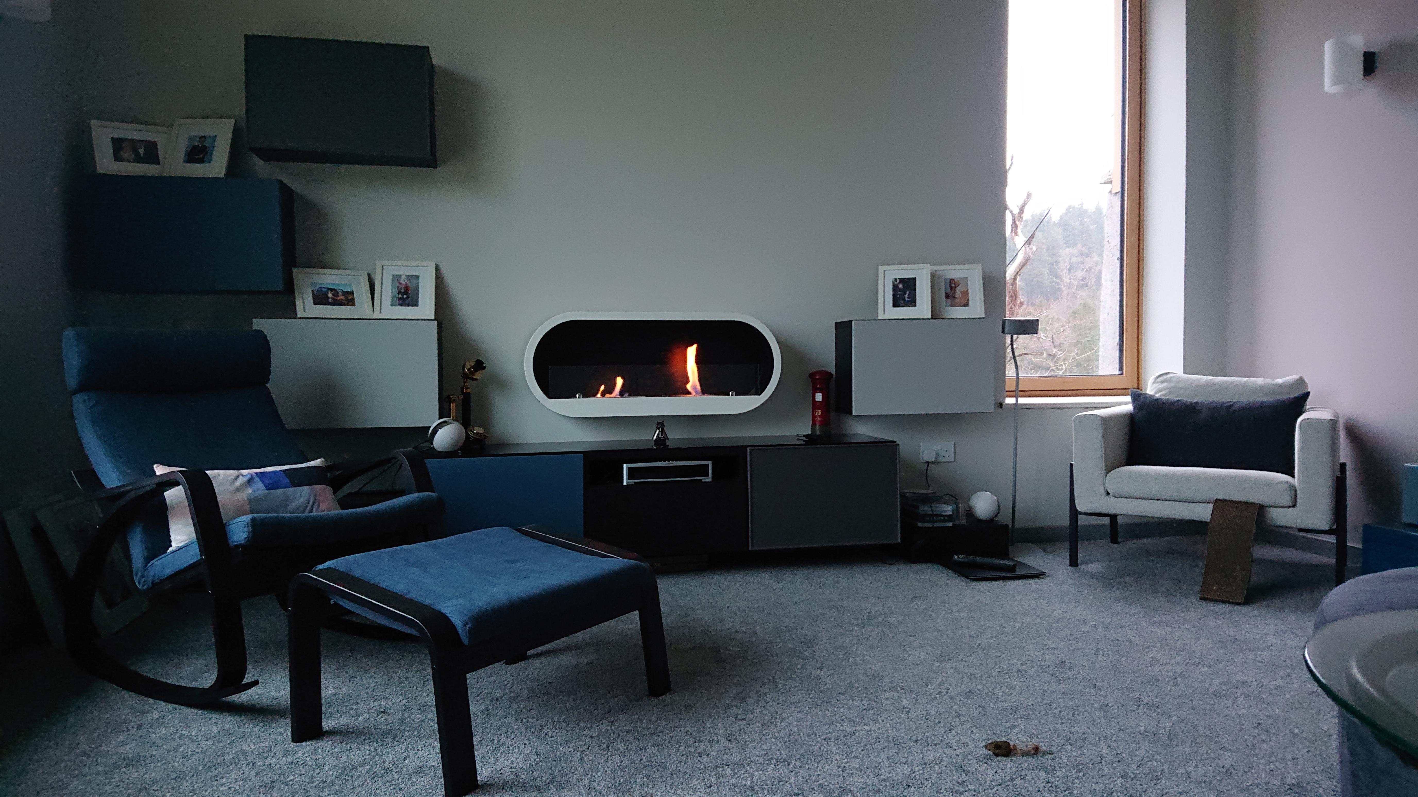

jamiehamy Posted February 4, 2019 Share Posted February 4, 2019 We had wbs in our plans but didn't bother for various reasons. Got this before Christmas and love it. Kicks out a decent heat and each side will last 6 hours. Ours has a double burner, we normally put in half a litre in each side after dinner and it lasts until 10. Lovely to look at and decent heat for the whe front of the house. We don't really need the heat but it is nice having super cosy on a cold night. 1 1 Link to comment Share on other sites More sharing options...

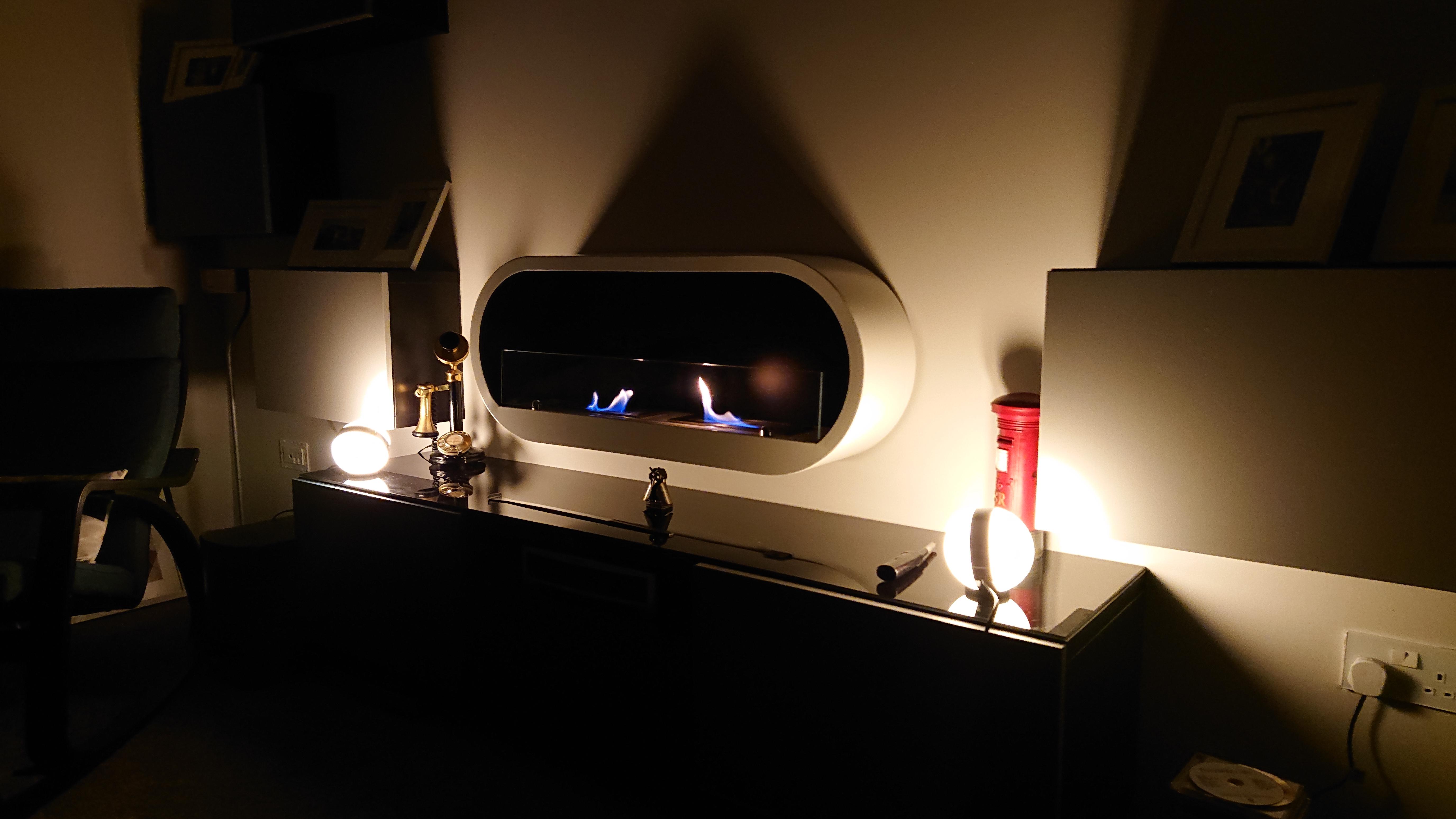

jamiehamy Posted February 4, 2019 Share Posted February 4, 2019 By day. 1 Link to comment Share on other sites More sharing options...

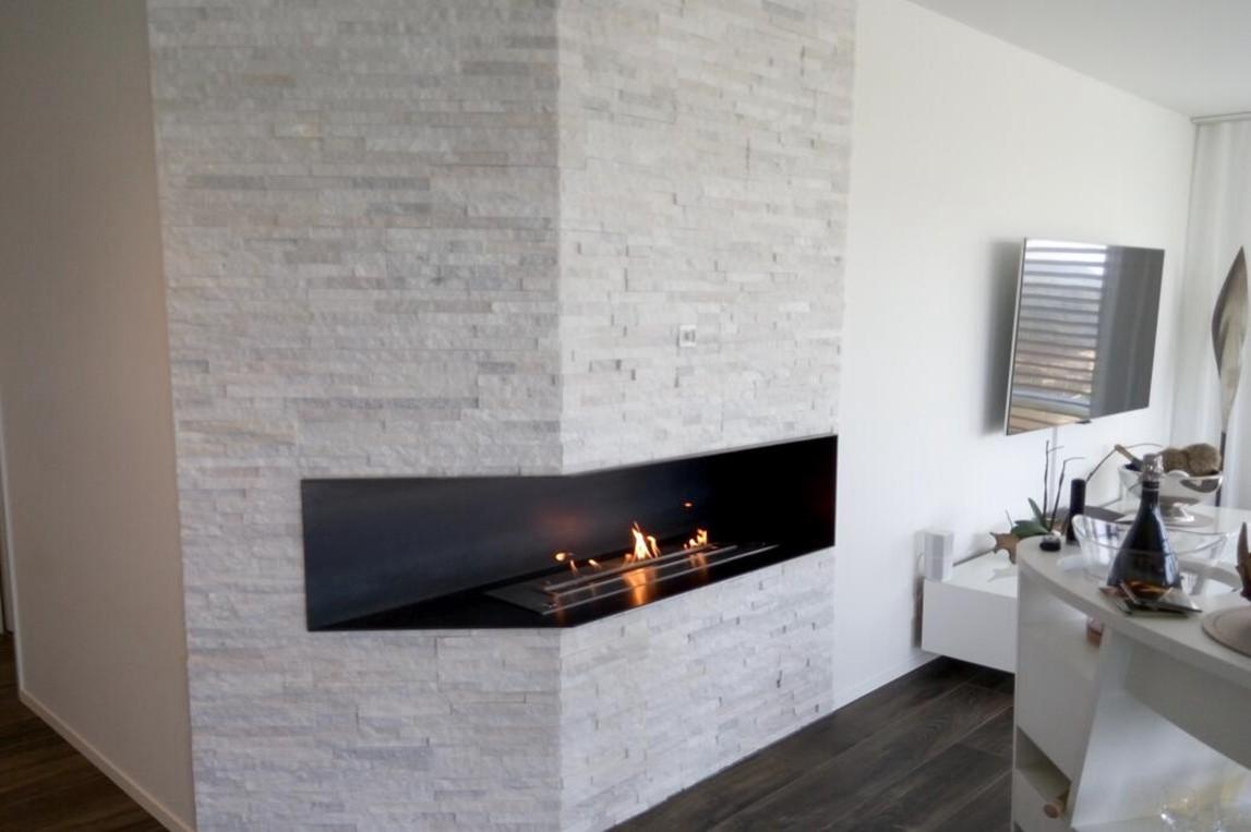

EverHopefull Posted February 4, 2019 Author Share Posted February 4, 2019 My plan was for something like this or actually to divide the lounge and dining areas. Link to comment Share on other sites More sharing options...
