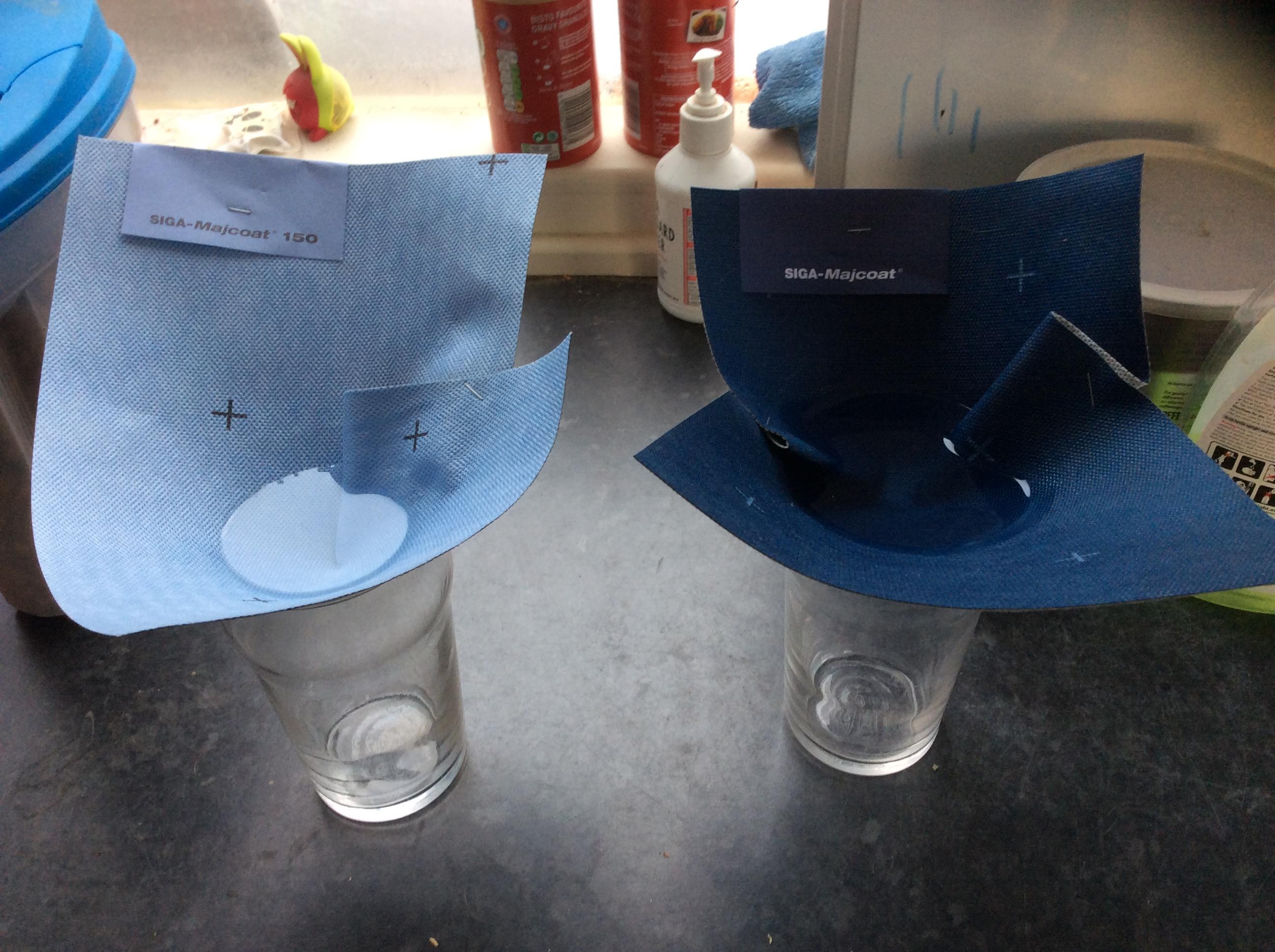

So the snow turned up, and being a soft southern sod I needed to find something to do that didn’t involve going outside. AD2305FE-7F3D-469C-AE25-3FE9C473A466.thumb.jpeg.b32356b16666e3d2a3c5bdc6da9f8d8c.jpeg
So 72 hours later there’s not a drop of water passed through either of these roof membranes.
How else do I decide which one to use, both from the same manufacturer, difference in price between the two is roughly £300.

The manufacturer says Majcoat can be exposed for upto 8 weeks while Majcoat 150 can only be exposed for upto 4 weeks.........so
https://www.siga.swiss/global_en/catalog/majcoat

Look at your cost-to-completion spreadsheet.
Put both numbers in. Decide whether the cost difference makes any material (sorry) difference.

Jet the hose at each of them, I did a lot of our walls with TF200 only to realise if the rain was driving it went right through but held water like your test no problem. I contacted the manufacturer who tested a swatch and confirmed it was as it should be and fit for purpose. I disagreed and replaced the lot with  a W1 class roofing membrane from Cromar which doesn't let a drop in.  Appreciate your membranes are roofing class but might be worth posting for others.

on the roof after a recommendation on here and was really impressed with it. Roofs require a W1 class membrane which is basically how much water is allowed through. The TF200 I used was a W2 product which passes building regs on walls but as explained in driving rain water was getting through which I didn't like and which could be replicated with a surprisingly low jet from a hose. I appreciate that once cladding etc is on the walls won't have anywhere like the same exposure as they do during the build but I didn't like seeing droplets form on the inside where I had window openings and wet OSB behind!

JET HOSE !! that would be equivalent to a class 7 hurricane or worse --suspect you blew holes in or surface was badly rubbed
what was over the top of this membrane ?
left open to UV for too long before it was clad?  not meant to be subjected to direct sunlight  or it degrades
if atmospheric pressure is 14,7 psi --then even 2 bar from garden hose is higher pressure than you will ever see
a jet wash will be 10-15 bar -- or at the bottom of sea 100 metres down
so hardly a fair test
