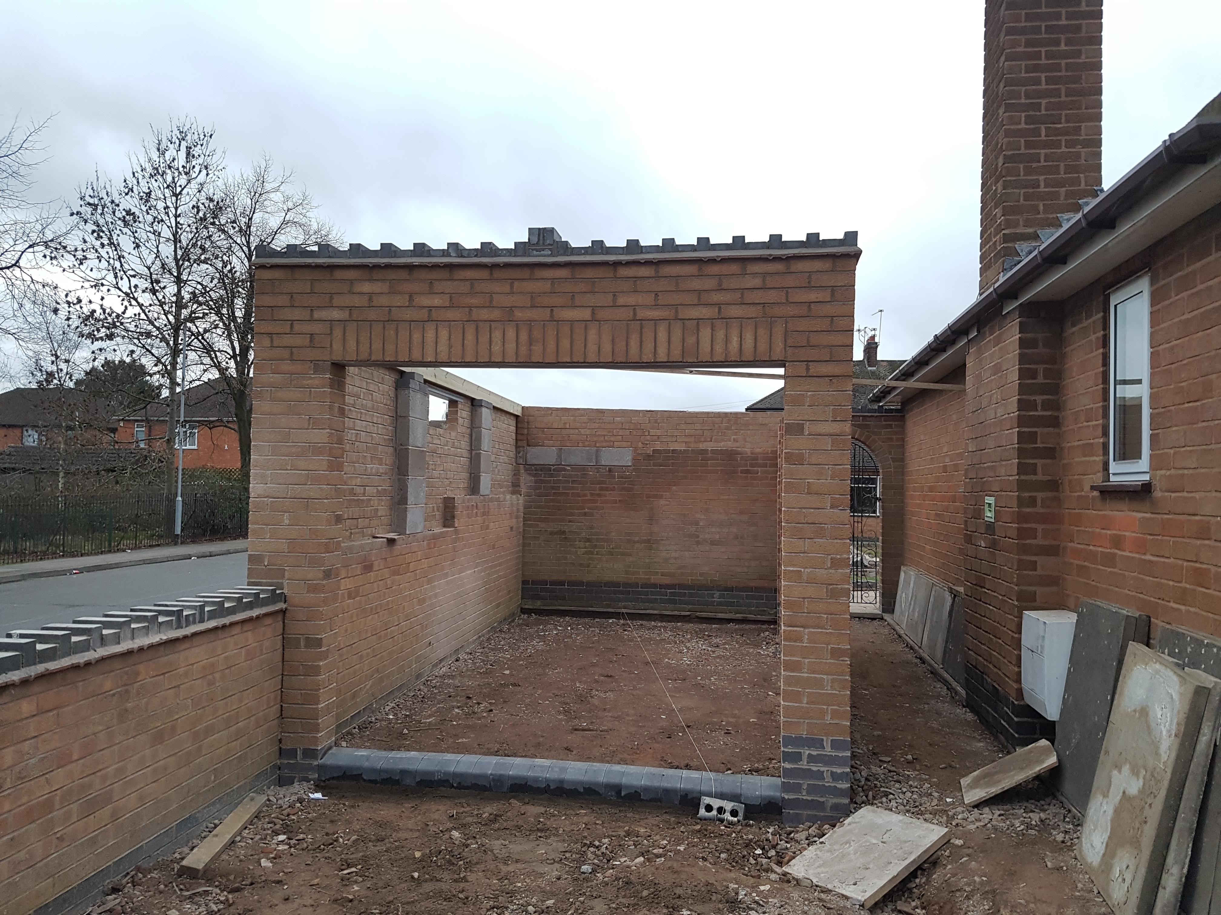

epsilonGreedy Posted January 17, 2019 Posted January 17, 2019 (edited) I am starting to think ahead to the FFL of my garage which will be a ground baring concrete slab. The garage is separate to the house and the adjacent gravel driveway is flat with a very slight gradient away from the garage door. Are there any industry metrics for a maximum height difference between external drive and garage floor? Other local factors favour a higher garage floor but a don't want a clutch burning sharp ramp incline when entering the garage. I am unlikely to be concerned about the front ground spoiler of my Ferrari (joke) grounding out on the ramp. The garage is not deep (5.3m) so I want to avoid creating a daily parking challenge that would involve revving the rear wheels up the ramp and then hitting the breaks to avoid nosing into the rear wall. Edited January 17, 2019 by epsilonGreedy

Oz07 Posted January 17, 2019 Posted January 17, 2019 51 minutes ago, Weebles said: I have a related question so will, for the moment, keep it on this thread. What does the "join" between driveway and garage floor look like? Any photos out there to help explain it? I am planning a garage door behind the piers of the garage so there will be a bit of "floor" sticking outside the door (or a bit of driveway running into the revealed area?). It seems to make sense to join at the rear of the reveals. But I want to make sure that no water can get through my driveway onto the concrete slab that is then under the rest of the garage. We can create a slight incline to make sure that water runs away...... Any advice please? I've just set one up using edging blocks tipped outwards and I'm going to have a trowled chamber and arris where this joins. Concrete will protrude out around 20mm past door but not to concerned about small amount of rain running onto it. Could paint/tank this strip. Gradient I'm doing an inch or so in around 1200mm with paving set half inch below kerb blocks 1
epsilonGreedy Posted January 17, 2019 Author Posted January 17, 2019 26 minutes ago, Oz07 said: I've just set one up using edging blocks tipped outwards and I'm going to have a trowled chamber and arris where this joins. This is very useful. I was already thinking about using a row of such blocks, will you bring the under slab tanking upwards inside the inner vertical face of the edging blocks? 30 minutes ago, Oz07 said: Concrete will protrude out around 20mm past door but not to concerned about small amount of rain running onto it. Could paint/tank this strip. Like you I am not that worried about a small amount of rain landing on the exposed concrete slab, my previous Bryant Homes house experienced the same and that was an integral garage. 37 minutes ago, Oz07 said: Gradient I'm doing an inch or so in around 1200mm with paving set half inch below kerb blocks So about 1 in 50. In my case I was considering a formed concrete ramp starting 10mm below the edging blocks then dropping about 50mm over 600mm horizontally.

Oz07 Posted January 17, 2019 Posted January 17, 2019 I could bang a row of oncrete edgings in behind these if other forum users think rain runoff from door splash will be excessively bad? Will tanking/painting first 2" be as good? Yes btw plan is to lap dpm up behind these
epsilonGreedy Posted January 17, 2019 Author Posted January 17, 2019 1 hour ago, ProDave said: Why not just grade the approach so you make any necessary rise over the length of a car? I am subject to a SUDS motivated planning condition that requires a gravel drive. My working assumption is that I cannot form a large stable ramp to the edge of the garage floor slab from a 50mm size hardcore base with 20mm size hardcore over and gravel dressing on top. 1 hour ago, ProDave said: The gradient is not the issue, it's the rate of change. I see lots of people have a very short very steep ramp which could be either the clutch burner, or spoiler catcher. Ok. Think I need to reduce my expectations about the overall height difference I can implement between gravel drive and concrete FFL. Now looking at: Concrete FFL > Edging stones with say a moulded 20mm drop > 10mm drop to start of external concrete ramp > 50mm gradient in concrete ramp that is 600mm wide > then level to main gravel drive. I already have 150mm of hardcore down for the drive and some flexibility about how much more is layered on top as a finishing exercise when the main build is complete.
epsilonGreedy Posted January 17, 2019 Author Posted January 17, 2019 9 minutes ago, Oz07 said: Yes btw plan is to lap dpm up behind these Hmm having suggested this I am now onto Plan-B. My new concern is that these edging blocks might start to wobble following repeated vehicle transits, so would it be preferable to have a concrete/mortar bond on the inner face at the risk of more moisture ingress? These blocks look like engineering blocks.
