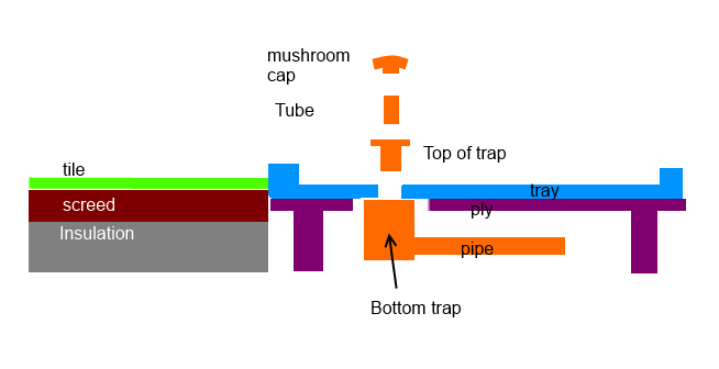

How are you doing the shower tray/trap?
If the tray is going on the floor (no plinth) then use a top access trap. We omitted the insulation under the tray and built a platform from marine ply and treated timber roughly the same height. That gave space for the pipework under the tray. Our tray was very heavy so we made a template and used it to get the waste pipe and base of the trap in the right place (clearance hole in the marine ply). Once happy the trap was in the right place we glued the tray down over it. Then seal and screw the top part of the trap through the tray into the bottom part.  Then fit the tube that forms the water seal in the trap and mushroom cap.
Very rough sketch not to scale
Edited by Temp

First floor bathrooms. On Egger board flooring at present. Pipework in the ground floor ceiling void.  So tray can go directly onto floor provided tile and insulation board depth isn’t greater than the tray I guess.
That can be of benefit, as the layers outside of the tray area bring you close to a flush floor / level entry into the shower.

By complete fluke, we ended up with a 25mm shower tray on the OSB deck being completely flush with the adhesive / backer board / UFH mat / latex / tile adhesive / tile.
When we fitted the shower glass, it went on a bead of clear Sikaflex on the shower tray edge - we used a few 2mm spaces to get some clearance. Once the Sikaflex had set, spacers were removed and the gaps plugged up with more sealant. Looks smart.
