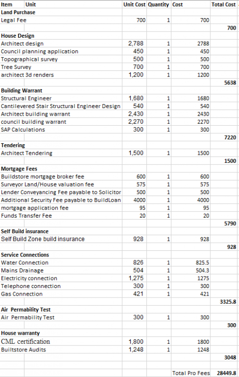

ultramods Posted January 16, 2019 Share Posted January 16, 2019 I have a list of all the professional fees for my self build. Depending on your plot you may also need to pay for: - Ecological/Bat survey - Soil Survey - Test Pits I created the floor plans for our house and the external "vision", then an Architectural Technologist drew up the plans professionally and submitted the plans to the council. As you can see from the fees above, to get to approved planning permission wasn't too expensive, we had 3D renders completed for £1200, that may not be needed. Unless you are very confident that you could design a house that is visually appealing, works well for you functionally, makes best use of the plot and most importantly will gain planning approval (think about the design of neighboring houses, local planning strategy, neighbors possibly objecting, conservation area etc) I would recommend having some sort of professional helping you with the planning phase. If I was to do it again, I would: Do exactly the same as I have up to the planning approval, with the exception of not having the 3D renders completed by the Architect. If I needed 3D renders to support the planning application I would get a specialist such us https://www.facebook.com/touch3dvisualisation/ to provide the 3D renders. Once I had planning permission and I was going to build using timberframe I would then ask several timber frame companies to quote for completing the structural engineering drawings, building warrant and finally producing the timber frame. I would do it this way as you are then only dealing with one company rather than 2 - 3, which I think would make the timeline up until the kit arriving on site faster (based on my experience). The reason I wouldn't ask the timber frame company to also do the initial design of the house and the building warrant is because I wouldn't want to be tied to a particular company as they may possibly charge you more, for the building warrant and kit etc as they know you are tied to them. Your other option could be to see if any of the timber frame companies have existing designs that you like as then you could get pricing from them before committing to them. Scotframe for example have various house designs to choose from. Link to comment Share on other sites More sharing options...
Moonshine Posted January 16, 2019 Share Posted January 16, 2019 10 minutes ago, ultramods said: Depending on your plot you may also need to pay for: - Ecological/Bat survey - Soil Survey - Test Pits add to that, potential - Air quality - Noise assessment Link to comment Share on other sites More sharing options...

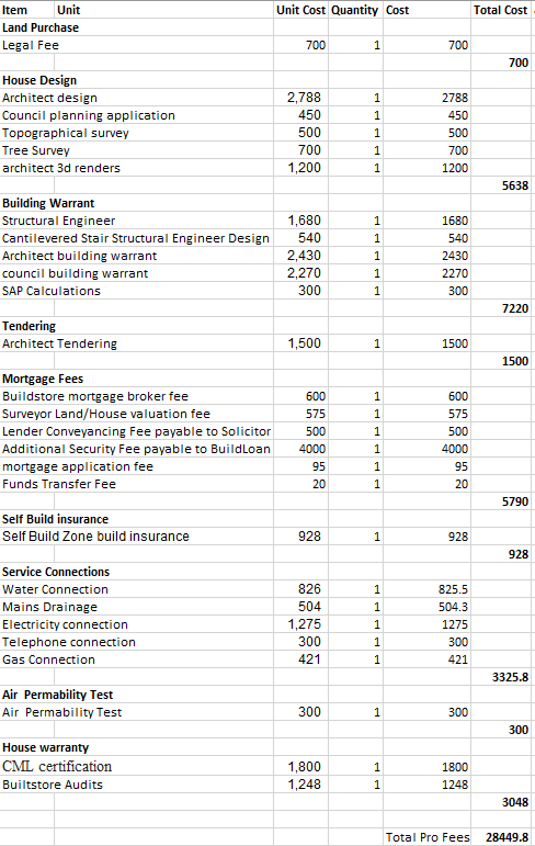

Ferdinand Posted July 9, 2019 Share Posted July 9, 2019 On 16/01/2019 at 16:45, ultramods said: I have a list of all the professional fees for my self build. Depending on your plot you may also need to pay for: - Ecological/Bat survey - Soil Survey - Test Pits I created the floor plans for our house and the external "vision", then an Architectural Technologist drew up the plans professionally and submitted the plans to the council. As you can see from the fees above, to get to approved planning permission wasn't too expensive, we had 3D renders completed for £1200, that may not be needed. Unless you are very confident that you could design a house that is visually appealing, works well for you functionally, makes best use of the plot and most importantly will gain planning approval (think about the design of neighboring houses, local planning strategy, neighbors possibly objecting, conservation area etc) I would recommend having some sort of professional helping you with the planning phase. If I was to do it again, I would: Do exactly the same as I have up to the planning approval, with the exception of not having the 3D renders completed by the Architect. If I needed 3D renders to support the planning application I would get a specialist such us https://www.facebook.com/touch3dvisualisation/ to provide the 3D renders. Once I had planning permission and I was going to build using timberframe I would then ask several timber frame companies to quote for completing the structural engineering drawings, building warrant and finally producing the timber frame. I would do it this way as you are then only dealing with one company rather than 2 - 3, which I think would make the timeline up until the kit arriving on site faster (based on my experience). The reason I wouldn't ask the timber frame company to also do the initial design of the house and the building warrant is because I wouldn't want to be tied to a particular company as they may possibly charge you more, for the building warrant and kit etc as they know you are tied to them. Your other option could be to see if any of the timber frame companies have existing designs that you like as then you could get pricing from them before committing to them. Scotframe for example have various house designs to choose from. Twice as much on mortgage fees as on the architect designing it. Ouch. Link to comment Share on other sites More sharing options...
