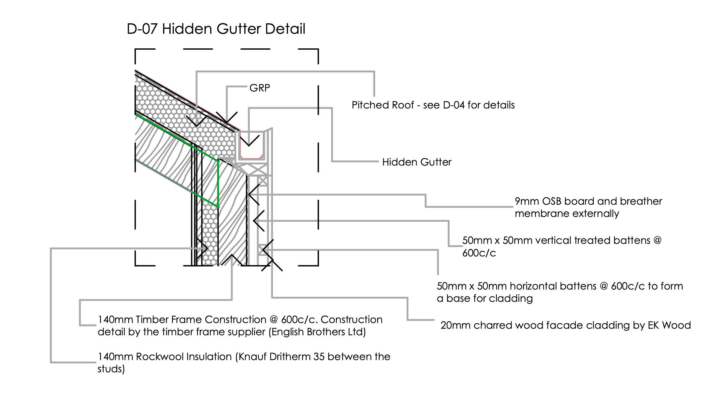

Hi,
My build is going ahead with English Brothers. They were not very keen on designing any of the detail, so I did it myself.
I am using the benefit of a timber clad construction. The particular facade with the gutter in question will be built on 50 x 50 vertical, then cross battens to gain enough depth for a detail.
Below is a snippet of my proposed section, although yet to be updated. The whole pitched roof part will be GRPed together with the gutter detail. Wood cladding will then continue onto the pitched roof. There will be solar PV panels, too. None of this is being reflected in the below rather basic "sketch":
1090220178_Screenshot2021-11-02at13_18_16.thumb.png.d81f9b5528a78b579a3f3c7fac9c5a9c.png

BartW
Many thanks for sharing this - it is exactly the debate i am having (with myself!) at the moment.
I would really like to achieve a hidden gutter but the presence of a wooden frame and cladding are starting to get me worried about water ingress.
On the section a couple of quick questions ...
- How are you going to run the downpipes (perhaps you have a convenient gable end to work that into?)
- Will your wooden cladding be exposed at the top or capped off by the gutter flashing somehow ?
- What are you laying over the GRP on the roof ?
Many thanks for your thoughts / time in advance
Bob
