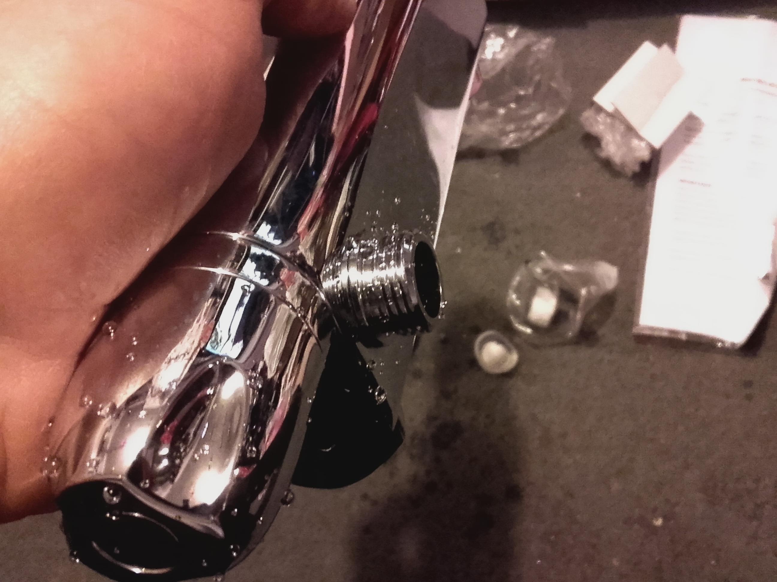

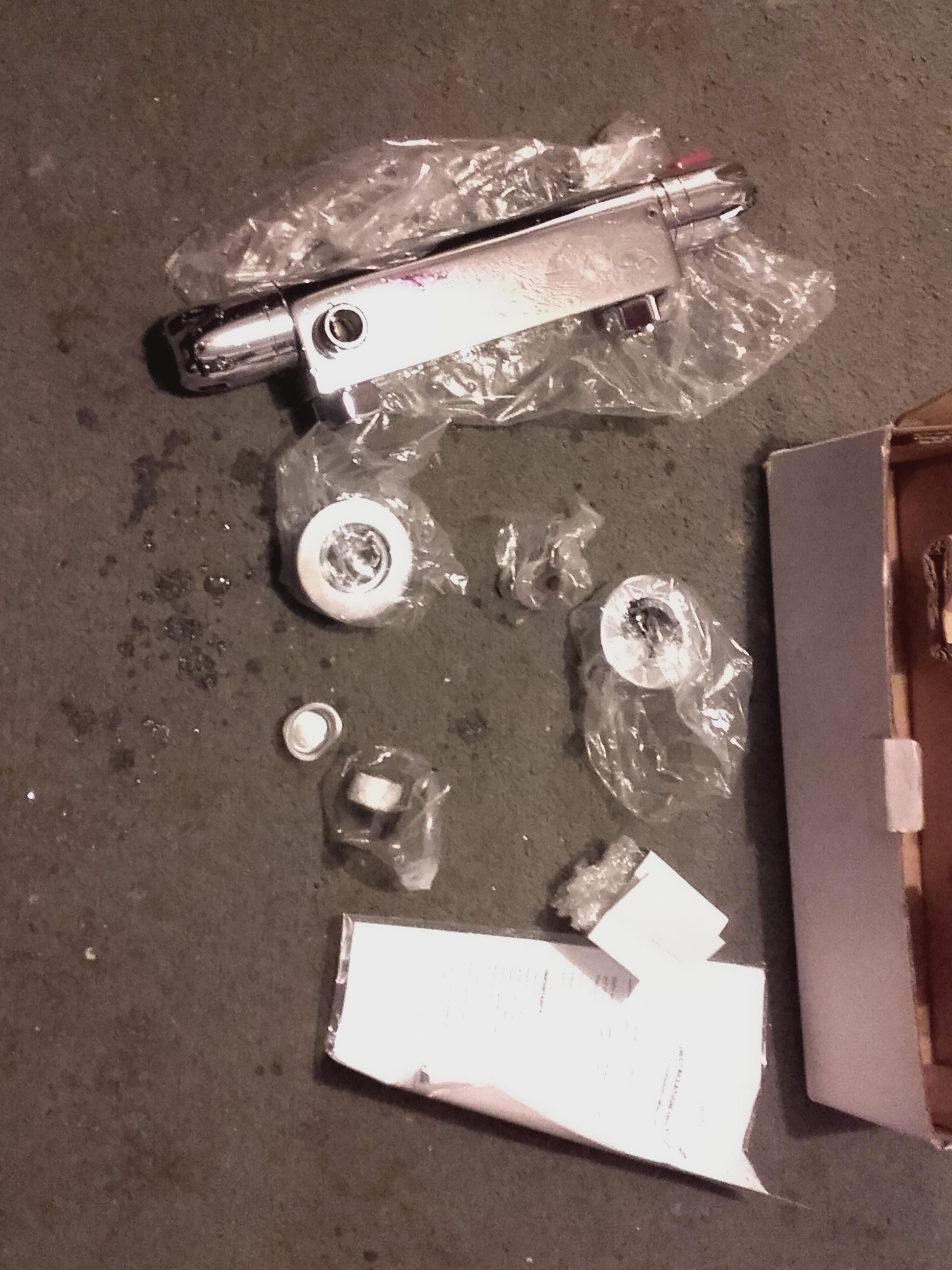

Onoff Posted December 27, 2018 Author Share Posted December 27, 2018 C***TS! Box was open. Said so and had a quick check everything was there. Lad said it would just have been where someone wanted a look. Opened at home and it's pi$$ed out water! Well it's going in in a minute with a rocket up the ar$e email to Screwfix. Link to comment Share on other sites More sharing options...
Onoff Posted December 27, 2018 Author Share Posted December 27, 2018 "New" one all in and working. Still have to drop the handset to get the pump to kick in but hey ho. Cheers all. Link to comment Share on other sites More sharing options...
