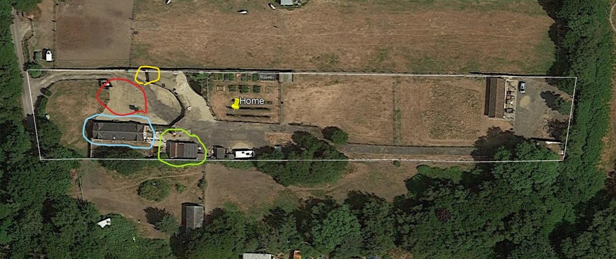

Sue B Posted December 23, 2018 Share Posted December 23, 2018 So..... We have lived her for 3 years now and got the feel of the place. It's now time to get my arse into gear and start work on building the new house before getting a mortgage becomes completely unaffordable. We have 1.5 acres in Dorset, flat and quiet and not overlooked. We have planning permission for a replacement dwelling as what we currently live in is classed as a temporary structure and therefore un-mortgagable. I can hardly believe we are going to build again. To do it once by accident is careless, twice is downright lunacy! We just wanted to live somewhere with a bit of land for the dogs to run wild and the only thing we could afford was this place. Our neighbours each side are horses - council owned on one side and the other side have tried to get permission for a dwelling that they can live in but have been refused. The rest of the lane has similar problems and the council have refused planning on most plots. We are green belt and within 400m of a SSSI (St Catherines Hill) - apparently there are a lot of Adders up there which I'm glad I didn't know about when we moved here or I may have thought twice. Luckily we have never seen one when walking the dogs up there. When I designed the last house I thought it was hard because we were constrained to 45ft wide and no more - the neighbours would have complained if we had built on their bit . I always wanted just a little bit more to make the rooms a better size, contraints I now realise actually help focus the mind a little. It took to plan 32 before I got pretty much everything I wanted last time so being on plan 11 means I have a long way to go yet. The picture shows our plot, we have built a kitchen garden since arriving and a large koi pond (you can see it right next to the kitchen garden - it's a rounded triangle shape). The house that we currently live in can stay in place until we are ready to move in to our new house. The planning conditions state that it must be removed from site within 28 days of completion. The house is the light blue circle. The lime green circle is where the utility room / car port / shed / dog shower is currently. We are hoping that we may get the planners to allow us to replace this structure and incorpotate it into our build - currently they are restricting the size of the dwelling to 197m2. We will be building the new house where the red circle is and the yellow circle is the gate that we will use to drive through to get down the plot or park round the back. We have seen pictures of when our current house was tractored onto site from 5 plots up - the concrete underneath is thick and reinforced. We are therefore planning to have this as our patio / decking area so the new house needs to be a close as possible to the current place and in a similar position else we will be spending a lot of money on replacing soil and removing concrete. Wish me luck - Christmas is going to be attached to my laptop, drinking pink gin and muttering about the stupidity of building at our age! Oh and visiting @D Walter on the IOW to look at Velox. 1 Link to comment Share on other sites More sharing options...
ProDave Posted December 23, 2018 Share Posted December 23, 2018 That looks like a fantastic plot. Care to post the house design yet? If you want to build as close as possible to the old house you could leave off the wall finish on that elevation until the old house has gone that might enable you to get a bit closer? Link to comment Share on other sites More sharing options...
Sue B Posted December 23, 2018 Author Share Posted December 23, 2018 The plot runs west to east so the length of the patio will be completely south facing. We are heading towards a modern style of house with a flat roof. The reason being that neither of us like looking at solar panels. A flat roof means that we can have solar panels on top but not see them. We can also have separate banks facing east, south and west to get the sun all day long without worrying about which way the roof faces. I have a hatred of being too hot so I am paranoid about having a house that I cannot keep cool. I am therefore planning to have the first floor coming out by about 1m to give some shade during the height of the summer to the living areas. None of the bedrooms upstairs have south facing windows - wide balconies (I'll be fitting fly screens as the bugs round here are enormous!) and doors that can be opened wide. Probably need some kind of shutters to allow ventilation whilst staying secure inside overnight. The bathrooms - I'm thinking roof lights with blinds. We had sunpipes in the last house and they worked great - it saved wall space in small rooms where windows would have got in the way of placing sanitary ware in a space efficient way. We are planning to build in ICF - costs mean that we will be doing this ourselves (heaven help us!!!) and are currently comparing Durisol and Velox. Durisol looks a little easier but I think that Velox may be easier to get air-tight. The garage is only if we can get it past the planners. I think they may go for it with some explanation of needing a bedroom downstairs for elderly MIL and getting rid of the existing car port place. Be gentle with me but I am very open to ideas. Link to comment Share on other sites More sharing options...

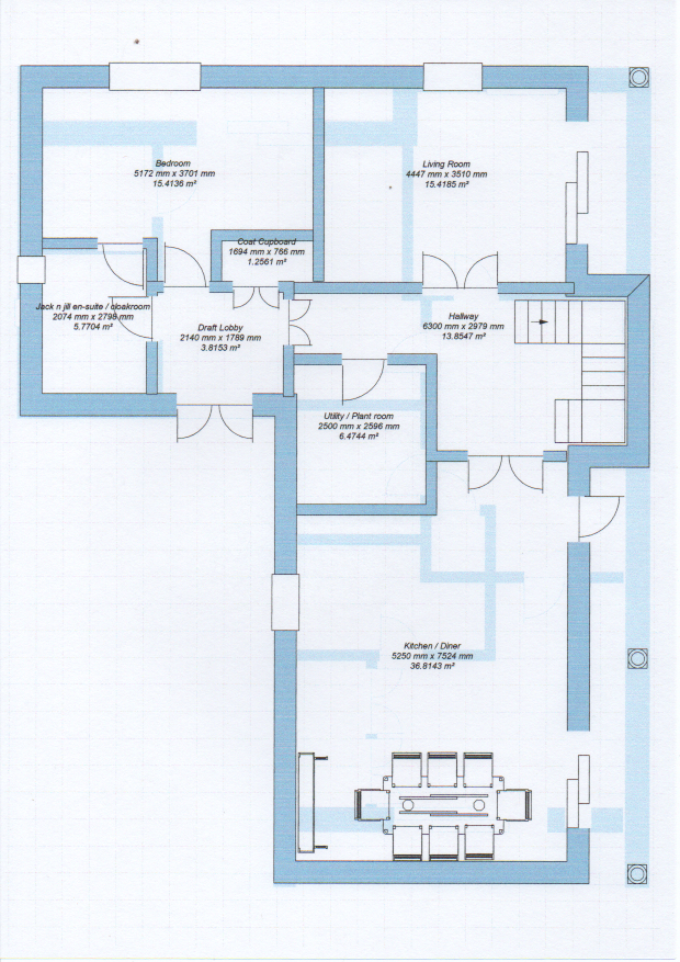

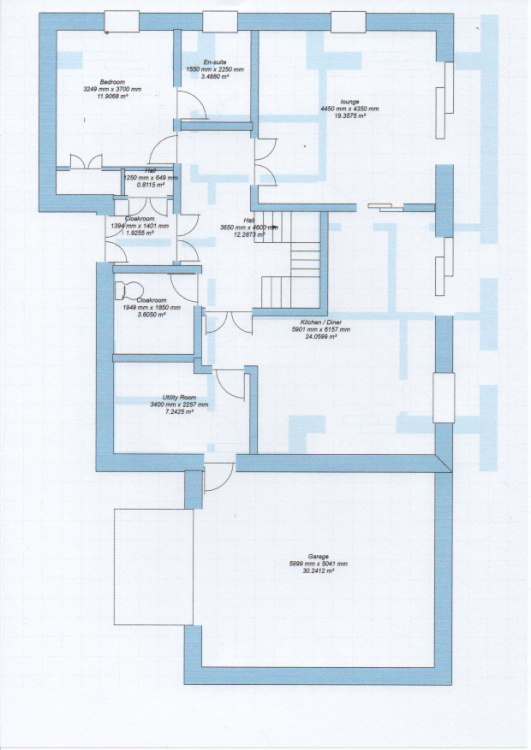

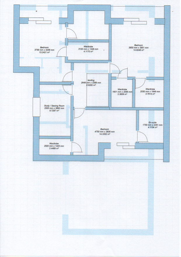

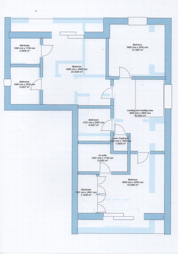

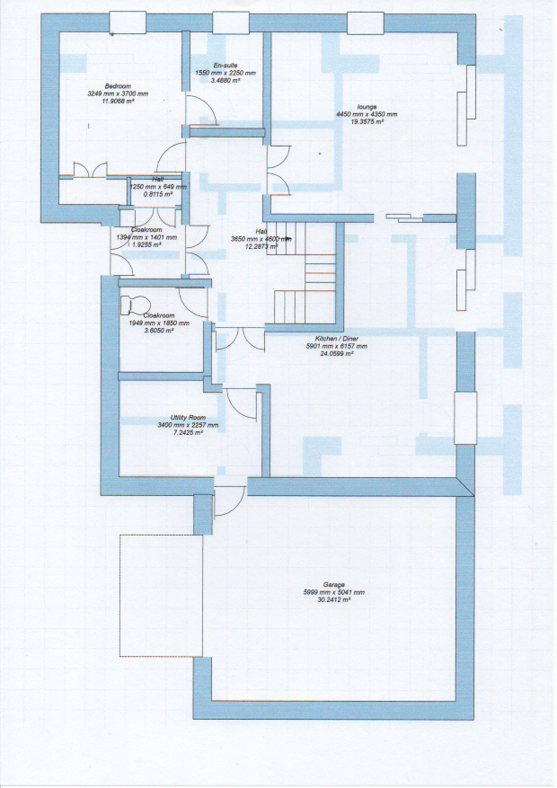

Sue B Posted December 30, 2018 Author Share Posted December 30, 2018 Up to plan 16 - a long way still to go. Starting to get all the water together which is a help. I've decided to take the garage away and add my sewing room to that which will be a separate building replacing the car port. I still like the idea of roof lights for the bathrooms upstairs - cost will determine if that is possible or not of course. We have now visited @D Walter to see Velox on site. Really like the look of the procudt and it helps that his site is beautiful and the house will be stunning. I reckong there are a fair few more designs to work through - my memory of last time is that I ending up printing them all out, writing on each why we had discounted that plan and what we liked about it. I then got the best bits from them all. I seem to remember that the actual plan we used was a fairly early version but it just needed flipping over. For timescales, we are hoping for planning permission by early summer, foundations in place fairly quickly after that and then building the garage / sewing room. We can then see if we are capable to actually building ourselves and get an idea of how much labour we will need on site. Picking up one of the internal wall boards on David's site was an eye opener due to it's weight - we could barely lift it!! Anyway, here is the most up to date version. Link to comment Share on other sites More sharing options...

PeterW Posted January 2, 2019 Share Posted January 2, 2019 @Sue B looks good ..! I would make a couple of changes - master bed en-suite door needs moving to the right or even onto the short wall as it wastes a huge amount of space. Also swap the downstairs Jack and Jill door into the bedroom to open into the bedroom as otherwise you will have very little floor space in there. @D Walter what wall board are you using ..? Link to comment Share on other sites More sharing options...
