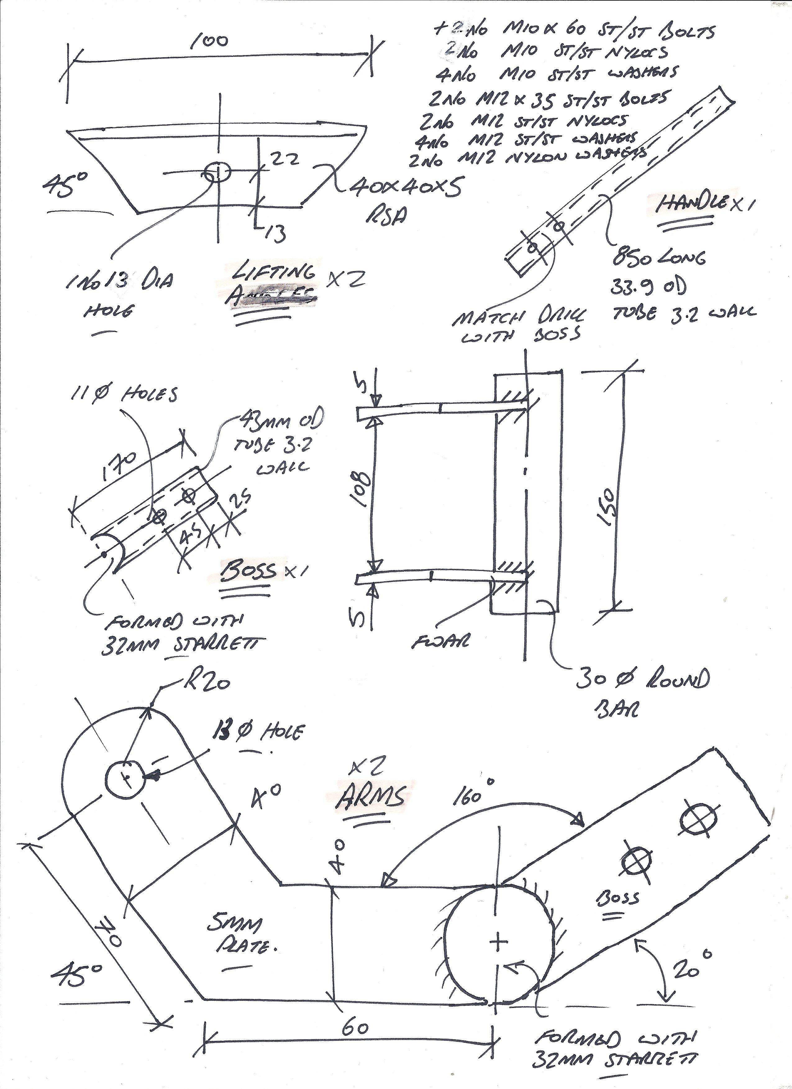

Dog rough sketch of the one I made in the video:
 Great stuff.  Thanks.
If you make one then consider what type of pallet you'll mostly be stripping and adjust to suit so it slips over the main bearers. My one is a bit restricted to the circa 2"  wide bearers though you can unbolt the angles and have them facing outward. Original thread on it here:
