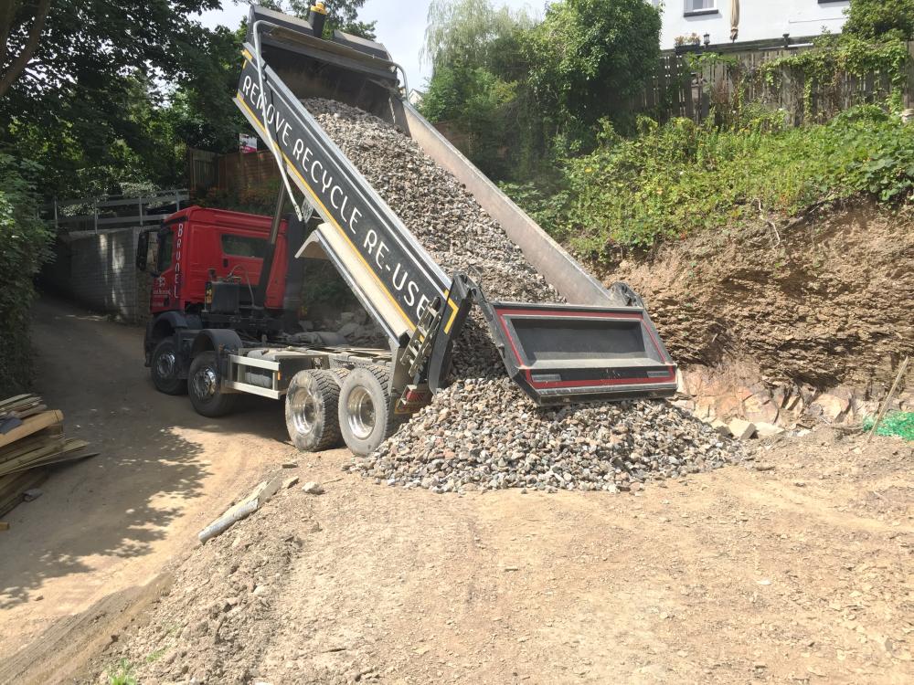

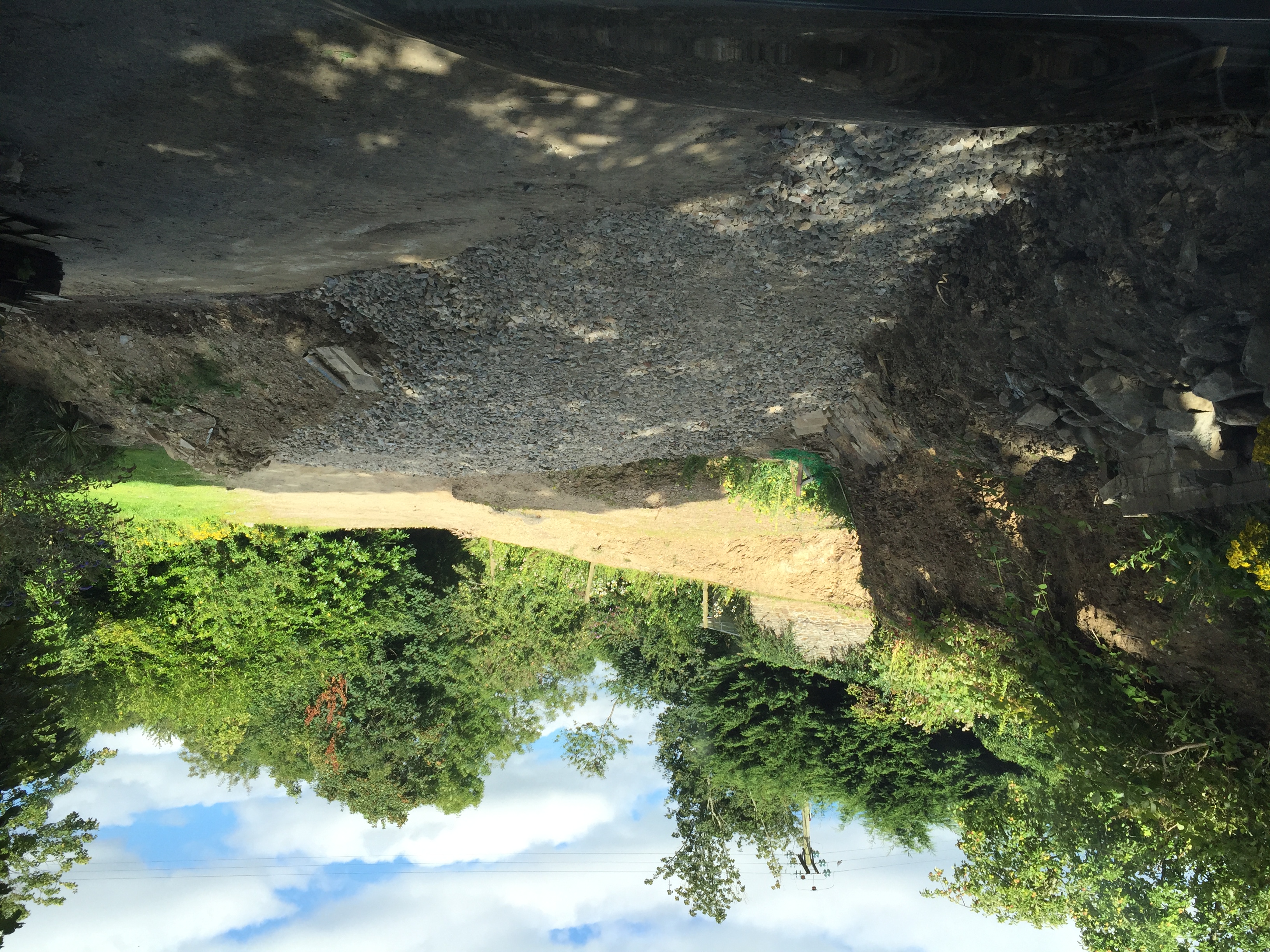

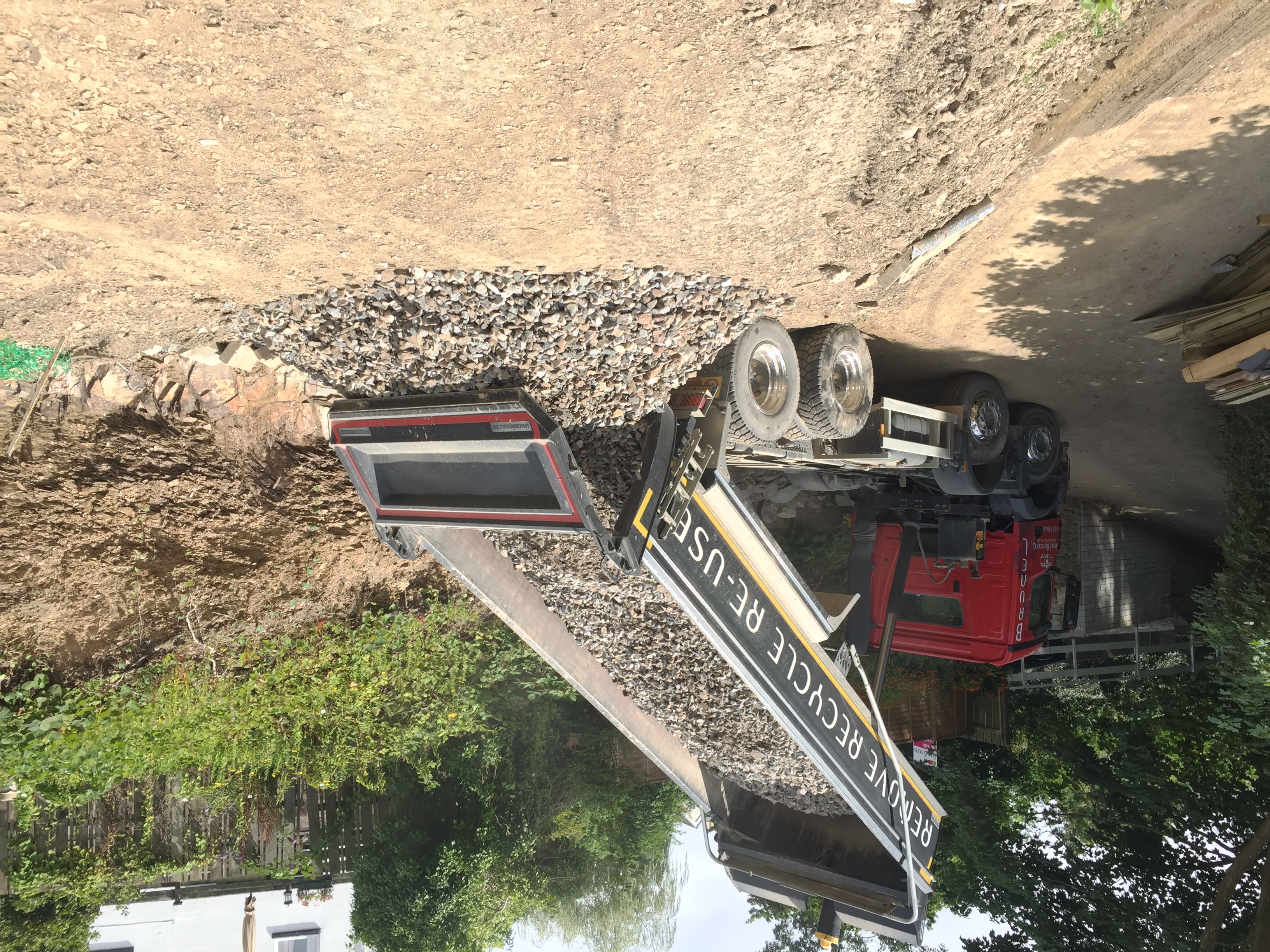

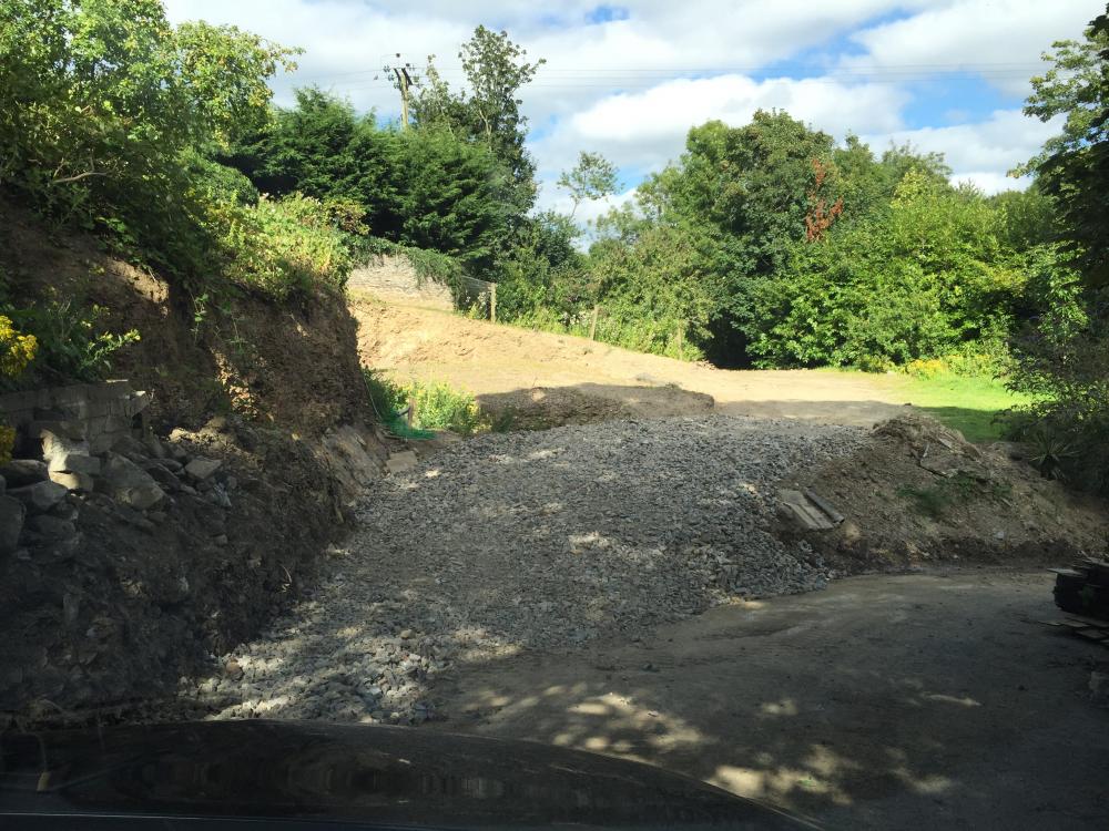

Grosey Posted August 12, 2016 Author Posted August 12, 2016 Just to close this issue had my first load delivered today, 4" down, got a nice levelled site entrance now which should pay dividends for all future deliveries. Next load coming tomorrow morning. 2
jack Posted August 15, 2016 Posted August 15, 2016 Looks like a good mix of sizes there. Should bed down nicely (and it will need to looking at that slope! )
