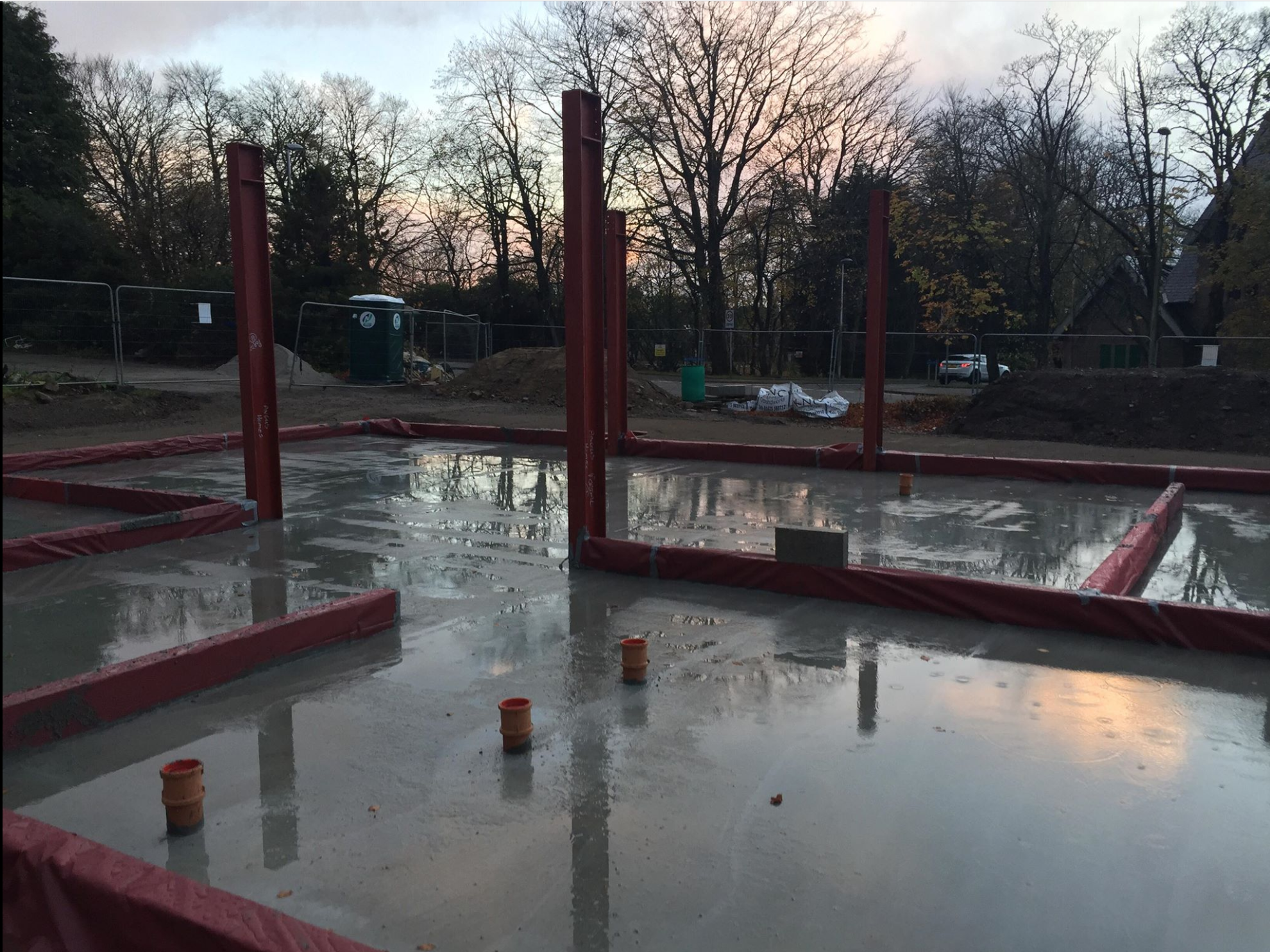

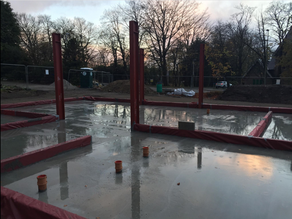

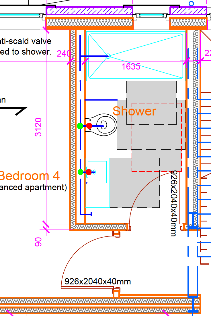

ultramods Posted December 2, 2018 Share Posted December 2, 2018 I think the drain stacks for the toilet and sink are in the wrong positions. The current positions are where are have circled red in the picture below, however they should be where I have circled. Without having to dig up the concrete would it be possible to move the position slightly using an angled pipe since the insulation, UFH and screed haven't gone down yet? If I would need to ask to builder to move the position by digging up the concrete would this be a big issue for them? Link to comment Share on other sites More sharing options...
PeterW Posted December 2, 2018 Share Posted December 2, 2018 Move the wall in by 120mm.?? Or are they out by more than that ..?? If it’s a tray going in there they are standard sizes but a wet room you wouldn’t notice. 1 Link to comment Share on other sites More sharing options...
ultramods Posted December 2, 2018 Author Share Posted December 2, 2018 1 minute ago, PeterW said: Move the wall in by 120mm.?? Or are they out by more than that ..?? If it’s a tray going in there they are standard sizes but a wet room you wouldn’t notice. worst case I can just move the wall, however would like to explore all the options as the shower room isn't the widest. Link to comment Share on other sites More sharing options...
Russell griffiths Posted December 2, 2018 Share Posted December 2, 2018 If that is a vanity unit, then why do you need to move that one ? just move the toilet one. Link to comment Share on other sites More sharing options...
ultramods Posted December 2, 2018 Author Share Posted December 2, 2018 (edited) the basin and toilet will both be wall hung. I want the bulkhead to be flush with the wall. The shower room layout is similar to the photo below. Edited December 2, 2018 by ultramods Link to comment Share on other sites More sharing options...
ProDave Posted December 2, 2018 Share Posted December 2, 2018 Kick them both back with 2 45 degree bends as close to the concrete slab as you can get and hope they will both be hidden in the floor makeup. You might want to buy a couple of bends and try it first before you commit to it. 1 Link to comment Share on other sites More sharing options...

PeterW Posted December 2, 2018 Share Posted December 2, 2018 What is the insulation and floor build up, and what direction does the main pipe run..? You do not want a double S bend for a No.2 to be heading down before it gets to the main run... Link to comment Share on other sites More sharing options...
ultramods Posted December 2, 2018 Author Share Posted December 2, 2018 9 minutes ago, PeterW said: What is the insulation and floor build up, and what direction does the main pipe run..? You do not want a double S bend for a No.2 to be heading down before it gets to the main run... 150mm kingspan then 70mm screed. The drains exist straight out at the nearest visible external wall (next to the shower drain) Link to comment Share on other sites More sharing options...
PeterW Posted December 2, 2018 Share Posted December 2, 2018 How thick is that concrete...?? I'd be cutting that out and moving it Link to comment Share on other sites More sharing options...
ultramods Posted December 2, 2018 Author Share Posted December 2, 2018 2 minutes ago, PeterW said: How thick is that concrete...?? I'd be cutting that out and moving it 125mm Link to comment Share on other sites More sharing options...
PeterW Posted December 2, 2018 Share Posted December 2, 2018 Easy cut with a Stihl saw then - how far below are the pipes..? Link to comment Share on other sites More sharing options...
ultramods Posted December 2, 2018 Author Share Posted December 2, 2018 (edited) @PeterW i'm not sure exactly, maybe 400mm, you can see them and the of the photo below nearish the digger. Edited December 2, 2018 by ultramods Link to comment Share on other sites More sharing options...
