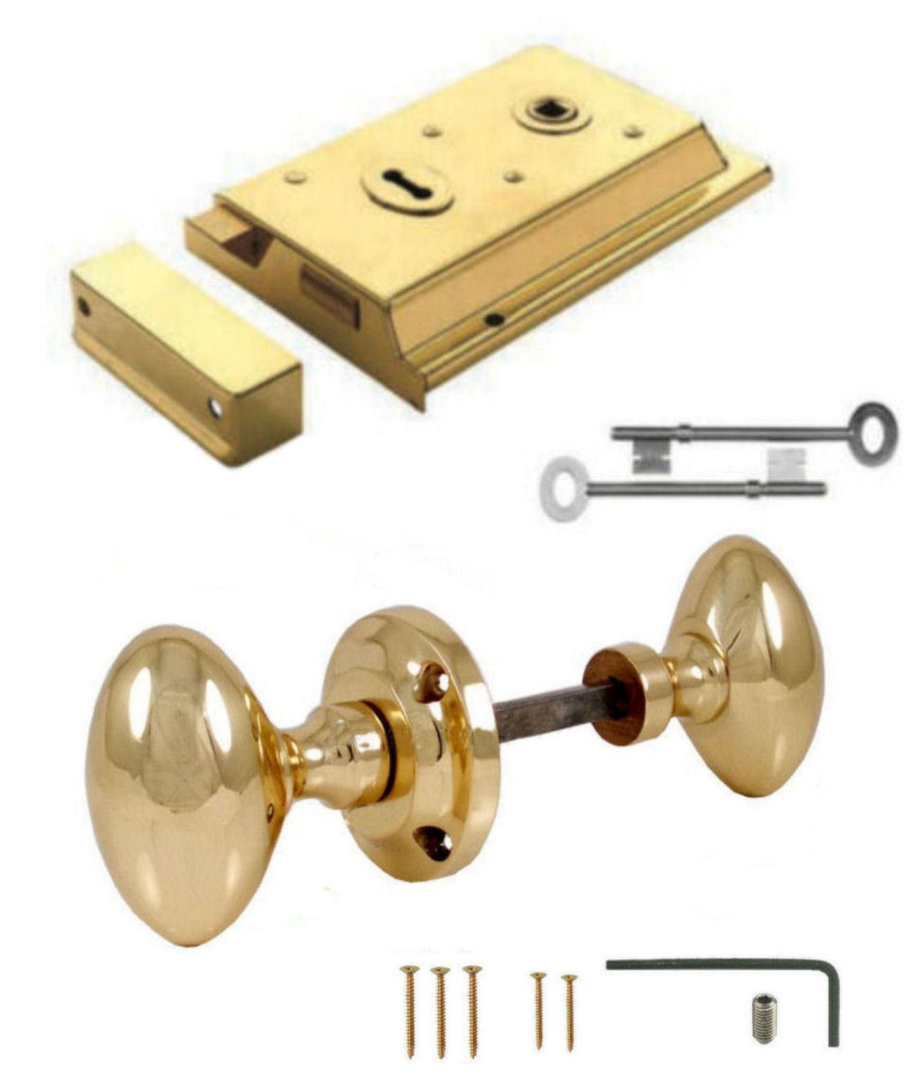

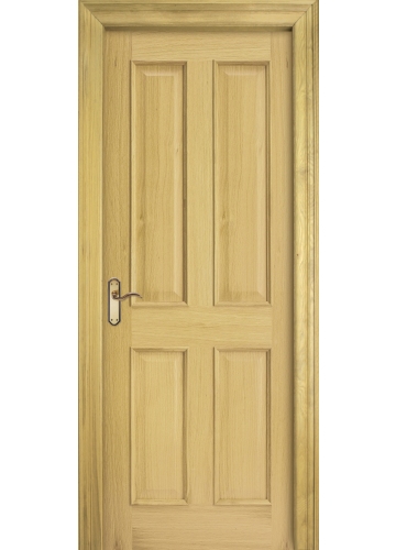

slidersx200 Posted August 2, 2016 Share Posted August 2, 2016 Placing the order for our doors and ironmongery this week and a supplier has said they would not recommend the knobs we picked for the style of door we want (or in general). Here is the style of knob: Here is the style of door: They claim the issue is that there isn't enough room for your hand to avoid contact with the door stop and raised moulding on the door and the way to avoid the issue is to fit lever handles. Are there any other solutions or work arounds? I have seen tubular mortice latches that are longer - 76 or 102mm instead of 63mm. Any problem with using these mounted at the midrail height? We'd like to be able to lock the bedrooms to keep the prisoners in, but combined mortice locks appear to suffer from the above problem, so as an alternative I was looking at these: Any potential problems or drawbacks with this design? Finally, for the bathrooms we wanted to add these: Any problems with using these on 40mm internal doors? Cheers Michael Link to comment Share on other sites More sharing options...

Construction Channel Posted August 2, 2016 Share Posted August 2, 2016 the only place you will get a knob on that door is in the mid rail, even if you do use the surface mounted (rim lock) there is nothing wrong with doing this really, only issues are they can seem a bit low, and it "technically" will weaken that joint in the door (not enough to worry about AFAIC) I personally dislike Knobs for a whole host of reasons, this not being a major one, But if that is the style you would like there is no point me trying to dissuade you. One thing to note is if they are on actual fire doors with the massively oversized door stops make sure you get the REALLY long latches (or longer rim locks) HTH Ed Link to comment Share on other sites More sharing options...
slidersx200 Posted August 2, 2016 Author Share Posted August 2, 2016 Thanks for all the replies guys! The longest tubular cylinders I've found place the centre of the spindle 102mm in from the edge of the door and the surface mounted locks place the spindle 108mm from the edge of the door. The longer "side" of the oval handles is 55mm, so it should be 77mm from the edge of the door and if the doorstop is ~20mm thick there should be more than 50mm of knuckle room. My darling wife has assured me most convincingly that we will under no circumstances be having lever handles. ? Link to comment Share on other sites More sharing options...
Construction Channel Posted August 2, 2016 Share Posted August 2, 2016 iv been here before, you should be fine if the spindle is 100+mm from the edge of the door, are there any rules about locks on bedroom doors? is it a new build? Link to comment Share on other sites More sharing options...

slidersx200 Posted August 3, 2016 Author Share Posted August 3, 2016 @Kev106 that's very helpful to see, thank you. Do you know what distance the knob spindle is off the edge of the door? Are your privacy locks and main latch part of the same unit? Link to comment Share on other sites More sharing options...
Kev106 Posted August 3, 2016 Share Posted August 3, 2016 Seems to be 105mm 1 Link to comment Share on other sites More sharing options...
slidersx200 Posted August 3, 2016 Author Share Posted August 3, 2016 Brilliant cheers! Link to comment Share on other sites More sharing options...
