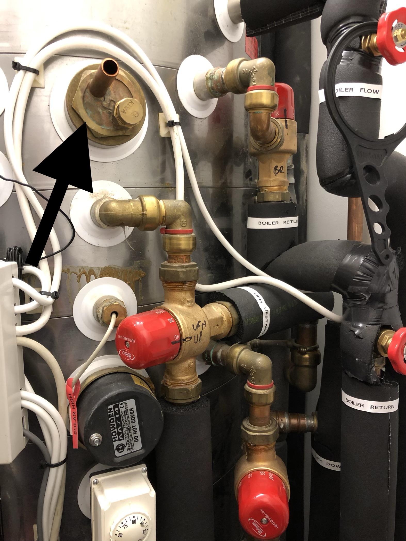

newhome Posted November 20, 2018 Posted November 20, 2018 As a follow up question for this should all 'hot' pipework that is exposed be insulated? Most of the pipework out of my TS is wrapped in Armaflex thanks to the dynamic duo who came up to fix it but there are still some pipes or parts of pipes that are roasting hot. Not sure if I should be wrapping these in the stuff too? They are the more awkward shaped, smaller bits so it would be doable albeit a bit of a faff. And presumably the naked TS is ok too and doesn't need any sort of jacket / insulation?
PeterW Posted November 20, 2018 Posted November 20, 2018 The naked TS actually has a jacket on it already - the tank is inside the outer shell that will be insulated. All the pipework should be insulated - probably put that down to them not being fully “focused” after a night on the Belhaven ..... 1
newhome Posted November 20, 2018 Posted November 20, 2018 I think the night in question was McEwans - the Belhaven was long gone by then . I'll take a photo of the 'bits' that are roasting hot and see what you think.
newhome Posted November 20, 2018 Posted November 20, 2018 Here are the bits! All of the exposed pipe work off the blending valves plus the weird round bit with the arrow pointing at it.
Alexphd1 Posted November 20, 2018 Posted November 20, 2018 (edited) That would be a bugger of a job with normal pipe insulation but you could try pipe insulation tape. It's only 3mm thick but would be better than nothing. Here's a link but shop about. https://www.amazon.co.uk/Armaflex-Pipe-Insulation-Tape-50mm/dp/B0069R66BA Edited November 20, 2018 by Alexphd1 1
PeterW Posted November 20, 2018 Posted November 20, 2018 The thing with the pipe poking out is the old quench coil - not a lot you can do with that.
newhome Posted December 2, 2018 Posted December 2, 2018 On 20/11/2018 at 20:45, newhome said: @PeterW I've added insulation to those bare pipes now but what is that black sticky tape you have used to hold it together elsewhere? I've tried something that I had here but I don't think it likes the high temperatures and just unsticks itself. I am going to buy some of the tape that @Alexphd1 suggests too to cover up the bits that are too small to use the normal insulation on.
