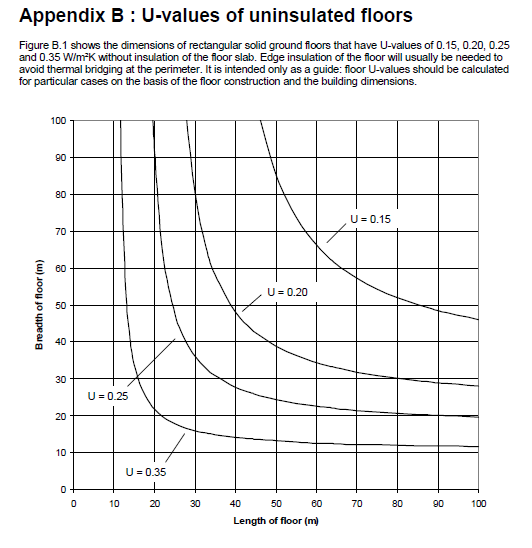

Ed Davies Posted November 7, 2018 Share Posted November 7, 2018 The point is that the earth under the floor will provide some resistance to be added to that provided by the materials you lay on top. How much is very dependent on the properties of the soil (dry sand will insulate a lot better than wet mud) and also on the geometry of the house because heat loss has to go sideways. A round house (or, more likely, square one) will lose a lot less through the soil than a long thin one. This could all be calculated using finite-element analysis or whatever but in practice is it's approximated based on the perimeter to area ratio, as @PeterW says. Sorry, don't know the details of the calculation. But, I'm not sure that chart you quote is quite right. It gives “Ext surface” R = 0.040. That's the value for an external surface to air, I don't think it applies for an interface to mud and I think the value should be approximately zero. However, it's a tiny fraction of the total resistance anyway so will not make any significant difference. 1 Link to comment Share on other sites More sharing options...
A_L Posted November 7, 2018 Share Posted November 7, 2018 1 hour ago, JohnW said: Can anyone please explain how the 0.14 was achieved...what am I missing??? The reason is that the thickness of one of the layers, the soil, varies across the area of the floor. The heatloss path is floor surface - soil - external air. Therefore at the edge of the slab there is little/no soil and the local R value is approximately the higher one. The area at the middle of the floor has the thermal resistance of a considerable thickness of soil and thus a higher R-value. The 0.14 U value is the weighted average of the whole floor. If you try using floors of the same area but different P/A ratios you will see the effect, since higher P/A ratios imply less 'square' shape which have greater exposed perimeters for a given area, e.g. the common perimeter of two adjoining semi's would not be included. 1 Link to comment Share on other sites More sharing options...

ADLIan Posted November 7, 2018 Share Posted November 7, 2018 As stated the heat loss from a ground floor depends upon the size, shape, edge conditions and soil type. Best analogy I've heard is consider a ground floor like a bowl of hot soup - it will be cooler at the edges (=greater heat loss) and warmer at the center (less heat loss). This table from BR 443 may help - larger, square floors having a lower inherent U-value. With current levels of insulation in the general floor area (>100mm PUR or equivalent) vertical edge insulation has little effect on the overall U-value but is important to minimise the linear thermal bridge at the floor/wall junction (which is where BR 497 comes into play as guidance and standard conventions when using BS EN 10211). 1 Link to comment Share on other sites More sharing options...
