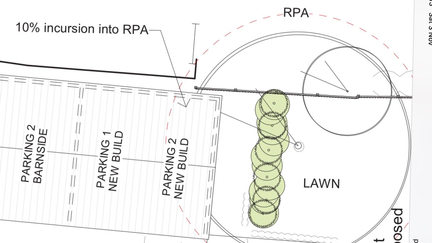

Cambs Posted November 3, 2018 Posted November 3, 2018 (edited) Quote 2 hours ago, Moonshine said: I have just learnt about root protection zones, and this may be an headache in relation to my site, but not a show stopper. I may have to change layouts around. The tree in question is not mine and so can't do anything about it. Does any one have any experience of these and does it mean you can't do anything in these zones, or can you do anything to a certain depth. Are they in force for all trees or just ones with TPO? We’re building in a conservation area and trees are protected. The tree officer said : “The proposed site plan indicates the rpa incursion of 10% of a single tree. This is acceptable.” So you can encroach into the RPA. The attached is extracted from our application drawings. Edited November 3, 2018 by Cambs Correct typo 1
Moonshine Posted November 3, 2018 Author Posted November 3, 2018 Oh, any idea where the 10% is from? Any guidance on the subject?
Alexphd1 Posted November 3, 2018 Posted November 3, 2018 Hi. We have trees with a TPO on them, as stated above we fenced them of with heras fence to give them a bit of protection. We also had to lay a no dig drive way through the trees which is a plastic webbing then filled with stones. It's pretty strong we have had lorries and a 36m concrete boom pump. 1
Cambs Posted November 3, 2018 Posted November 3, 2018 22 minutes ago, Moonshine said: Oh, any idea where the 10% is from? Any guidance on the subject? From the Woodland Trust’s website: How is a root protection area calculated? The British Standard 5837, RPA is calculated by multiplying the diameter of the tree at breast height in meters by 12 but is capped as an area with a radius of 15m. .... and then I guess my designer just calculated the area of the garage that was encroaching into the RPA and divided it by the area of the RPA to get to his 10%. You can find a copy of the relevant BS online in some places - it costs £224 to buy from BSI or just Google “Crawley BS5837” and you can see it for £0 ?. Have a look through that to see what is relevant for what you are trying to do but, for example, section 7.4.2.3 states “New permanent hard surfacing should not exceed 20% of any existing unsurfaced ground within the RPA.” 1
