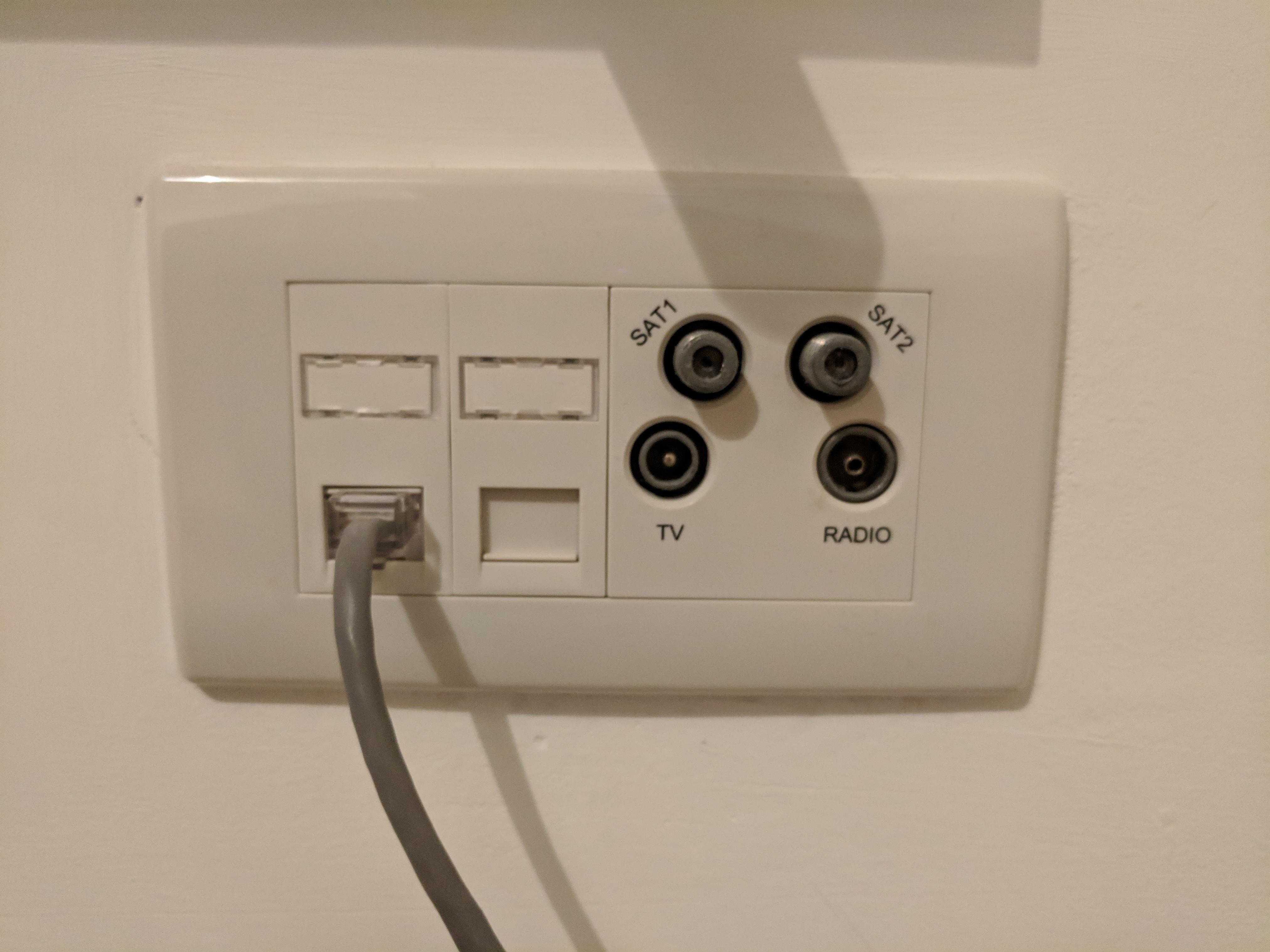

CC45 Posted October 31, 2018 Author Posted October 31, 2018 OK so I think this is the plan. Freesat dish + TV + FM / DAB mounted 2 feeds of Webro WF100 twin satellite - coax cable from the dish down to a cupboard under the stairs 1 feed of Webro WF100 twin from TV & FM / DAB down to cupboard under the stairs 1 feed of Webro WF100 twin taken to cupboard - spare just in case any are damaged Could I use this https://www.tlc-direct.co.uk/Products/CAPF2100BW.html rather than the Webro WF100? Just based on price really. Is there likely to be any difference in the real world? In cupboard: Multiswitch / loftbox From cupboard to each Sat / TV / FM / DAB point: Run 2 cables of Webro WF100 twin (or the TLC cable above maybe) to each point. 1 twin to feed sat outlet & 1 to feed TV & radio point. 2nd cable for future proofing. Triplex unit fitted I also thought of running two Cat 6 cables to each room from the cupboard - one for internet connection & the 2nd as a spare. If I did this then I'd use grid or quadruplex units. Does this all make sense? once again - thanks for any comments.
MrMagic Posted October 31, 2018 Posted October 31, 2018 (edited) From your cupboard out to your TV points I'd certainly recommend a twin feed of WF100 (or equiv) and a pair of cat6a cables. This is what I've done to each Tv point - I've put them in to a quad plate with 1 x SAT, 1 x SAT/TV/FM (using a quadplex outlet) and then two cat6a outlets (cat5e in my case). Quadplexer - https://www.screwfix.com/p/lap-tv-fm-2-satellite-quadruplex-grid-module-white/31768 Edit - for some reason I didn't read the earlier replies re tri/quad plexing. so yes, for SkyQ you will need some additional sat only sockets. I guess you may only need to do this to you main TV point as the other SkyQ boxes all link over wifi/powerline/ethernet so don't actually need the sat feeds. You're only going to do it once so perhaps put in more to future proof! Edited October 31, 2018 by MrMagic 1

Guest Alphonsox Posted October 31, 2018 Posted October 31, 2018 1 hour ago, CC45 said: Could I use this https://www.tlc-direct.co.uk/Products/CAPF2100BW.html rather than the Webro WF100? Just based on price really. Is there likely to be any difference in the real world? The more expensive cables use solid copper conductor and copper braiding in their construction. The cheaper cables use a copper coated steel core with a cheaper braid. For short runs there will be no difference (most of the country seems to be wired with this stuff) , for longer runs the DC resistance of the steel can cause issues. It's not clear from the technical description which type this TLC stuff is.
