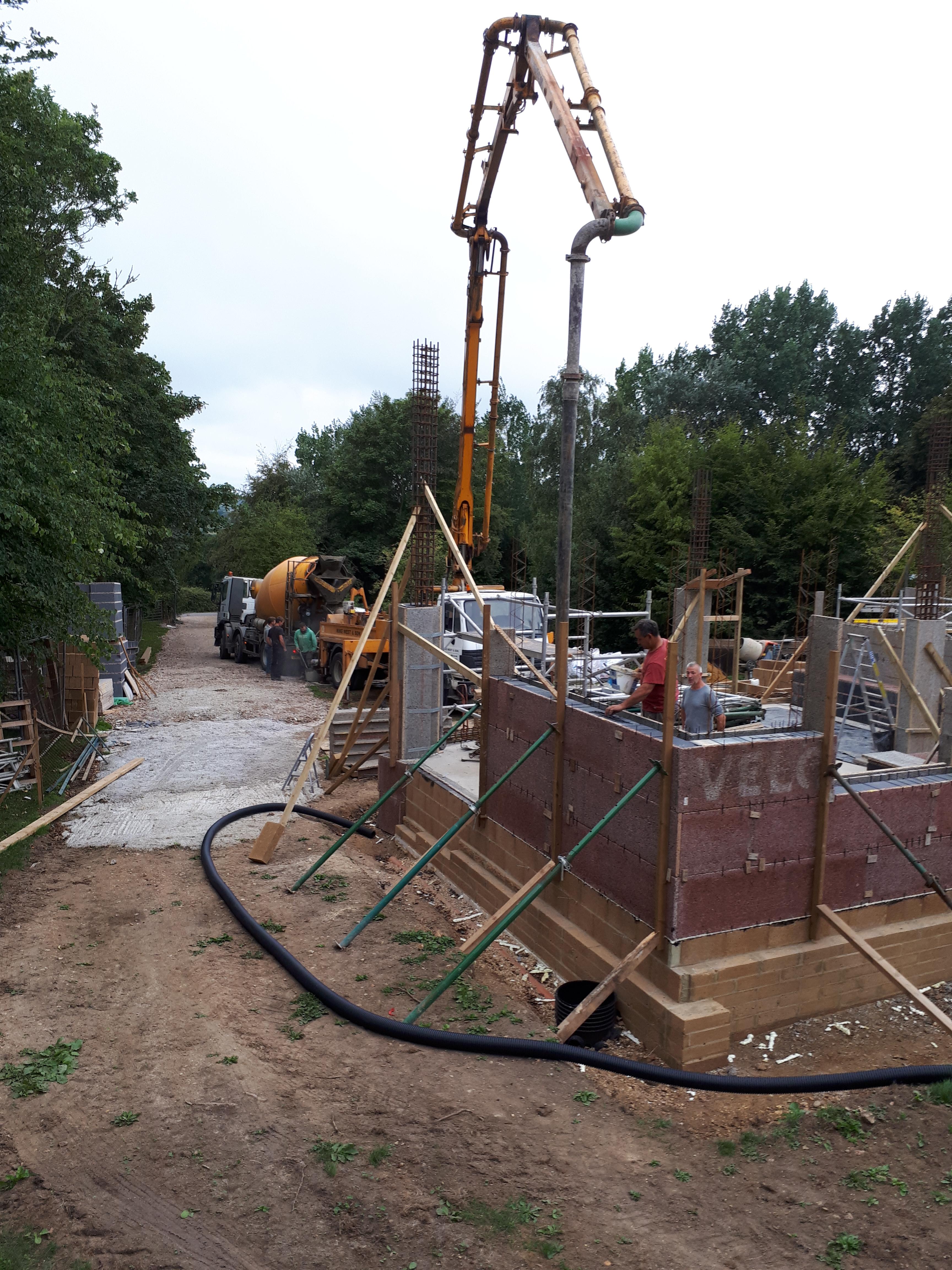

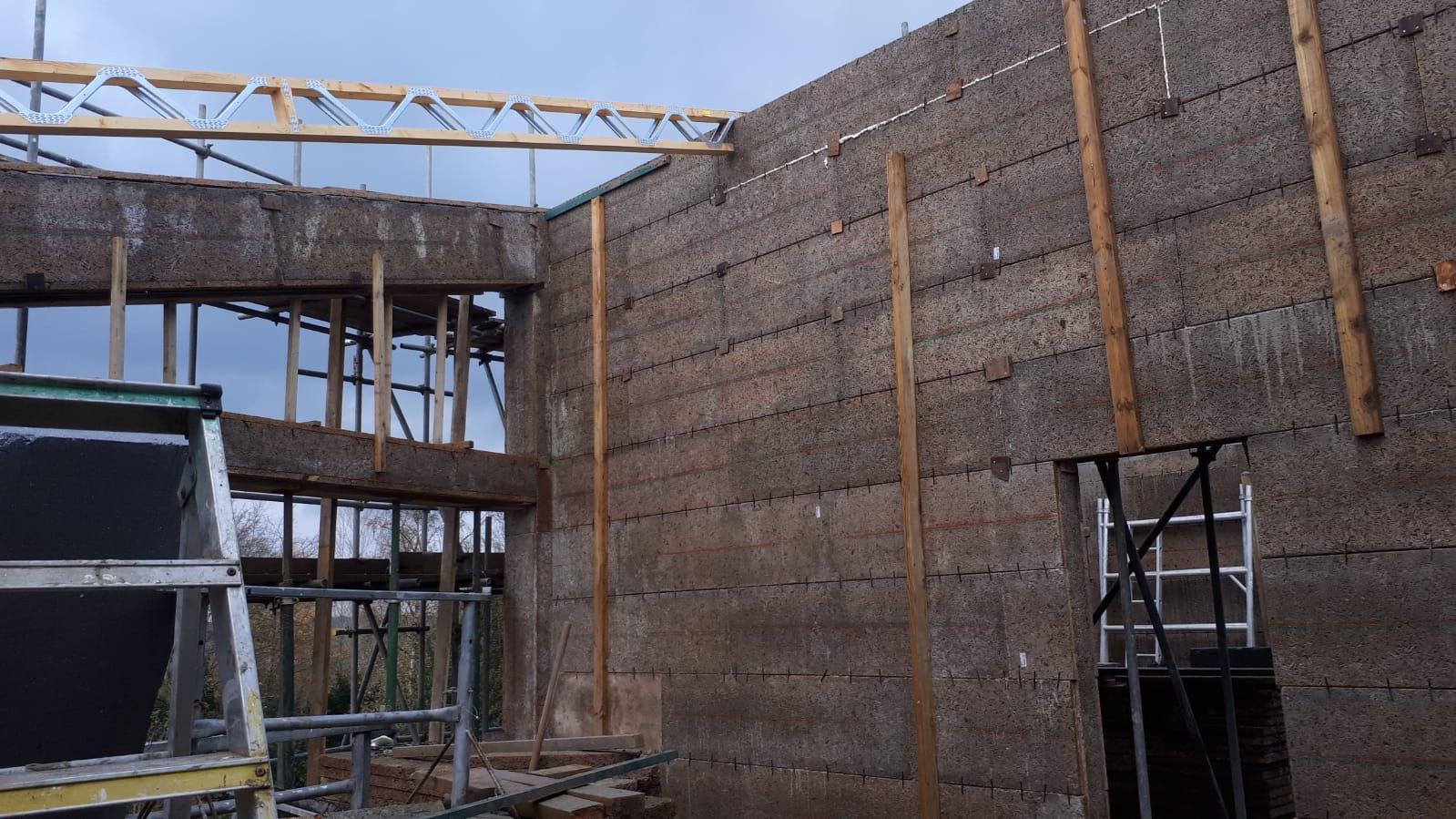

D Walter Posted October 29, 2018 Share Posted October 29, 2018 H Alexphd1, we used a mixture of timber bracing (vertical and diagonal) and also used some of our spare acrows. We have literally never had any spare time after a pour to check and correct as by the time you get round the walls the first sections poured are hardening. We have used electric and petrol driven pokers and no problems with them. As mentioned above, our only issue has been not having an appropriately sized concrete pump. Picture attached. Link to comment Share on other sites More sharing options...
Alexphd1 Posted October 29, 2018 Share Posted October 29, 2018 what was wrong with the pump? Link to comment Share on other sites More sharing options...

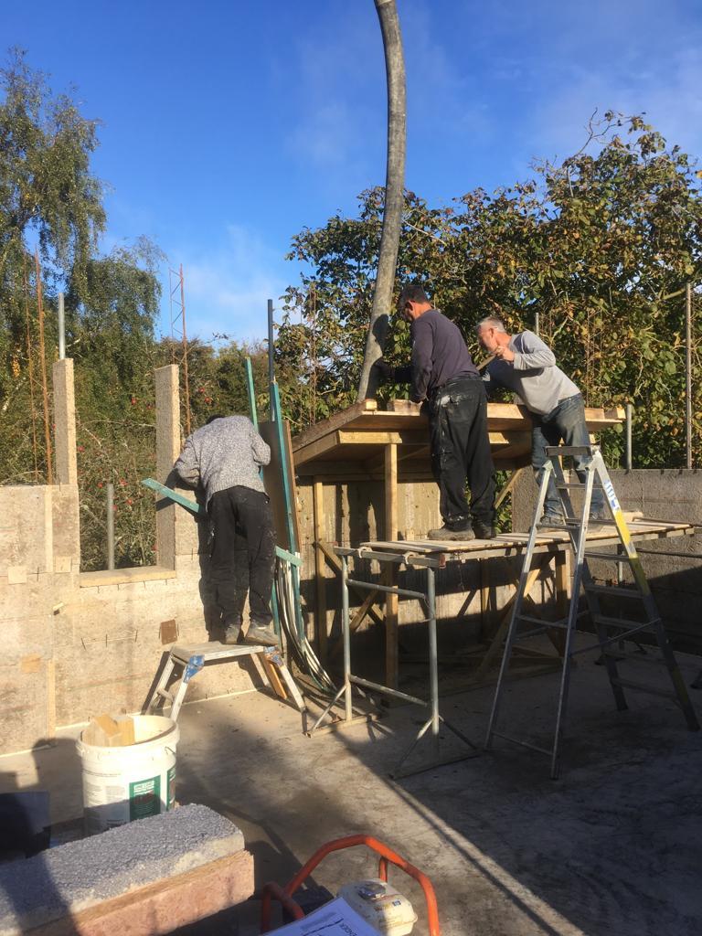

D Walter Posted October 29, 2018 Share Posted October 29, 2018 We could not get a small enough nozzle and could not get an even flow of concrete. The concrete came thumping out so we needed to pour onto a moveable shute to take some of the energy out. Link to comment Share on other sites More sharing options...
Alexphd1 Posted October 30, 2018 Share Posted October 30, 2018 (edited) Their is always something! Our icf supplier could supply us a nozzle branded a "mudsnake" but luckily the pump guys had a suitable nozzle (5 inch I think) We used 2 different pumps one for the icf walls and one for the slab. The second had a concrete shut of at the end of the boom, this made stopping and starting very easy. A tip for anybody else pouring icf walls! Edited October 30, 2018 by Alexphd1 Link to comment Share on other sites More sharing options...

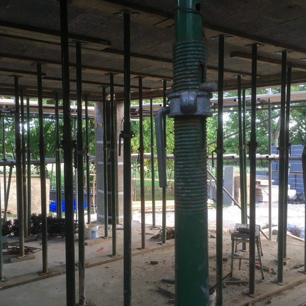

D Walter Posted December 5, 2018 Share Posted December 5, 2018 A further thought on the "swings and roundabouts" theme, if you are pouring an unsupported concrete floor (e.g. a first floor) you will need access to hundreds of acrows for in excess of a month to support the floor while it is curing (see pic). The acrows can also come in useful for bracing walls when pouring concrete and we purchased ours from a previous Velox builder introduced to us by Velox. We will sell the acrows on in turn when we have finished with them. An upside of the Velox floor is that we will be utilising the voids (195mm deep by 380mm wide across most of our spans) in the Velox first floor flooring modules to run the ground floor MVHR ducting. Link to comment Share on other sites More sharing options...
scottishjohn Posted December 6, 2018 Share Posted December 6, 2018 (edited) thank you for pctures == good help in decision making process I would like your acrow props but think you might be a bit far away --maybe i do it like the russians --lots of small tree trunks --plenty of them in sotland LOL but still got planning to get sorted yet -- to convince then to allow more than a typical long 1 storey crofters cottage on the 1 acre site --they just crazy could be going down the VELOX way - and maybe a basement-plot has lots of slope on it Edited December 6, 2018 by scottishjohn Link to comment Share on other sites More sharing options...

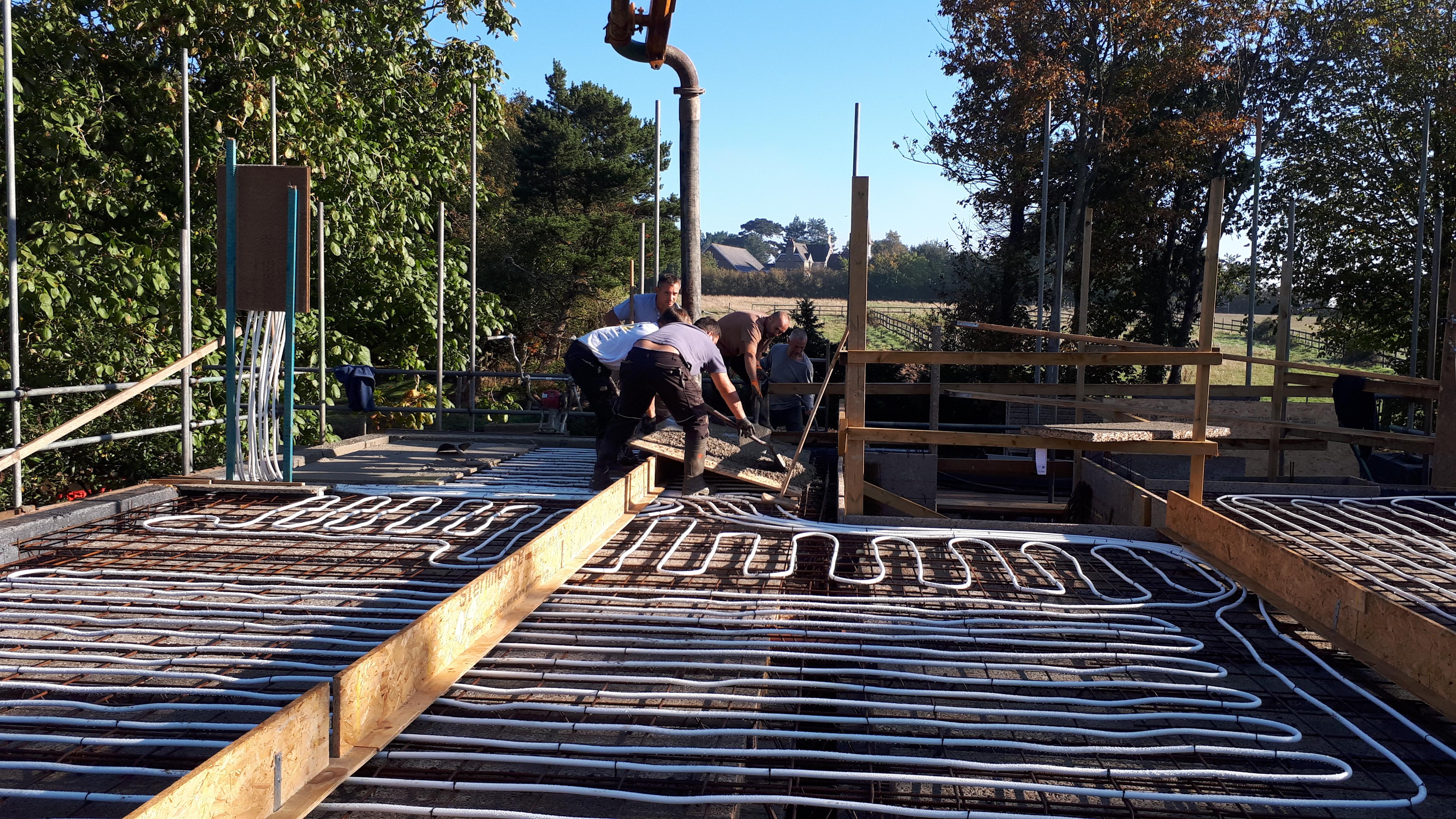

dzhou11 Posted December 13, 2018 Share Posted December 13, 2018 Hi @D Walter I can see you're using velox's floor system. Can you put UFH pipes directly into the concrete? Link to comment Share on other sites More sharing options...
D Walter Posted December 14, 2018 Share Posted December 14, 2018 Yes, ours is directly in the concrete and that is recommended (see pic attached). Given that it means that there will be no self levelling screed, real attention is needed to get the concrete as level as possible. The whole system also needs a good bit of time and attention to get it all set up in advance. 1 Link to comment Share on other sites More sharing options...
D Walter Posted December 14, 2018 Share Posted December 14, 2018 The above pic may be of interest as it shows a) how we divided the flooring so we could pour, level and power float a section of flooring at a time, and b) shovelling concrete from an OSB sheet into the wall void as our pump was too brutal to pour directly into the void. The attached pic shows the moveable platform we used for pouring concrete into the wall void, again because of the wrongly spec'd pump. 2 Link to comment Share on other sites More sharing options...
