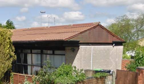

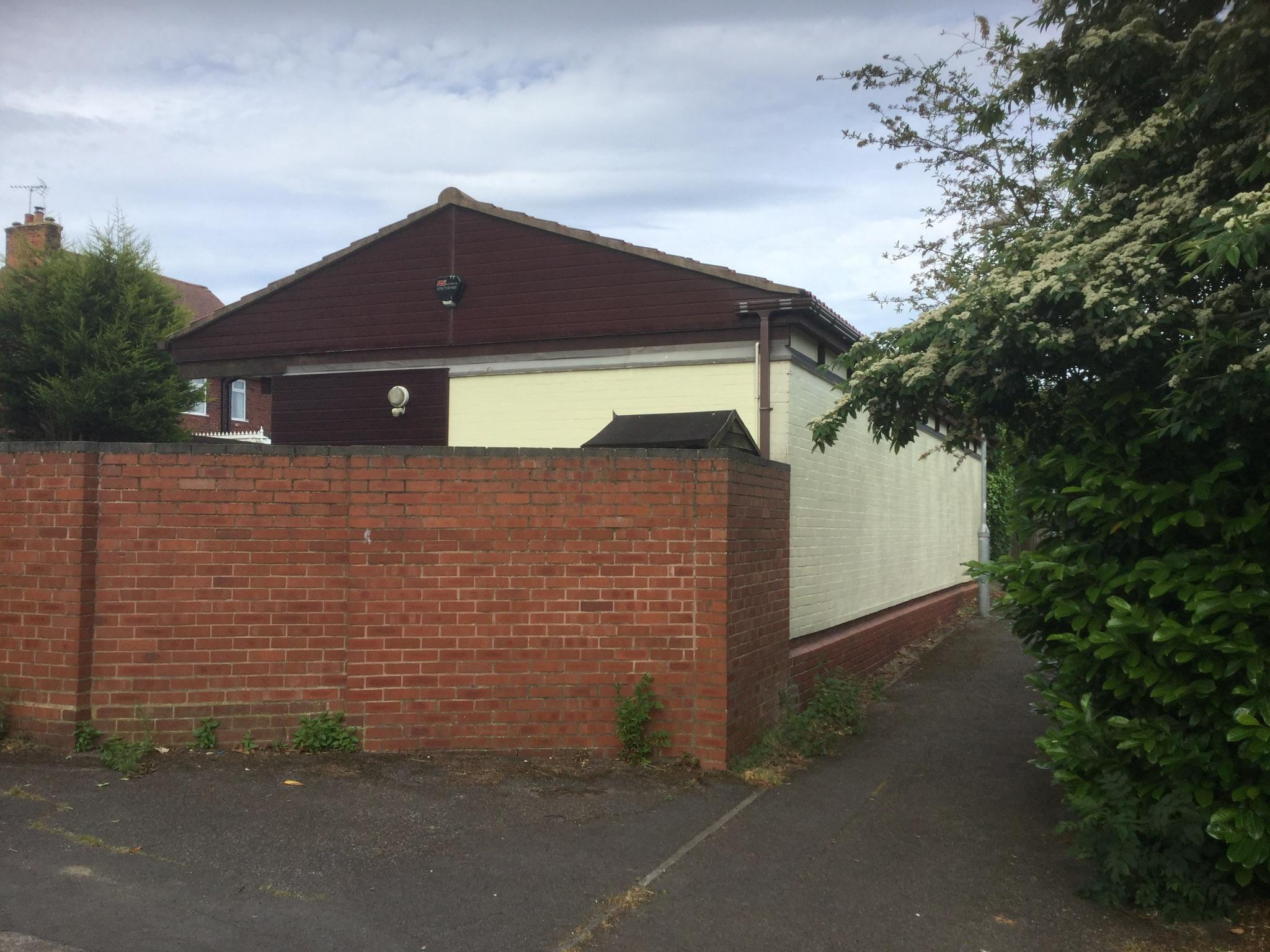

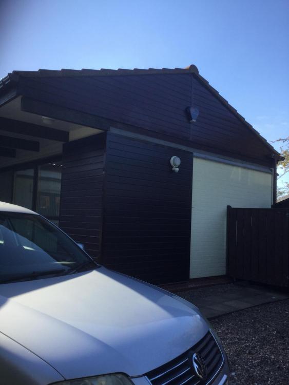

Ferdinand Posted October 12, 2018 Share Posted October 12, 2018 Here you go, two pics. Scruffy, white brick wall after 40 years After restoration, painting and anti-vandal paint. now on a 5-6 year painting cycle. 1 Link to comment Share on other sites More sharing options...

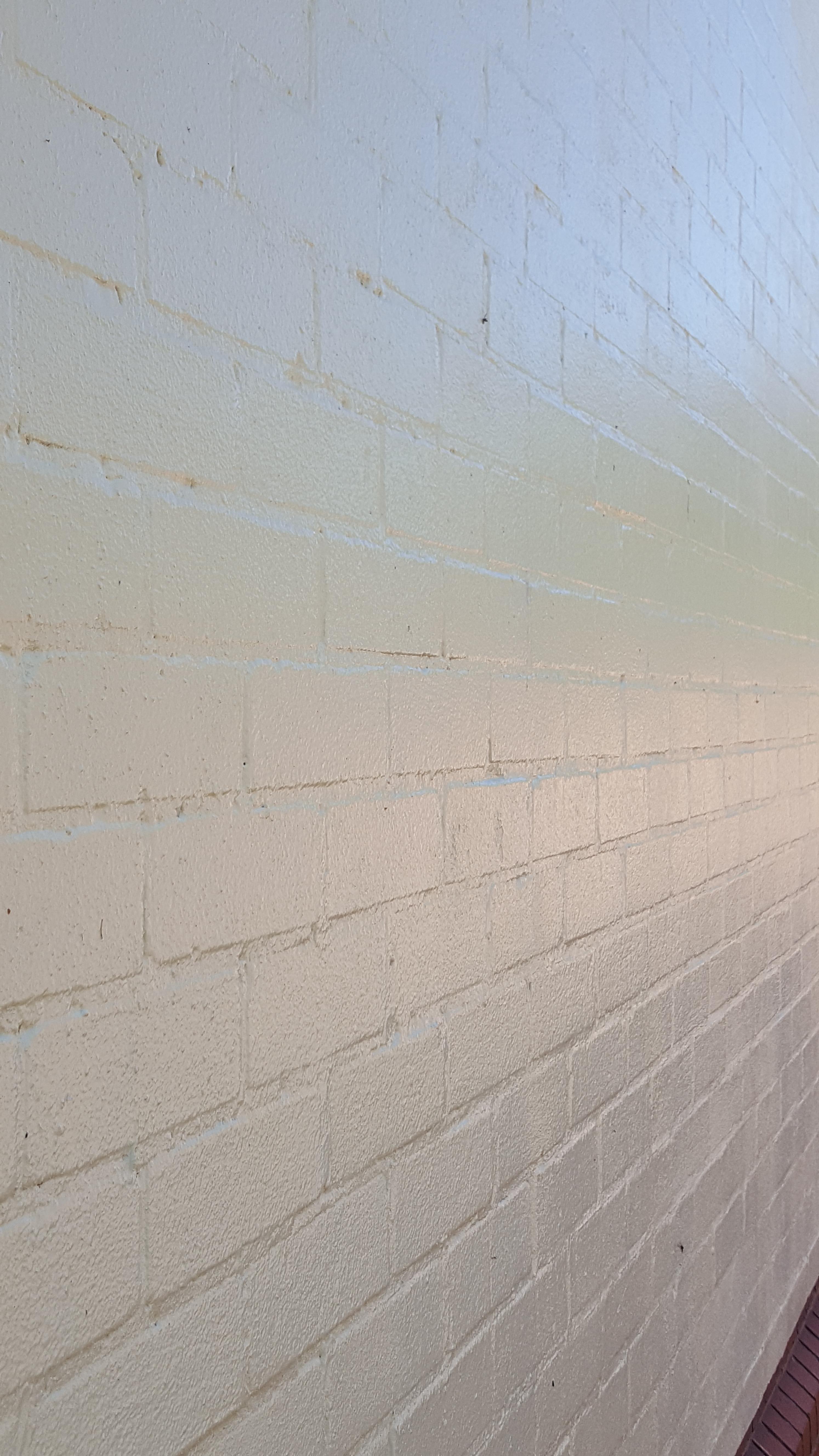

Sjk Posted October 12, 2018 Author Share Posted October 12, 2018 (edited) Thanks Ferdinand, really useful. I didnt realise white brick had been used for such projects before. If paint was to soak into the brick, that would be devastating, the ones I have seen have a low water absorption rate, so maybe more hardy to staining etc? Had a wander around and this is aprx 194X house, the brick is very similar to your fathers. Edited February 17, 2020 by Sjk Link to comment Share on other sites More sharing options...

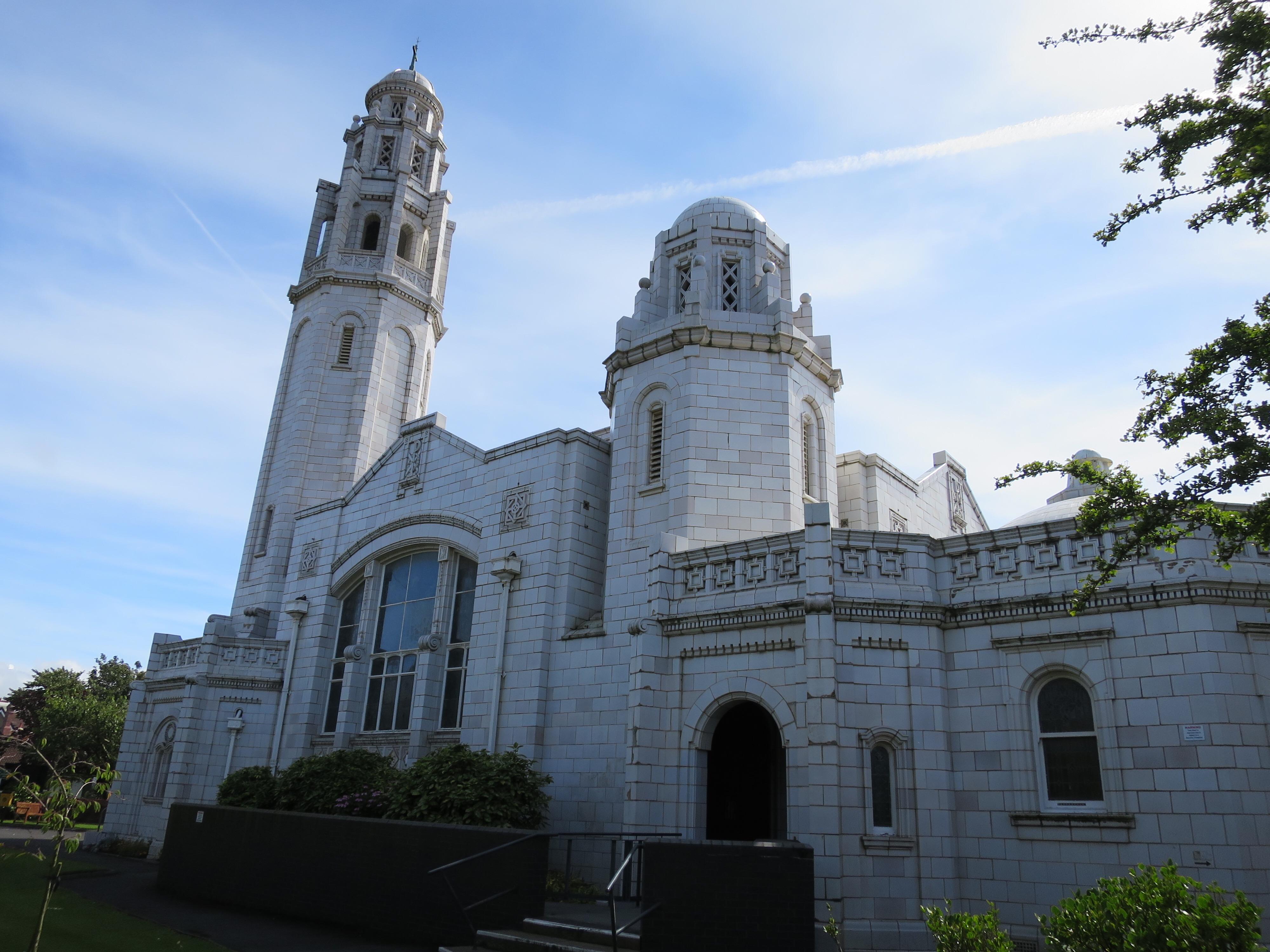

Triassic Posted October 12, 2018 Share Posted October 12, 2018 (edited) How about something like this, The White Curch, Lytham, constructed using white faience bricks. http://fairhavenurc.org.uk/ Edited October 13, 2018 by Triassic Link to comment Share on other sites More sharing options...
Ferdinand Posted October 13, 2018 Share Posted October 13, 2018 (edited) On 12/10/2018 at 20:28, Hecateh said: That second wall looks like the interior of our school outside toilet block when I was a kid Expand That is the sheen from an anti-graffiti product which means graffiti can be power washed off and then just repainted with the product. That prevents any graffiti being absorbed. That wall backs into a public footpath between backs of gardens which is not overlooked, and has been graffitied twice that I can remember. Ferdinand Edited October 13, 2018 by Ferdinand 1 Link to comment Share on other sites More sharing options...

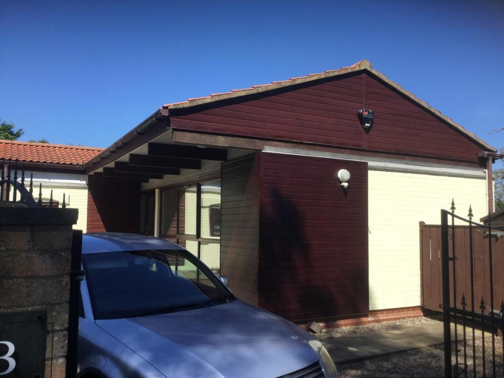

Ferdinand Posted October 13, 2018 Share Posted October 13, 2018 (edited) On 12/10/2018 at 20:43, Sjk said: Thanks Ferdinand, really useful. I didnt realise white brick had been used for such projects before. If paint was to soak into the brick, that would be devastating, the ones I have seen have a low water absorption rate, so maybe more hardy to staining etc? Had a wander around and this is aprx 194X house, the brick is very similar to your fathers. Expand A couple of photos post restoration and a maintaince cycle this summer, where we repainted completely and changed a few details that were not quite right from the 2010 restoration.The 2010 restoration was done to the roof off floors up new drains level. The new paint was done this summer, which is actually an 8 year cycle. The cladding has been where the paint from the 2010 restoration was weathering badly eg where the wind whipped round that front corner and the overhang finishes. Now it is sharp again. Everywhere not covered had paint that was still pristine, so hopefully repainting can be once every 10 or 12 years now. As you can see that back wall *could* be a graffiti magnet, but it is an ok area so we have only had 2 occurrences in 20 years. As I say detailing is critical, especially concerning runoff and staining, and would have a long term strategy to allow for a new finish in a few decades, which will also affect design details. As I say, consider gloss surface bricks which will last a century or more in pristine condition .. see London Tube Stations for example. But please so something interesting. This in white brick was dad experimenting when he was about 32. Still have a dozen of the original bricks which are for maintenance should they ever be needed. Make it pleasingly different to all the others. Bugger fashion and things inspired by Tracey Island. Ferdinand Edited October 13, 2018 by Ferdinand Link to comment Share on other sites More sharing options...

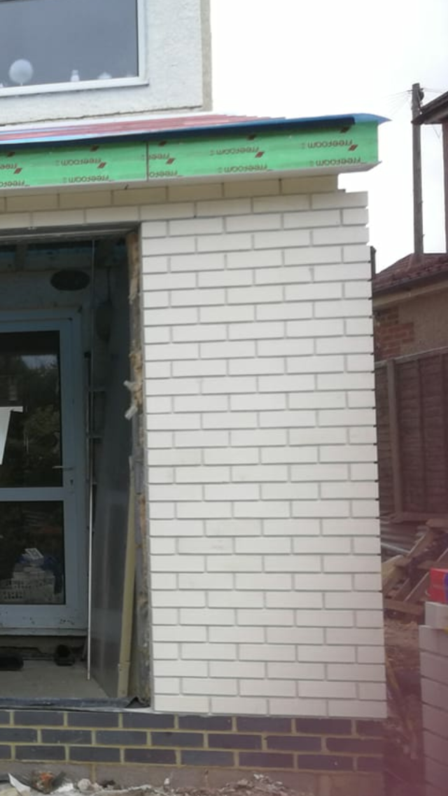

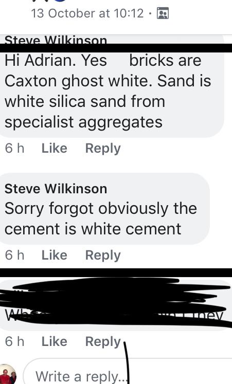

Brickie Posted October 14, 2018 Share Posted October 14, 2018 From a bricklayers social media group I’m in. If you like the look of it I can ask the OP for info on the bricks & mortar. Link to comment Share on other sites More sharing options...

Sjk Posted October 17, 2018 Author Share Posted October 17, 2018 Thanks chaps.? Brickie yeah please if you can get the spec Link to comment Share on other sites More sharing options...
Brickie Posted October 21, 2018 Share Posted October 21, 2018 On 16/10/2018 at 10:29, the_r_sole said: I'd like those details if possible, always good to know what's going on site rather than what you put in a spec! cheers Expand 2 Link to comment Share on other sites More sharing options...
