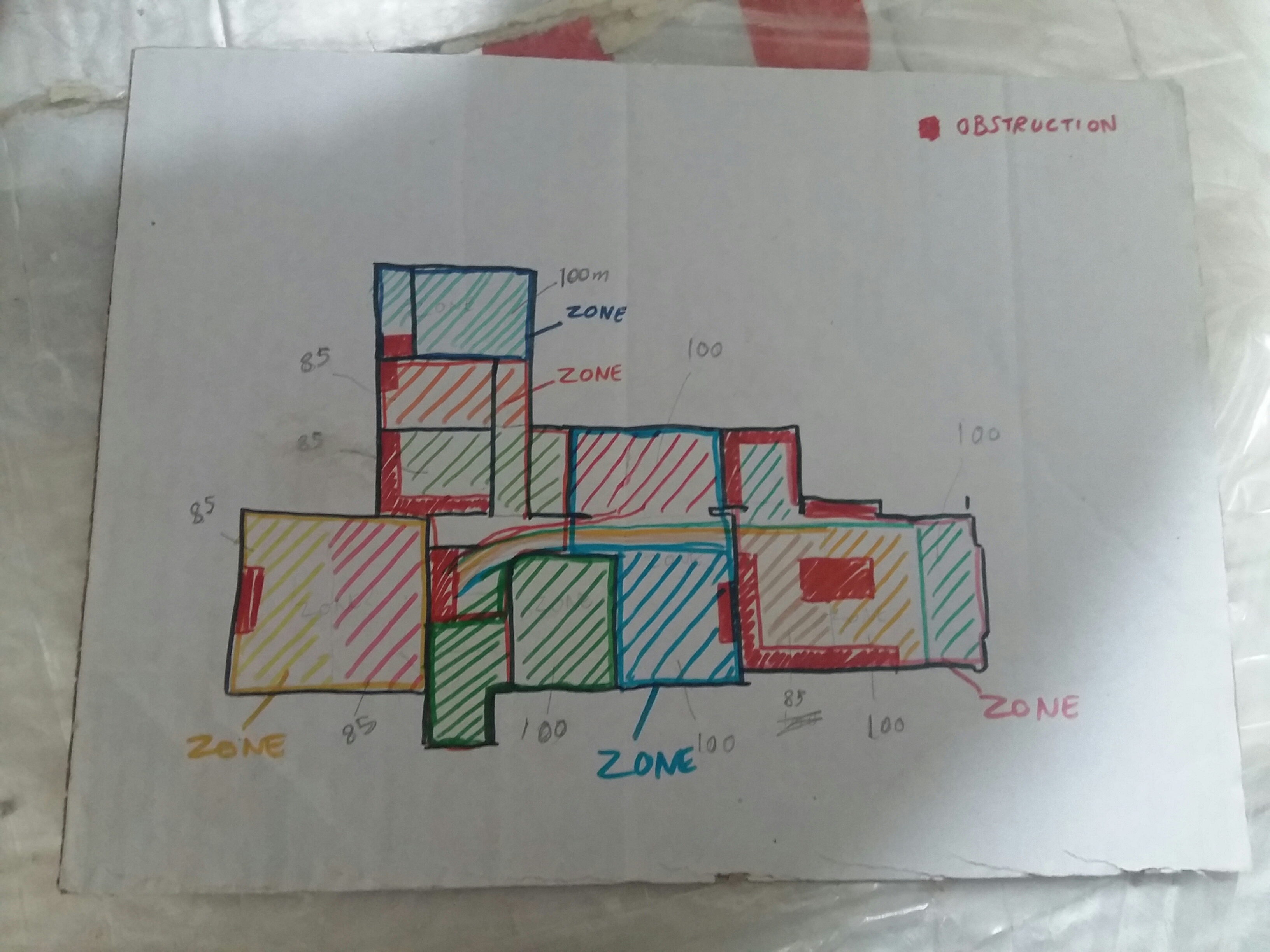

slidersx200 Posted July 27, 2016 Author Share Posted July 27, 2016 Thanks @Nickfromwales, I've not had any response yet. My plumber and I have roughly worked out a way to supply all rooms without the need for any pipes crossing over and now just need to accurately measure out the loops to see if it will work with the materials we've been supplied. Link to comment Share on other sites More sharing options...
Nickfromwales Posted July 27, 2016 Share Posted July 27, 2016 Are the design loop lengths in excess of the coils supplied? Link to comment Share on other sites More sharing options...
slidersx200 Posted July 27, 2016 Author Share Posted July 27, 2016 (edited) I received six 100m lengths and five 85m lengths, which means I also have eleven rolls for thirteen circuits. Edited July 27, 2016 by slidersx200 Link to comment Share on other sites More sharing options...

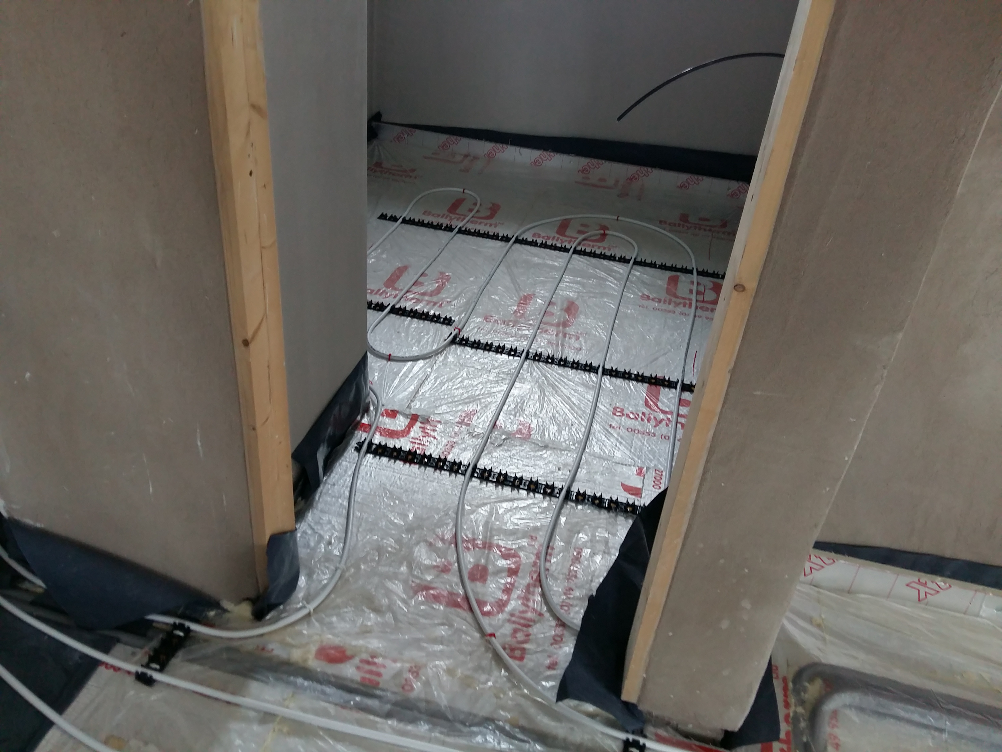

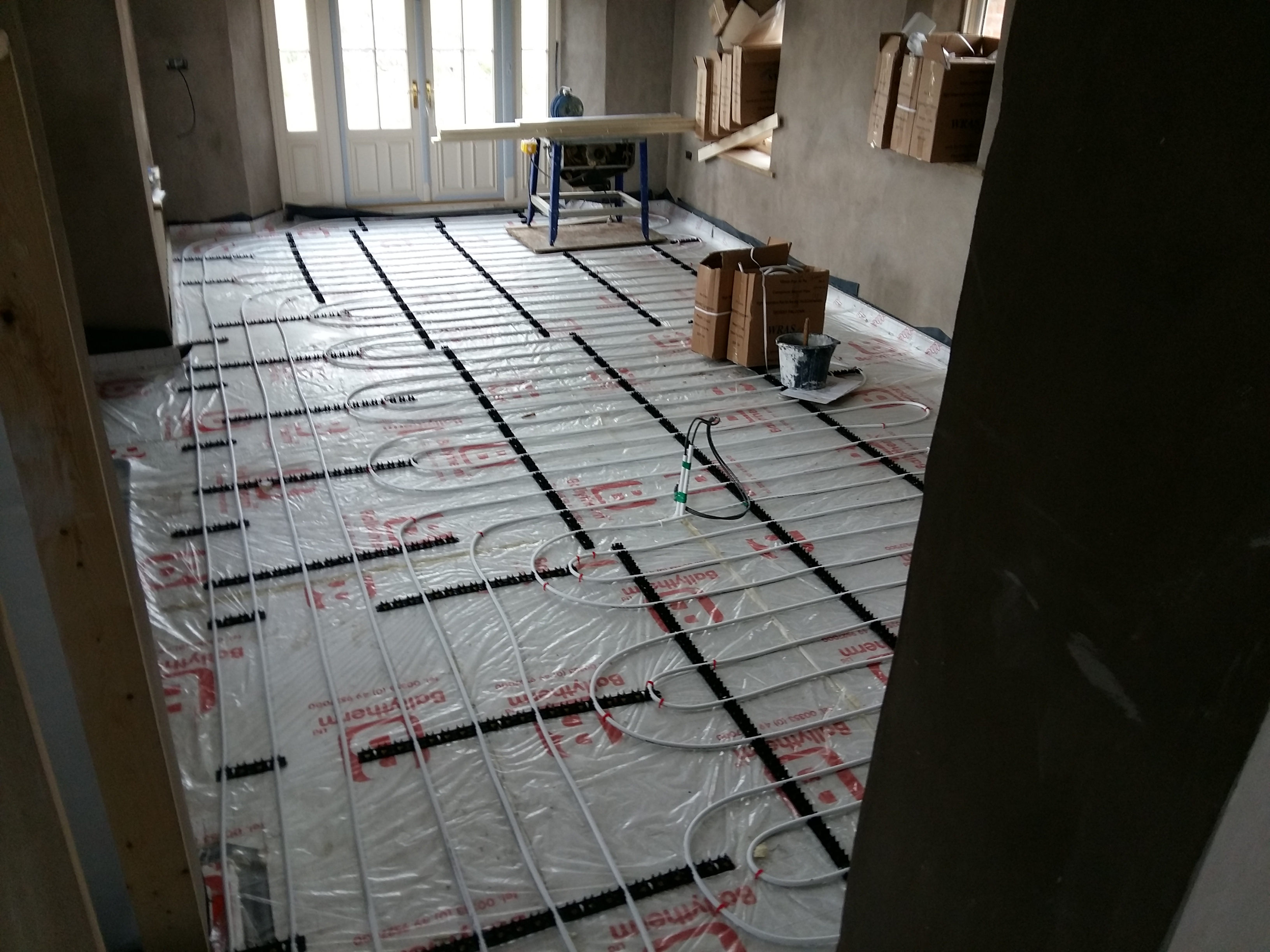

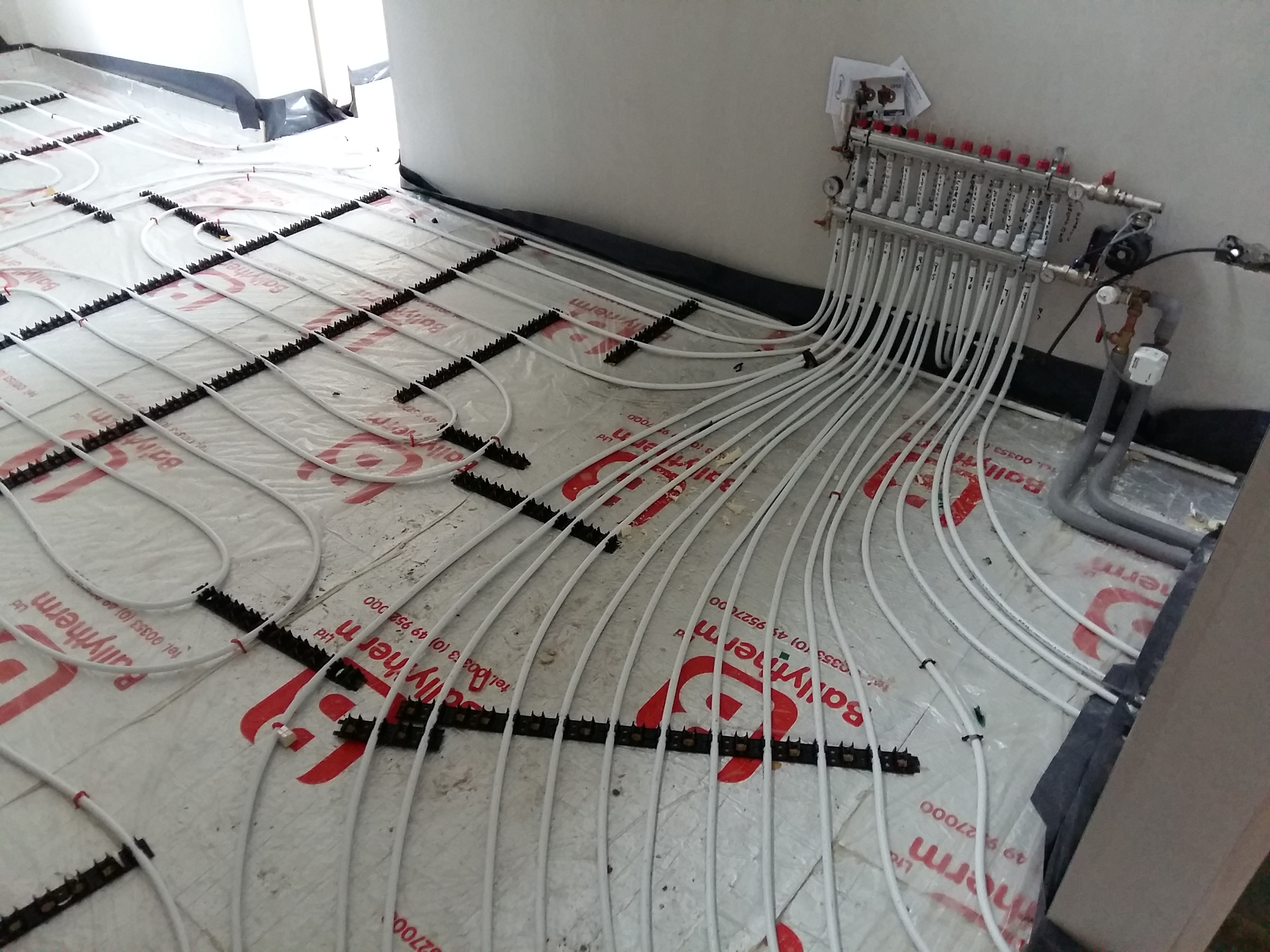

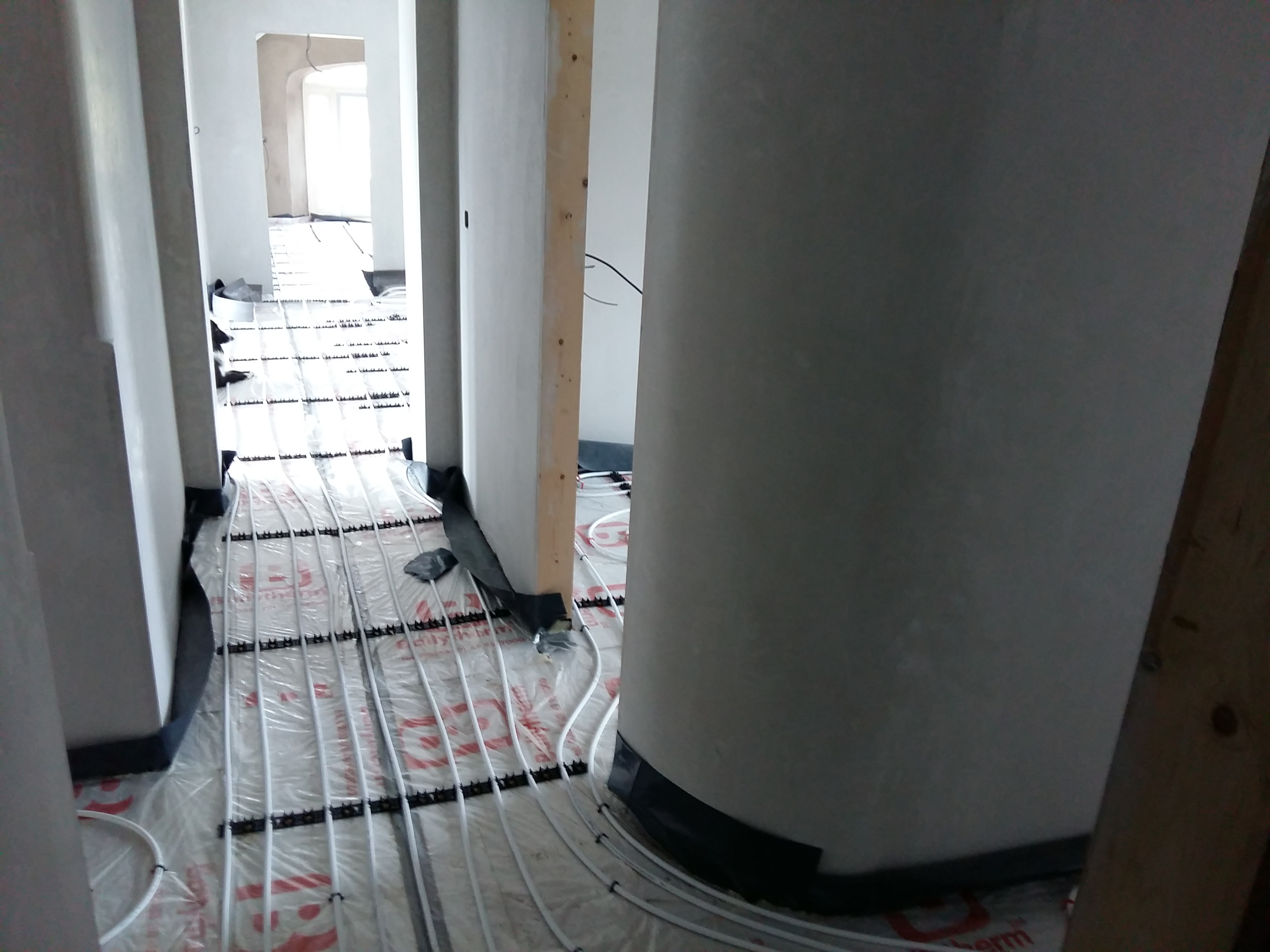

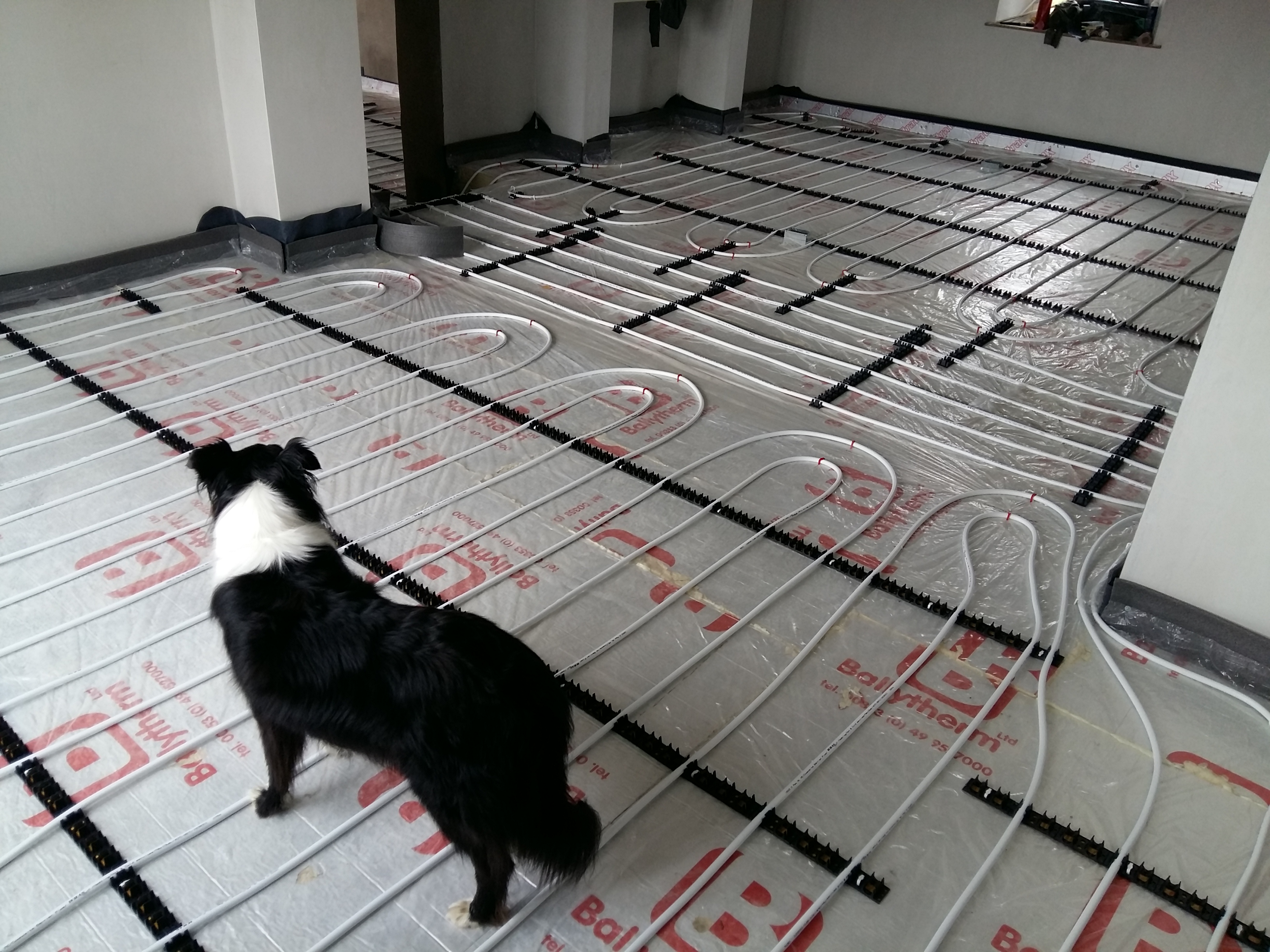

slidersx200 Posted August 3, 2016 Author Share Posted August 3, 2016 (edited) Half the battle is now done as the install was completed today and successfully tested to 6 bar, which just leaves the matter of some sort of recompense to hopefully be worked out with the supplier. I roughly worked out the layout in terms of zones (as defined by the room stats), areas covered by a length of pipe and estimated length of pipe required for each loop (either 85 or 100m based on the goods we received). Here is the "plan" I created: The plumber was then responsible for how he laid the pipes on the floor and not only managed to create a layout that places each flow and return adjacent to each other, but did so without one solitary pipe being crossed by another. We also kept all loops under 100m, therefore avoiding the need for any joints, have the correct pipe density in the hallways and included the pantry within one of the loops to the kitchen. I think our achievements make a total farce of the design I paid for and everything that was said in its defence by the supplier. Under stair manifolds in the hallway Two pipes detour out of the hallway before the pinch point at the far end In the Living Room and Formal Dining Area we managed to avoid the need for any pipes to cross The Kitchen is served by three circuits One of which also serves the Pantry at increased centres Edited August 3, 2016 by slidersx200 2 Link to comment Share on other sites More sharing options...
jack Posted August 3, 2016 Share Posted August 3, 2016 Well done. The price you paid should have gotten you a highly competent piece of design work (the cost was more than a full day's work for most trades, even in the south east). Stick to your guns and let us know how you get on. 1 Link to comment Share on other sites More sharing options...
