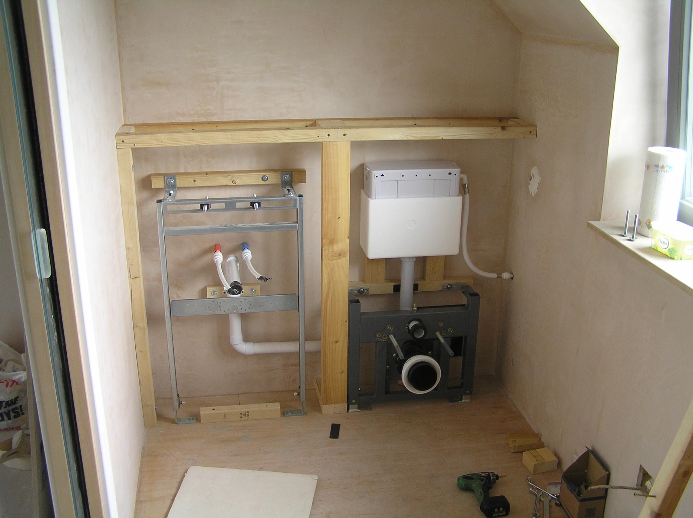

Onoff Posted September 29, 2018 Share Posted September 29, 2018 I've a 4"x2" dwarf wall with a bit of 6"x2" inlet to bolt/screw the sink to: Link to comment Share on other sites More sharing options...

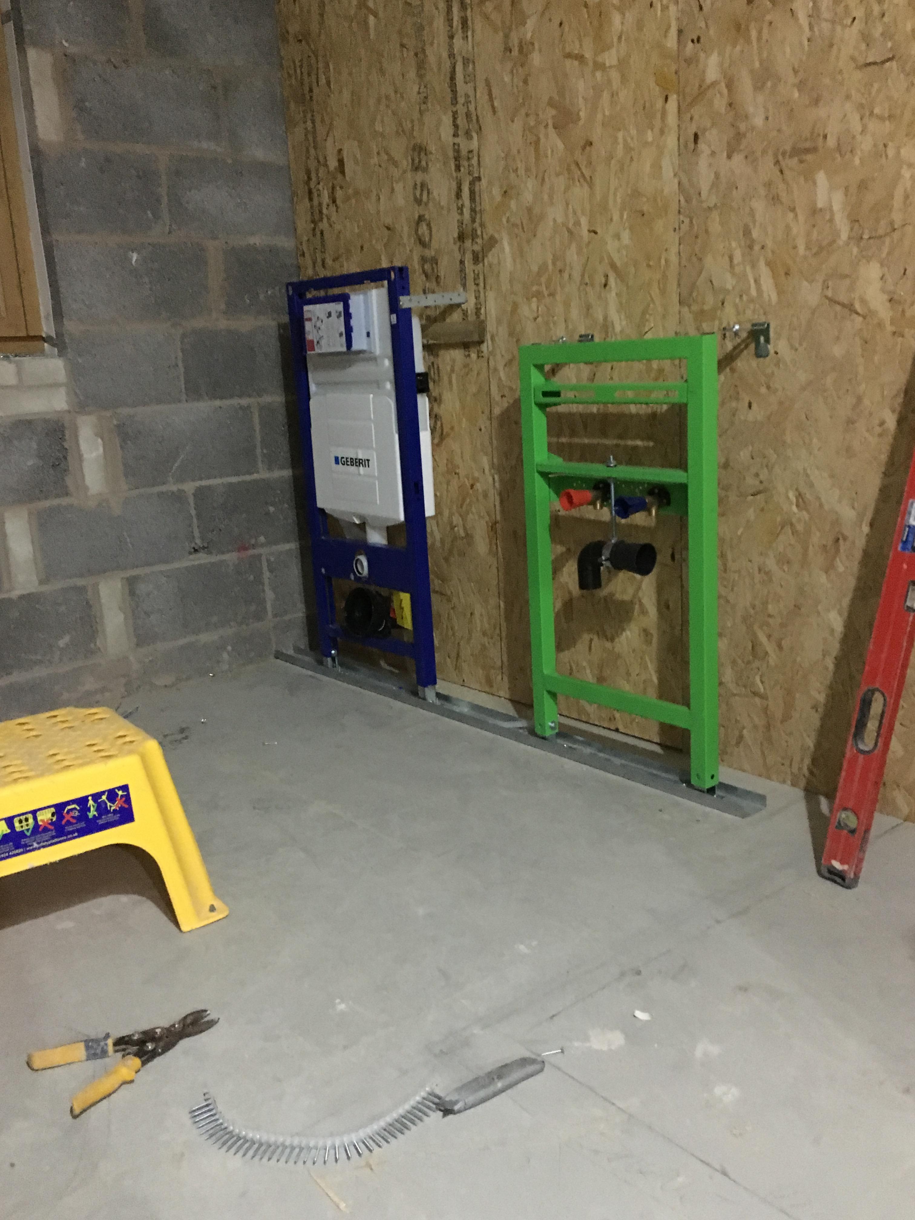

Gone West Posted September 30, 2018 Share Posted September 30, 2018 I used frames for two of my basins and for the other basin I used a Fischer fixing kit screwed into a strengthened area of stud wall. https://www.toolstation.com/shop/Screws+%26+Fixings/d90/Fixing+Packs/sd3310/Fischer+Wash+Basin+Fixing+Kit/p86297 Link to comment Share on other sites More sharing options...

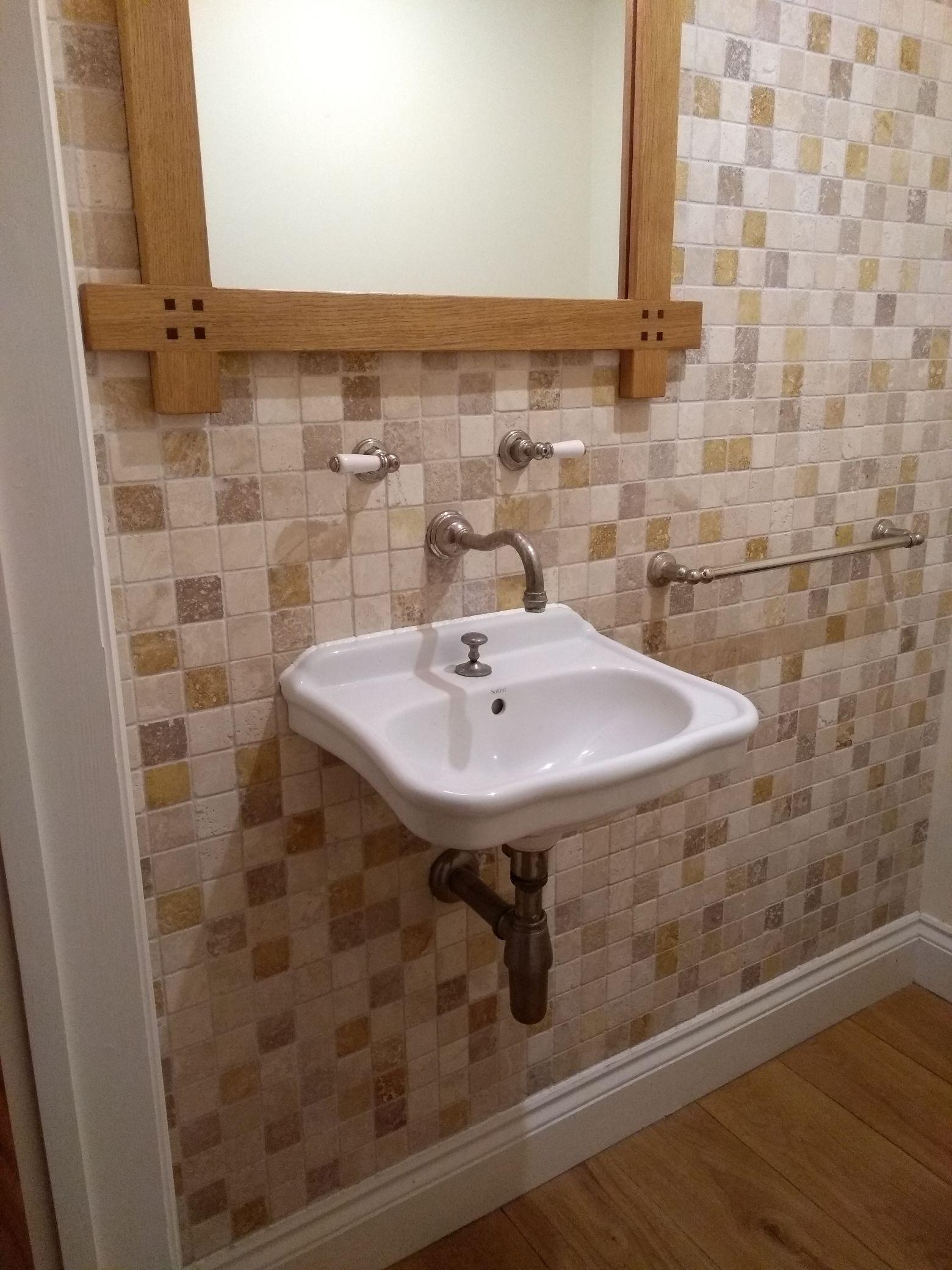

Temp Posted October 1, 2018 Share Posted October 1, 2018 We have a wall mounted basin in our WC. I think this one is discontinued and perhaps too shallow front to back for an ensuite anyway. It's bolted to a block wall but would be ok on a suitably reinforced stud wall. Deeper basins are available with brackets to provide additional support. Link to comment Share on other sites More sharing options...
