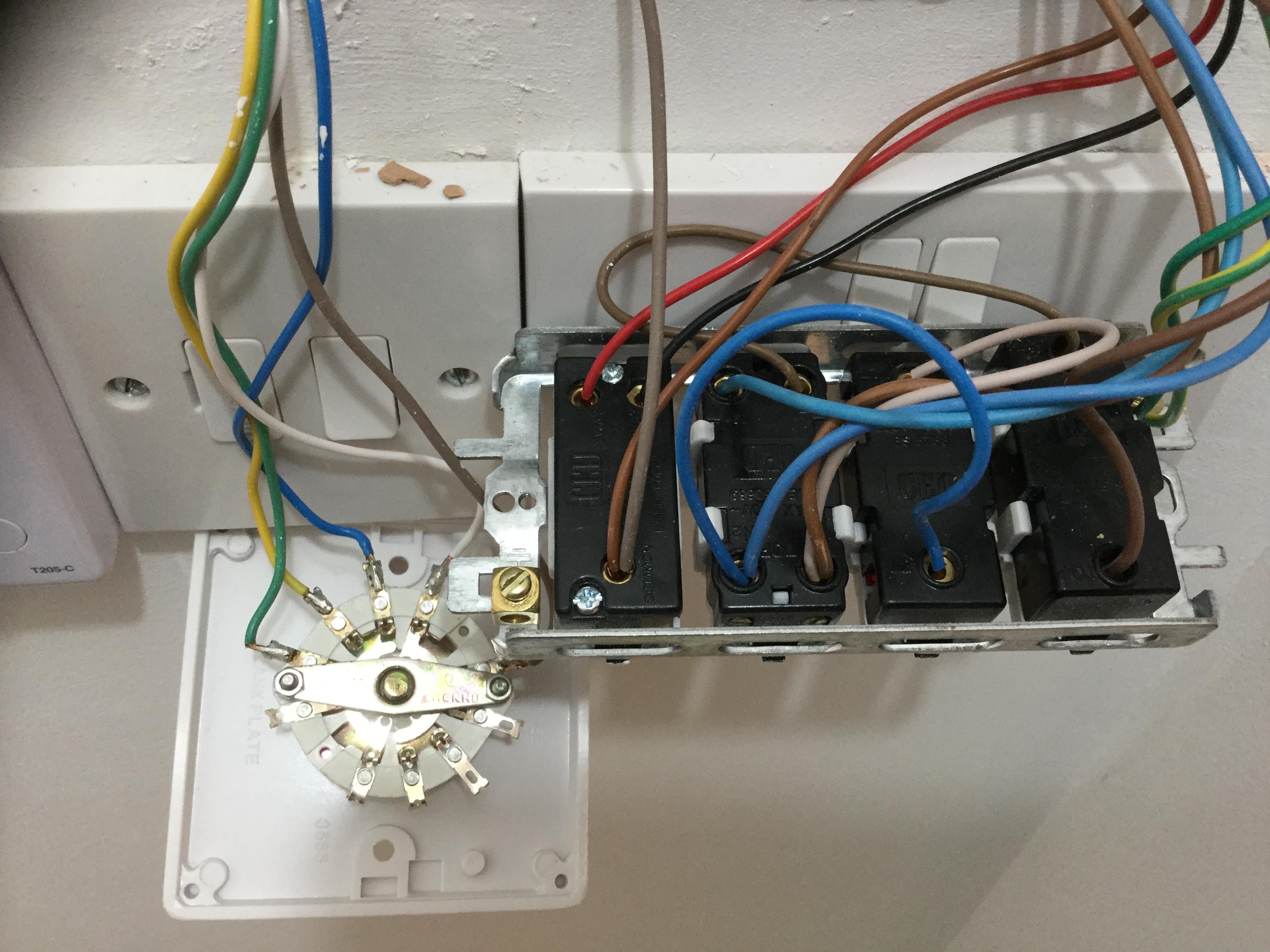

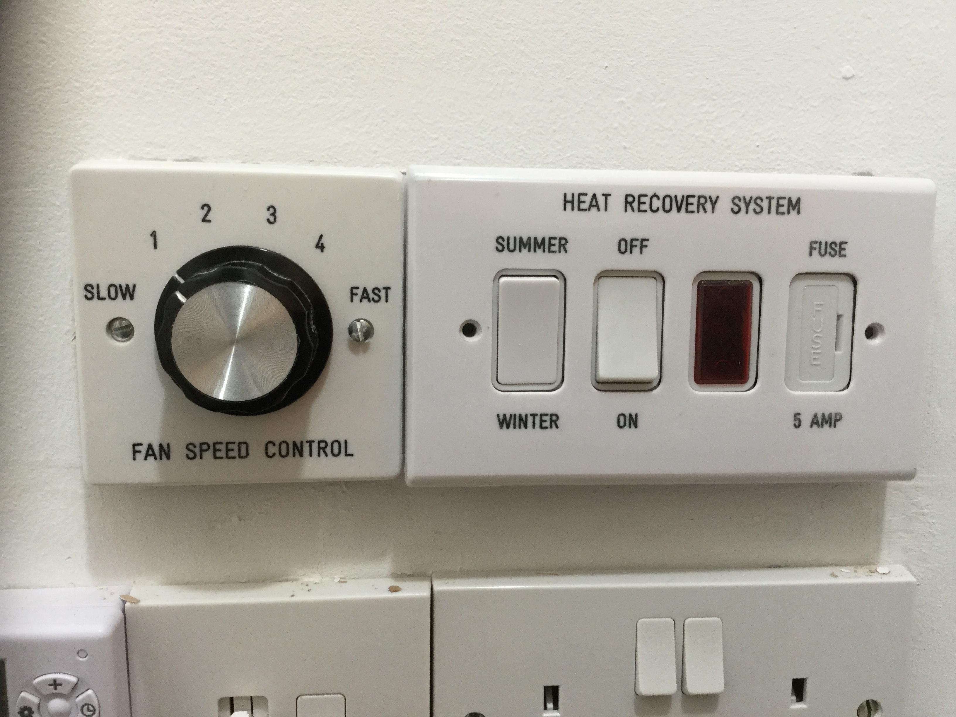

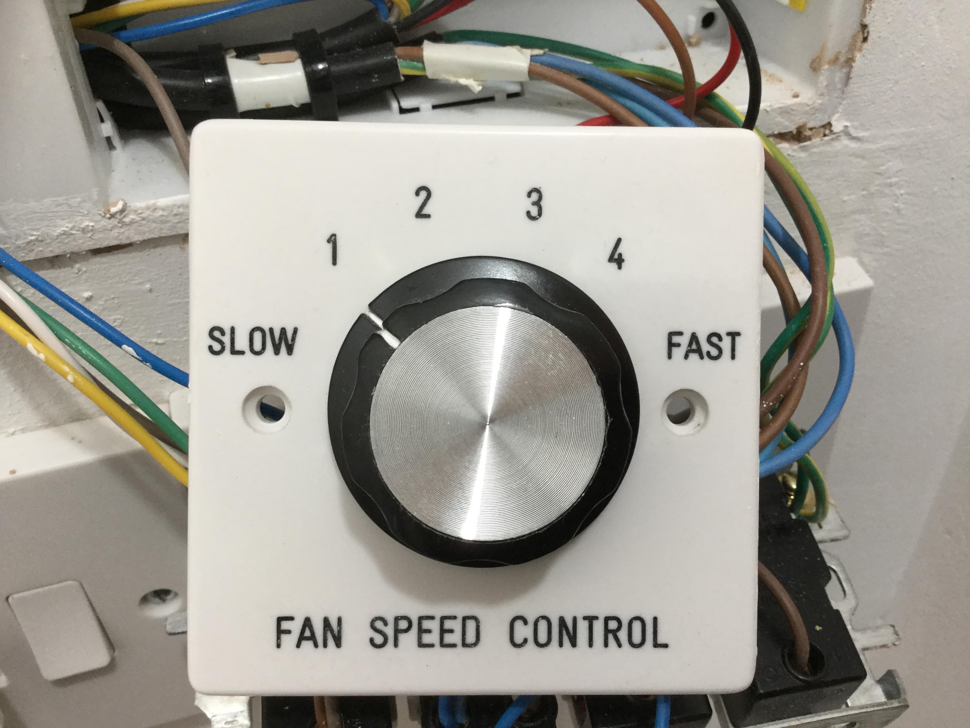

Thanks a lot for this info Dave, I think I bought the last controller on Ebay (sorry) but only just found that the wiring diagram did not come with it, I presumed the MVHR unit docs would have t but no!. Interesting that my controller shows 1 as slowest and 4 as fastest?
Out of interest how much was that controller?  Is it literally just a 4 position switch or are there any electronics associated with it?
Can I see the business end of it (i.e the wiring on the back of it)?
Here you go, yes the common for the speed control is teed to the com of the “summer-winter” switch. I didn’t think but I could have sent this before to help you ?.
I would guess they intend the "summer / winter" switch to connect to the "heat" and "cool" terminals. But there is no explanation of the control algorithm to open and close the bypass flap, and I dislike not knowing how things work.
Ha, got it working ? however, you are right Dave, speed 1 is fast and 4 is slow ????, I am going to reverse wire it as that defies logic. Thanks a lot mate.
Yup, all up and working, whisper quiet on 1 and blowing a gale on 4!  Even 2 is quite powerful. I have not balanced the system yet just restricted the close room pipes a bit at the manifold. I also have to wire in a humidistat with a relay as this is the way I wanted to control bathroom steam etc (wish I had thought to wire a boost button in the kitchen like Dave.
