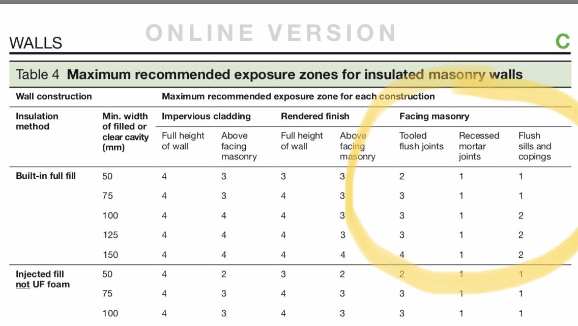

@squealeyhealey
even in an area of high exposure to driving rain a full-fill 300mm cavity would be okay as long as you use flush tooled joints in the facing masonry wall.
Part C of the Building regs guidance only goes up to 150mm full fill cavity but it shows it’s okay with even zone 4 max exposure sites.
