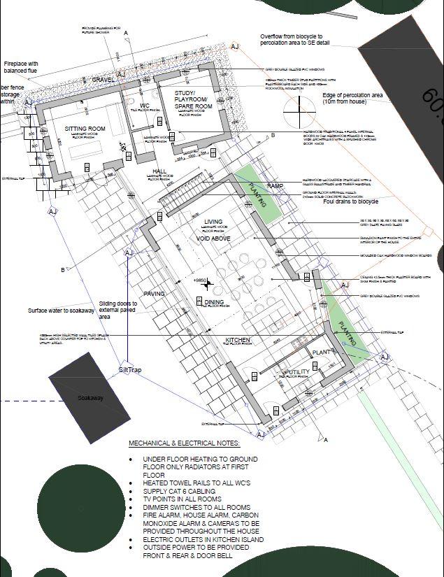

newhousebuild Posted September 20, 2018 Share Posted September 20, 2018 Hi, I have been staring at these plans for 3 years now and I need some fresh eyes to see if I am missing something glaringly obvious that needs to change before we break ground. Any advice appreciated. I already have a thread about the en suite bathroom issue which I think could be fixed - https://forum.buildhub.org.uk/topic/7108-some-design-advice-please-for-a-master-bedroom-thats-just-a-bit-off/ The slider will be a 4 pane slider not bi fold as shown. Thanks, B Link to comment Share on other sites More sharing options...

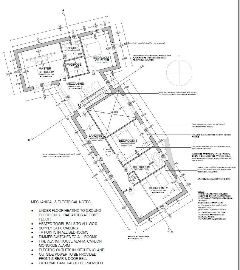

MikeSharp01 Posted September 20, 2018 Share Posted September 20, 2018 Two things jump out at me really. First is the sitting room / WC ratio / layout. I would push the wall across and squeeze the WC and its anti room to make the sitting room a bit bigger a small WC could still be accessible to a disabled user and you will appreciate the space in the sitting room also here you have the WC on the opposite side of the room to that in the ensuite above it so making the foul pipe run more complex than it needs to be. Secondly I am not clear what the 1m gap behind the bed in the master bedroom is for. 1 Link to comment Share on other sites More sharing options...
newhousebuild Posted September 20, 2018 Author Share Posted September 20, 2018 Hi mike, Thanks for that. The space behind the bed is for additional wardrobe space but this is still up in the air. Thanks, B Link to comment Share on other sites More sharing options...
ProDave Posted September 20, 2018 Share Posted September 20, 2018 No Garage / workshop space? Link to comment Share on other sites More sharing options...
newhousebuild Posted September 20, 2018 Author Share Posted September 20, 2018 The main worktop space will be the island. Its going to be another 2 foot longer than in those plans with the sink in the island. No garage at the moment no. Link to comment Share on other sites More sharing options...
recoveringbuilder Posted September 20, 2018 Share Posted September 20, 2018 I wouldn’t put the sink in the island, we did that in our last house and hated it 1 Link to comment Share on other sites More sharing options...
newhousebuild Posted September 20, 2018 Author Share Posted September 20, 2018 Ok, was it just messy with pots etc drying? Link to comment Share on other sites More sharing options...
recoveringbuilder Posted September 20, 2018 Share Posted September 20, 2018 Yes I ended up using the dishwasher all the time, it was a granite work surface and was forever needing polished with splashes , just not practical 1 Link to comment Share on other sites More sharing options...
Ferdinand Posted September 20, 2018 Share Posted September 20, 2018 4 hours ago, MikeSharp01 said: Two things jump out at me really. First is the sitting room / WC ratio / layout. I would push the wall across and squeeze the WC and its anti room to make the sitting room a bit bigger a small WC could still be accessible to a disabled user and you will appreciate the space in the sitting room also here you have the WC on the opposite side of the room to that in the ensuite above it so making the foul pipe run more complex than it needs to be. Secondly I am not clear what the 1m gap behind the bed in the master bedroom is for. You want to move te one upstairs not the downstairs one, as at present the ensuite loo is positioned to wake up the people in the other bedroom. Ideally it would be on one of the side walls. To make your ensuites feel bigger get a bigger shower ... even say 1m or 1.2m x 900 feels much more spacious than say 800x800. Ferdinand 1 Link to comment Share on other sites More sharing options...
