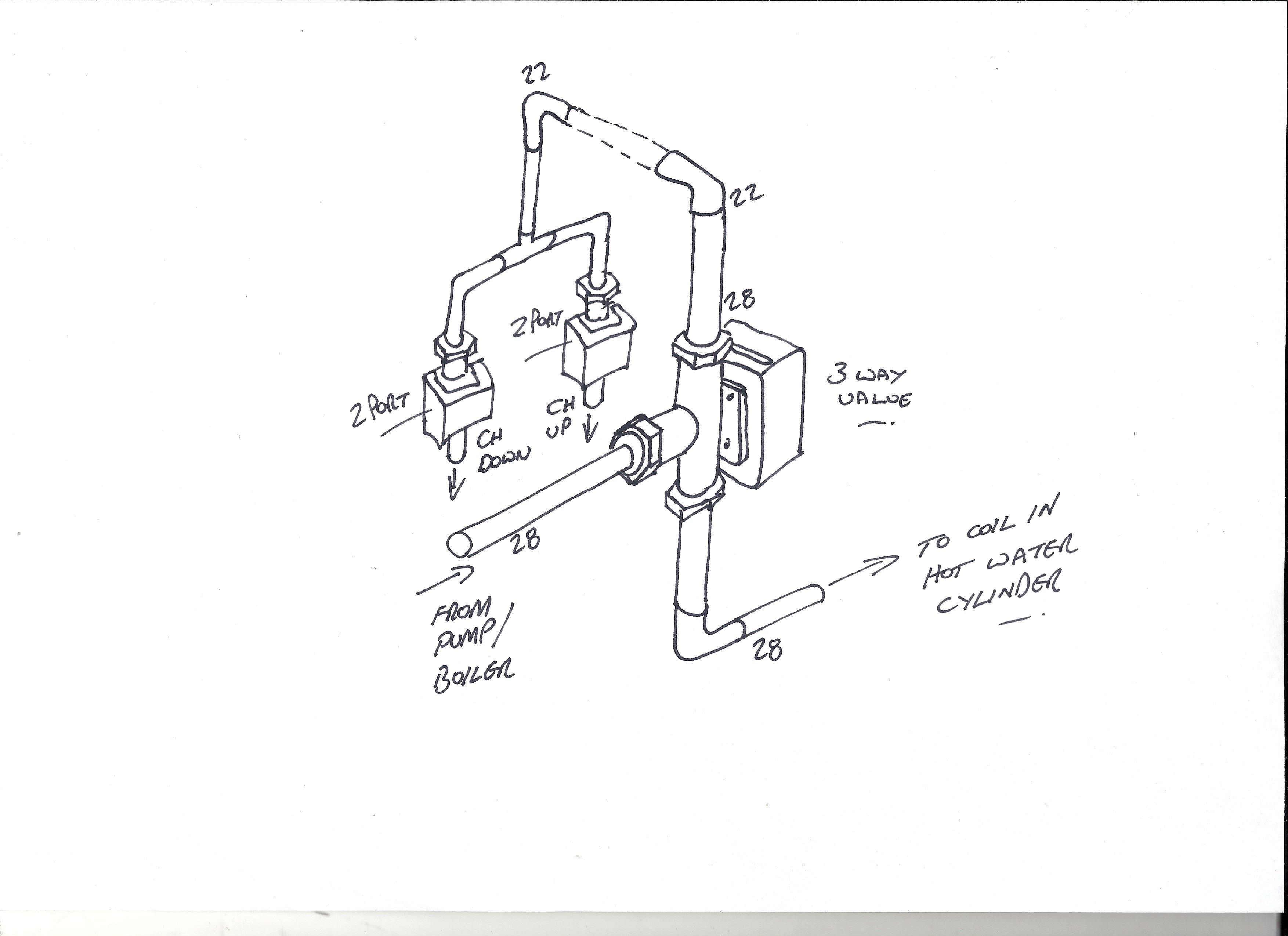

Onoff Posted November 18, 2018 Author Posted November 18, 2018 Getting myself in a tizzy here about what's doing what but I've got a heating circuit coming on as in downstairs rads warm when the controls are only calling for DHW. The 2 2-ports are operated by a contactor each and they're NOT calling the valve. That must mean not only is the 3-port letting by but the downstairs 2-port also. Both show heavy 'ish leaking under the covers. Also, can't remember which way round but think the downstairs rads get warm when only upstairs is calling. That would fit the symptoms if the downstairs 2-port is letting by. Would ask my boiler guru mate but he's not well. I've got Honeywell replacements, best man up and do it!

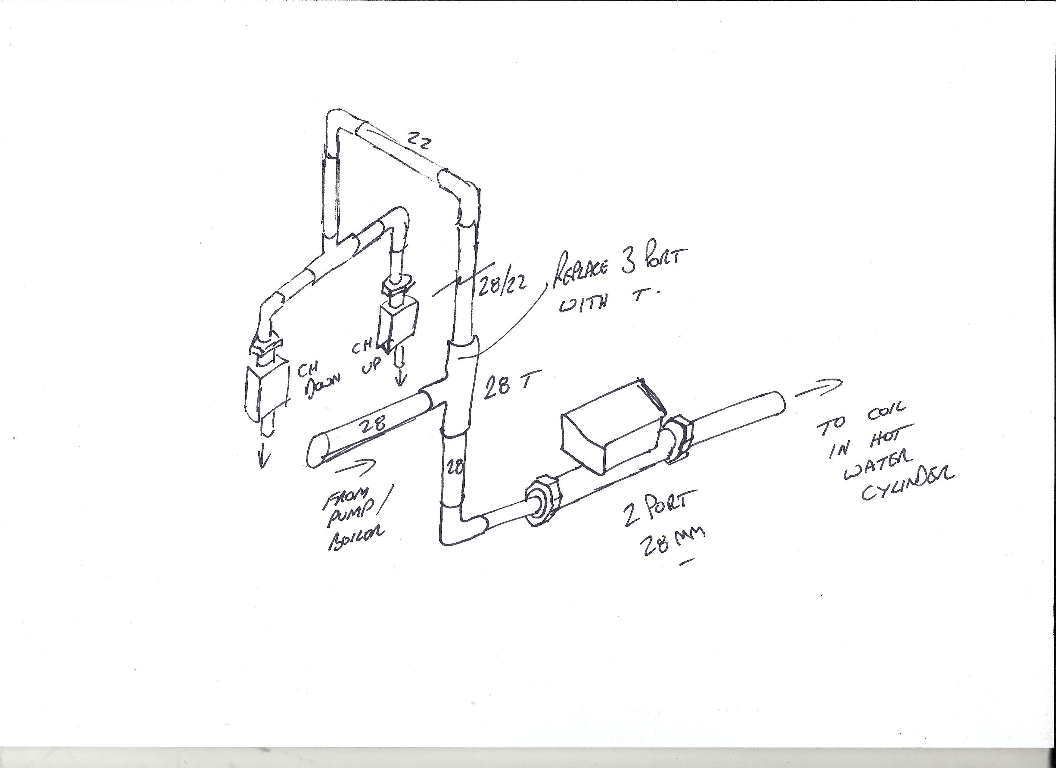

Nickfromwales Posted November 18, 2018 Posted November 18, 2018 Why don’t you just go to 3x 2-port? You won’t get guaranteed pump overrun with that arrangement anyway. Hace you ever had the boiler overheat stat pop and you’ve had to manually reset it ?( boiler kettled ).
Onoff Posted November 18, 2018 Author Posted November 18, 2018 (edited) 26 minutes ago, Nickfromwales said: Why don’t you just go to 3x 2-port? You won’t get guaranteed pump overrun with that arrangement anyway. Hace you ever had the boiler overheat stat pop and you’ve had to manually reset it ?( boiler kettled ). I've bought the bloody 3-port already! You mean like this? Plus I don't do well doing things on the fly, I have to consider & plan etc. Not the thing when the house is freezing and it needs to be up and running asap. Boiler stat tripping, no don't think so. Edited November 18, 2018 by Onoff
Nickfromwales Posted November 19, 2018 Posted November 19, 2018 Yup. Like that. Much simpler to control. Does your boiler do pump overrun ?

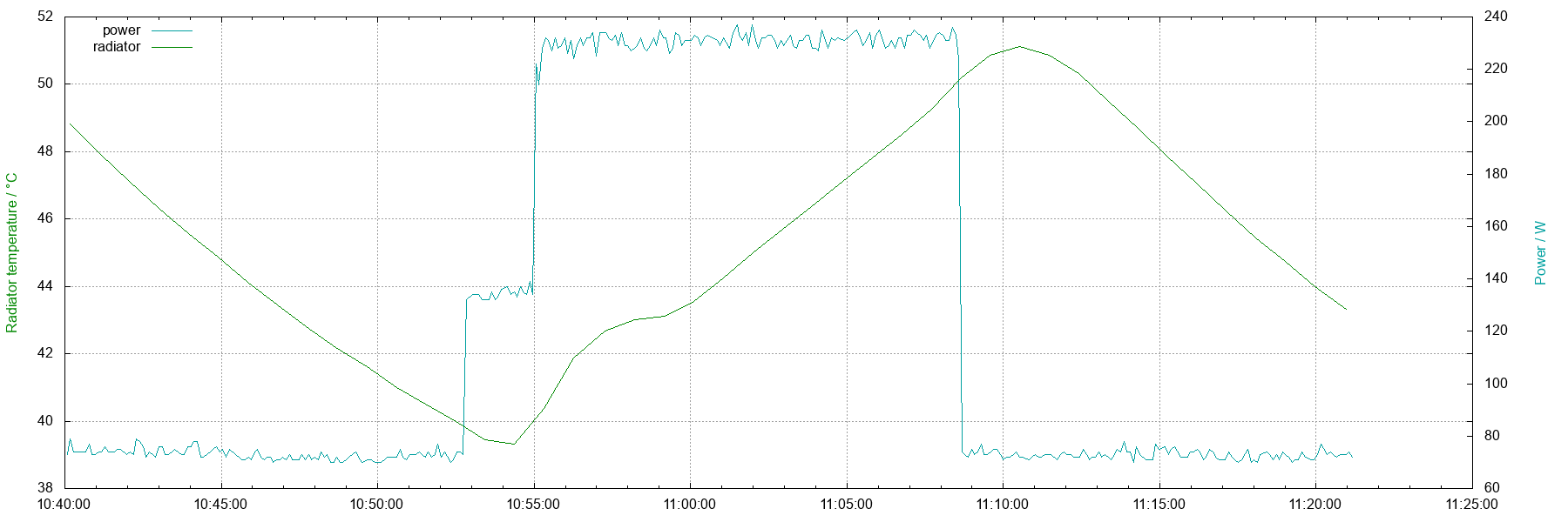

Ed Davies Posted November 19, 2018 Posted November 19, 2018 Pump keeps running for a few minutes after the boiler stops to make use of the heat remaining in the boiler. Otherwise it just goes to waste (e.g., for an outdoor boiler) or waits and gets used when the boiler next runs. E.g., for the oil boiler in the house I'm renting when the thermostat calls for heat the S-plan wiring sends power to the pump and boiler but the boiler is already hot enough from the last run so doesn't fire up for a minute or two. The thermostat called for heat at just before 10:53. The power consumption increased as the pump started. and about 1.5 minutes later the water got to the radiator in my study and its temperature started to increase and the temperature sensor there began to notice. At 10:55 enough hot water in the boiler had been replaced by cold that the boiler started up further increasing the power consumption. It'd be more efficient for this extra pump run to happen at the end of the cycle but that'd be a bit more complicated with simple S-plan wiring where just the valve-motor current goes through the thermostat. Problem is, if the boiler controller is controlling the pump and does the overrun but only gets a signal that the call for heat has ceased because the zone valves have closed it results in the pump pushing against closed valves.
