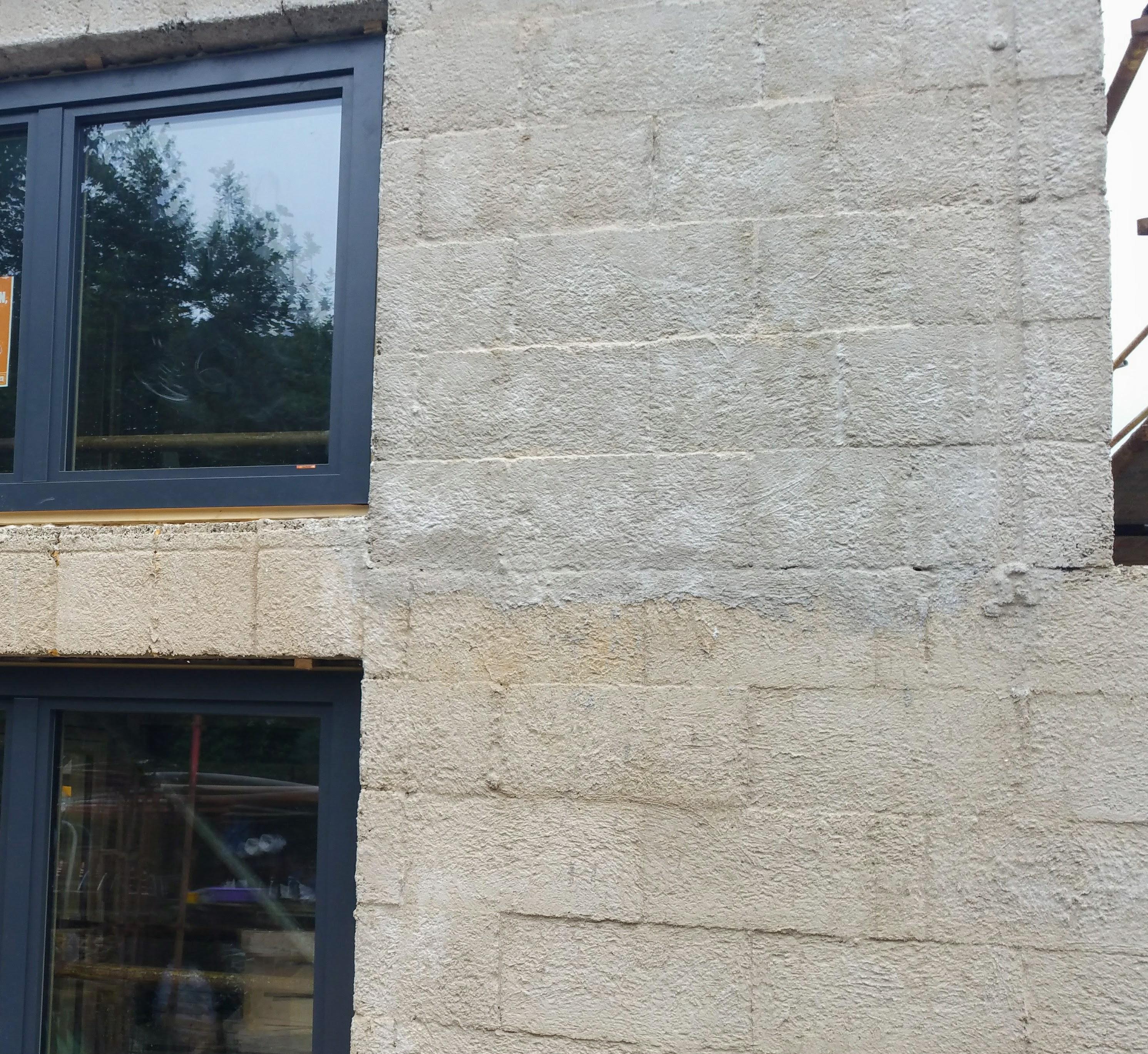

ToughButterCup Posted September 11, 2018 Share Posted September 11, 2018 1 hour ago, RichS said: [...] what make have people used and what problems if any have been encountered. [...] My attempts at render is exactly what's concerning me at the moment. My concern is the lack of consistency. Lets hope that @nod (Gary) reads this: he's our man Materials: I have used plastering sand, cement, and lime, 3:1:1 on Durisol. Technique: Mix it to a sloppy consistency, apply with a house brush (£2.60 form the local BM). I have tried a variety of 'thicknesses'. Its now bone hard. I can hit it quite hard with a hammer and nothing happens. But have a look at this Look at the difference in colour. I'm not sure why. But I suspect my lack of experience in mixing and - just possibly - a different bag of sand. Not sure. Cost? I don't think I've spent more than £100 on the whole house. My concern is also my poor application of the 'slurry' Sometimes I lay it on thick, others, thin. And you can see the difference. That doesn't matter to much because it will all disappear behind the Kloeber Permo Forte. Sometimes the surface is hard but a bit dusty, others bone hard. 'Spect I'm overthinking it..... @nod Gary, what do you think? Link to comment Share on other sites More sharing options...

nod Posted September 11, 2018 Share Posted September 11, 2018 I really wouldn’t worry Ian a slight variation in the amount of lime will alter the colour Regarding the thickness As long as every inch is covered you will be fine Looks like you have worked hard on it well done ? Link to comment Share on other sites More sharing options...
