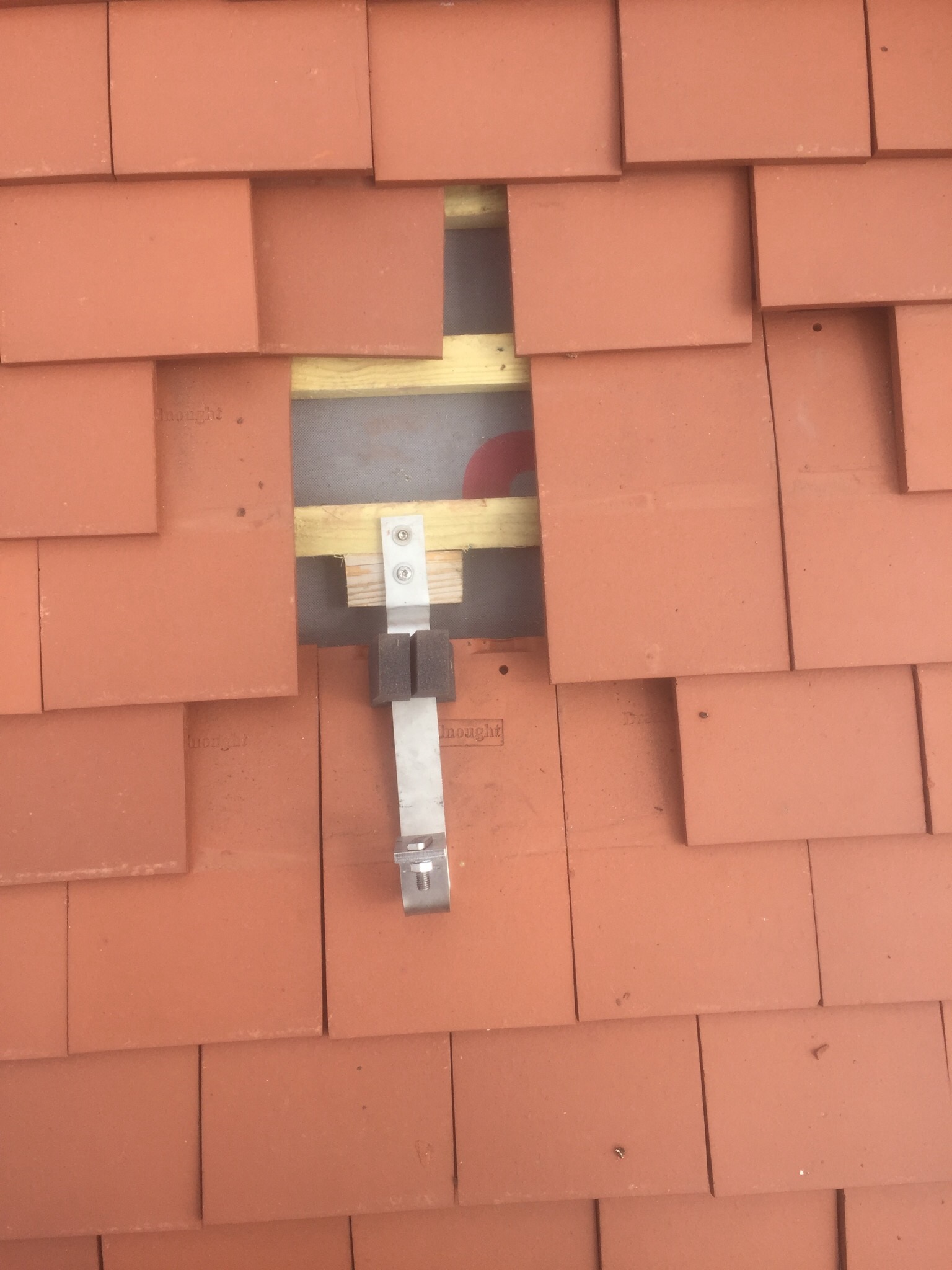

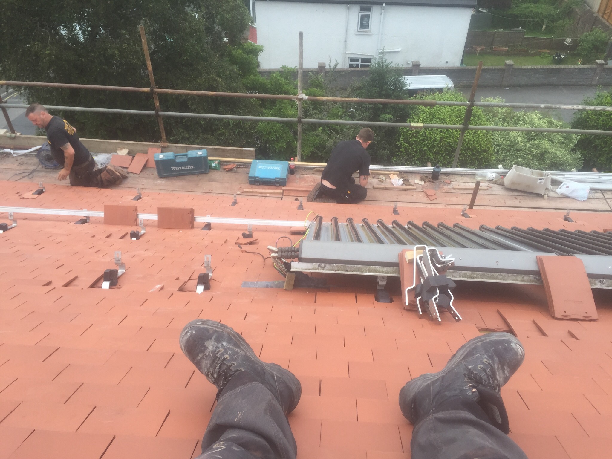

Nickfromwales Posted July 23, 2016 Posted July 23, 2016 I've just fitted a Pv array on a roof and used A2 stainless fixings. They're rock solid with zero shear, snapping etc and I'd not consider anything else for that particular task. Stainless can be soft as butter but these ones I used were concrete solid. tough at the top
Crofter Posted July 23, 2016 Author Posted July 23, 2016 What brand were they? I was just going by what Screwfix had. It's not really an exposed location, just an issue of cosmetic appearance really. The Torx heads will look quite neat I think.
Declan52 Posted July 23, 2016 Posted July 23, 2016 12 minutes ago, Nickfromwales said: I've just fitted a Pv array on a roof and used A2 stainless fixings. They're rock solid with zero shear, snapping etc and I'd not consider anything else for that particular task. Stainless can be soft as butter but these ones I used were concrete solid. tough at the top Sitting down on the job watching them other two guys do the work.
Nickfromwales Posted July 23, 2016 Posted July 23, 2016 The one on the left is called Grindy, the one on the right is Choppy. ??
Nickfromwales Posted July 23, 2016 Posted July 23, 2016 I was called a fat Billy Elliot as if you zoom in, you'll see I broke 4 tiles getting up there
Declan52 Posted July 23, 2016 Posted July 23, 2016 1 hour ago, Nickfromwales said: I was called a fat Billy Elliot as if you zoom in, you'll see I broke 4 tiles getting up there One too many beer and kebabs will do that.
