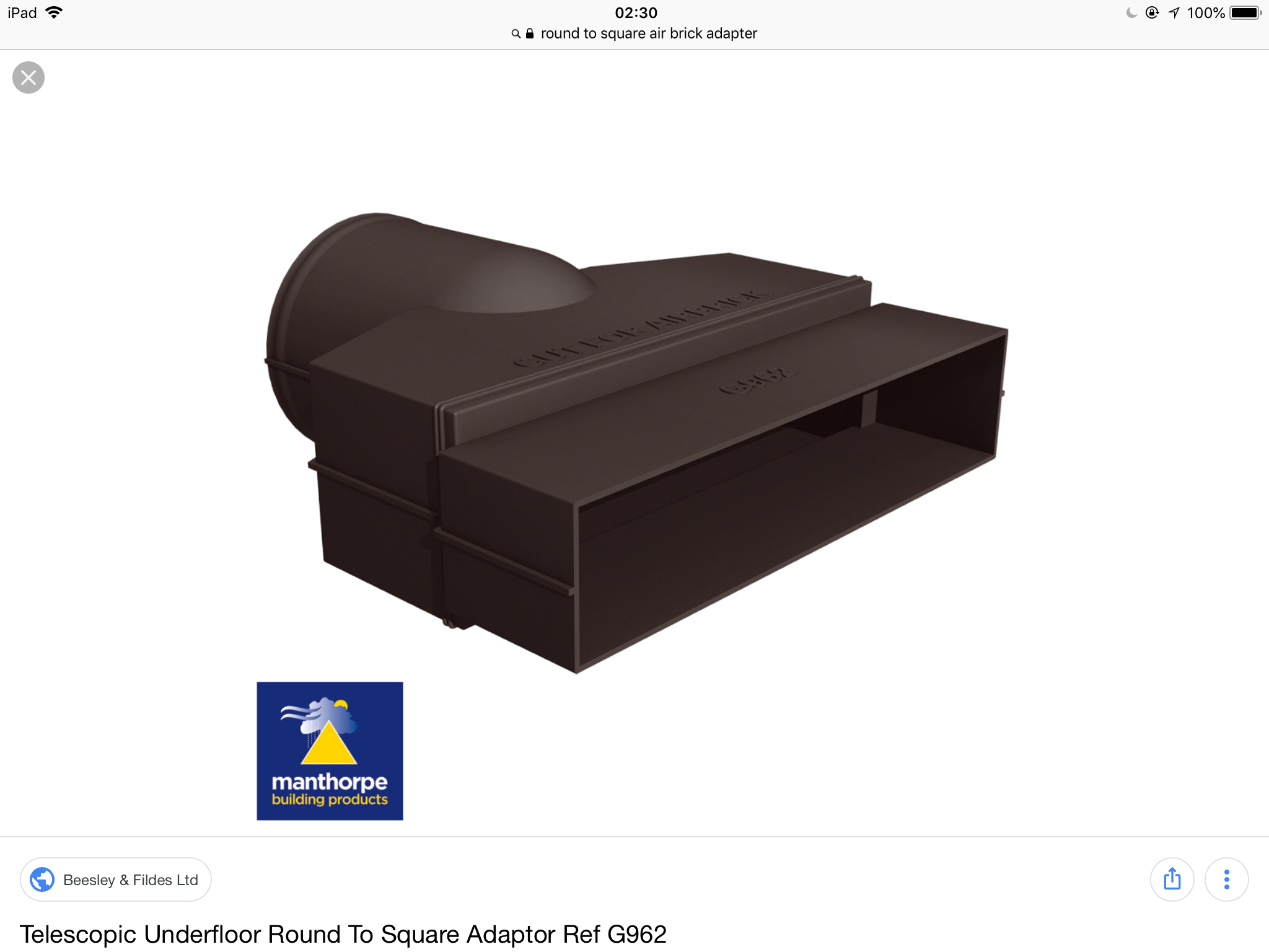

Russell griffiths Posted September 4, 2018 Share Posted September 4, 2018 Would you not have vents on the opposite wall with a round pipe connector to run the pipe over to the ventilated area. Sketch needed. Are you saying you have a solid section and a ventilated section if that’s what I’m thinking then it’s the round trunking you need with the round to square adapters Link to comment Share on other sites More sharing options...

epsilonGreedy Posted September 4, 2018 Author Share Posted September 4, 2018 4 hours ago, Russell griffiths said: Would you not have vents on the opposite wall with a round pipe connector to run the pipe over to the ventilated area. Sketch needed. I like the lateral thinking. 4 hours ago, Russell griffiths said: Are you saying you have a solid section and a ventilated section if that’s what I’m thinking then it’s the round trunking you need with the round to square adapters Yes. A workshop & store room situated over the suspended floor with void below then another larger single parking space for a car on a ground bearing slab. I expect the slab to be lower than the suspended floor which might mean the heights are wrong to implement your idea. My takeway from this thread is that a single wall of airbricks is wrong even for a small void 16ft x 8ft. I will sketch something and run it past my AT and BC guys. Link to comment Share on other sites More sharing options...
Russell griffiths Posted September 5, 2018 Share Posted September 5, 2018 I have similar a solid floor in the garage a suspended floor in the attached house. Normal air brick in outer wall of garage adapter on the back with 100 mm duct under garage slab poking into void area under house. Link to comment Share on other sites More sharing options...
