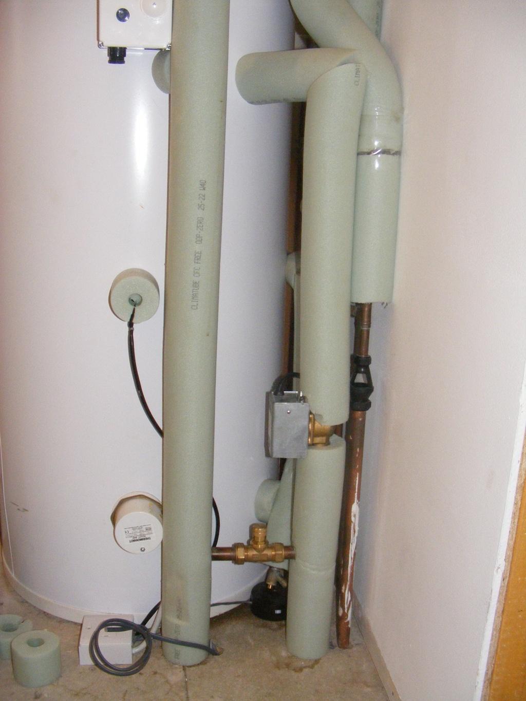

ProDave Posted August 27, 2018 Share Posted August 27, 2018 Telford 300L stainless, unvented cylinder with heat pump input coil, heated by LG 5KW air source heat pump. Was fine when first comissioned. But for the last week or so, when the heat pump is running heating the tank, the tank is making a hell of a racket. I can best describe the noise as like an old PC fan with worn out bearings grinding and rattling away. The noise is coming from within the tank, not from the pipework. So it has to be something like the heat input coil inside thew tank vibrating and resonating. It did not do this to start with. Nothing has changed. Flow rate is about 15L per minute, I can't reduce that otherwise the heat pump will trip, but even if I do reduce it, it does not stop the noise. I have tried increasing and reducing the pressure (of the heating loop) and that made no difference (can't see why it would but it was something to try) Any ideas. This is driving me nuts. Link to comment Share on other sites More sharing options...

ProDave Posted October 5, 2018 Author Share Posted October 5, 2018 So I have finally got around to trying to investigate this. The one thing I wanted to eliminate before I contact the cylinder manufacturer, is the automatic bypass valve. This is situated in the airing cupboard between the flow and return pipes, immediately before the 2 port motorised valve for the cyilinder, this puts it as far from the heat pump as possible. Adjusting the ABV does not stop the cylinder noise, but it goes through a transition as you close the ABV down you momentarily get silence before the noise starts up again a few seconds later. It is impossible to find a setting where it remains silent. To replace the ABV is not easy, will need a bit of pipework stripped down (didn't think that through enough) so I pondered what I could do to eliminate it. Well what I have done, is remove the top of the ABV, remove it's spring and plunger and put it back together. So now it won't be operating as an ABV but as a permanent bypass and probably way too much bypass. The result. Totally silent hot water heating. Hot water still seems to heat up okay in spite of almost certainly too much bypass. I assume convection ensures enough flows through the heat input coil rather than all bypassing? No detrimental affect noticed on space heating. Even with too much bypass, the manifold pumps seem to ensure enough circulates through the UFH and it maintains it's temperature. What now? Leave it like that? Replace with a new (different make) ABV? replace with a gate valve to give manually adjusted fixed bypass? Link to comment Share on other sites More sharing options...

ProDave Posted October 5, 2018 Author Share Posted October 5, 2018 7 minutes ago, JSHarris said: Good that you've found the cause. As it's working I'd leave it. The chances are that your pipe work may well have created a low loss header, where there is a hydraulic preference to go straight across the top of the bypass. You could be right. That is the flow and return both coming up out of the floor and 3/4 of the way up the cylinder to where the coil connections are. The ABV is connected between these just above the floor. Above that and to the right is the 2 port motorised valve for hot water The flow rate is relatively high at 15l/min so water is indeed more likely to go straight on, rather than make a 90 degree turn to pass through the (now nobbled) ABV. My guess is the noise was an unfortunate resonance thing, with the workings of the ABV oscillating at the resonant frequency of the coil and making it vibrate. No ill effects so I will see how it goes. 1 Link to comment Share on other sites More sharing options...

Nickfromwales Posted October 6, 2018 Share Posted October 6, 2018 Last one I had issue with was a non return single check valve on the hot return. As it was directly after a 90o bend the water was causing the valve to oscillate and just moving it a few inches further from the bend made it go silent. Funny thing, water ( or hydraulic dynamics ? ). Link to comment Share on other sites More sharing options...
ProDave Posted October 6, 2018 Author Share Posted October 6, 2018 4 hours ago, Nickfromwales said: Last one I had issue with was a non return single check valve on the hot return. As it was directly after a 90o bend the water was causing the valve to oscillate and just moving it a few inches further from the bend made it go silent. Funny thing, water ( or hydraulic dynamics ? ). So the message to anyone reading and about to do their plumbing is DO NOT put the ABV right in between two 90 degree bends. All seems to be working fine and silently now, both HW and heating working as they should. So I will leave it as it is. Link to comment Share on other sites More sharing options...
