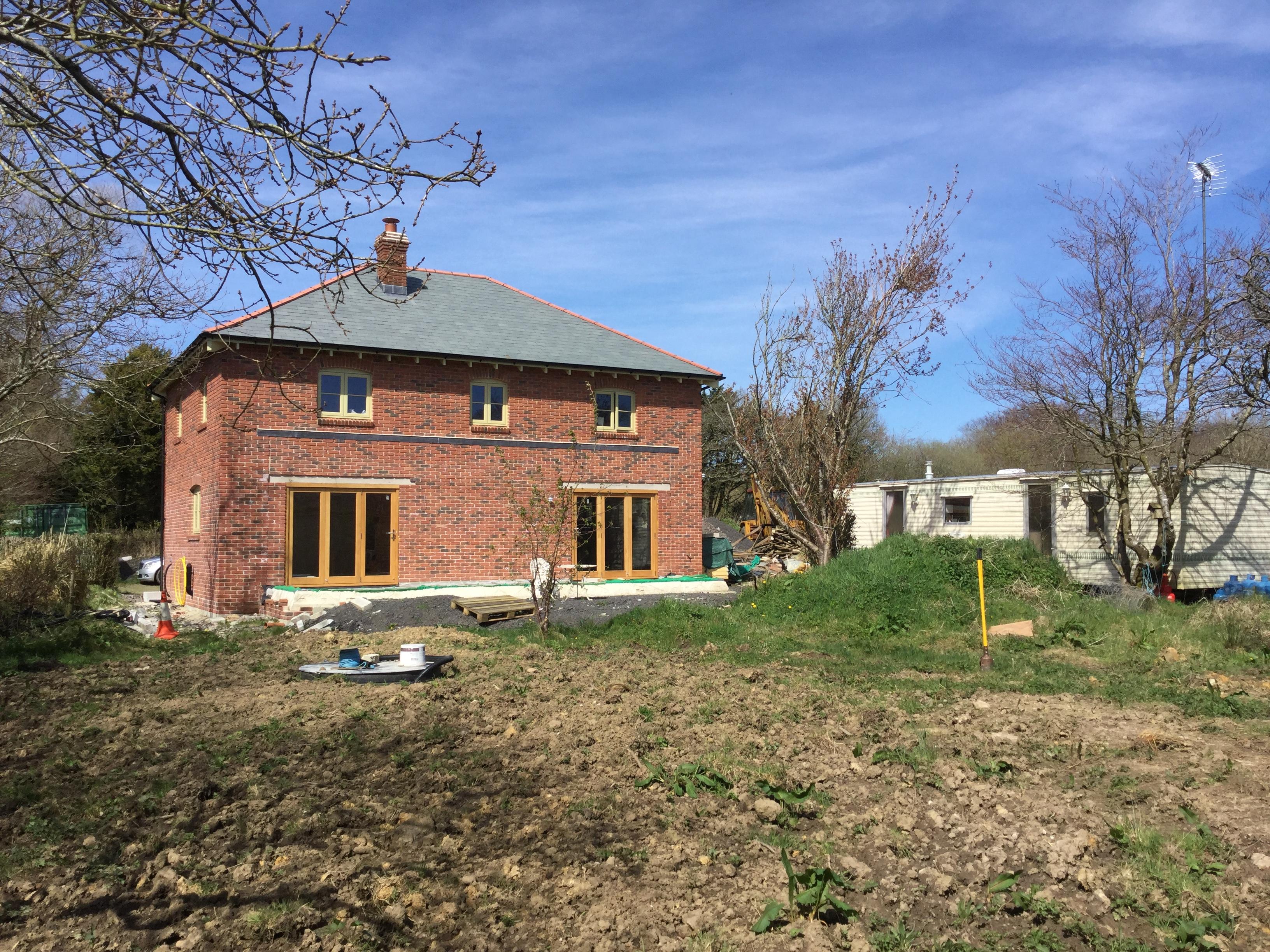

joe90 Posted August 25, 2018 Author Posted August 25, 2018 Here is where the sunroom will go. Will post pic of completion 1
