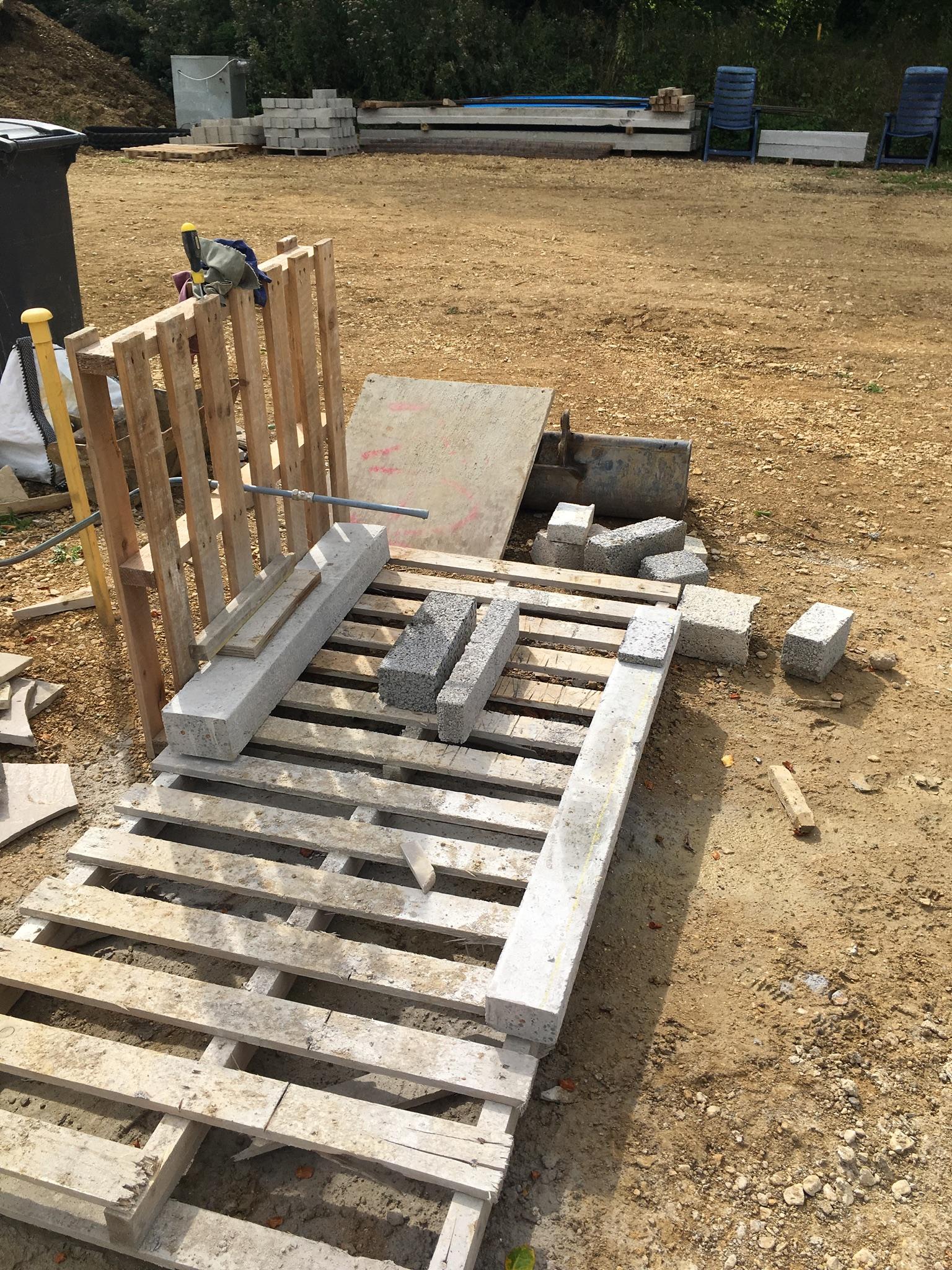

PeterW Posted August 23, 2018 Share Posted August 23, 2018 1 minute ago, epsilonGreedy said: When they cut blocks they could almost control the cutter with a single hand by letting the cutter drift through the block on its own weight. Could I buy some sort of ground based vice to hold the blocks allowing my foot to be kept out of the way? Couple of pallets with a gap in between and a bit of scrap wood to hold the block. Drop it in, cut straight through the gap between the pallets and keep your feet out of the way - even wearing boots ..!! 1 Link to comment Share on other sites More sharing options...

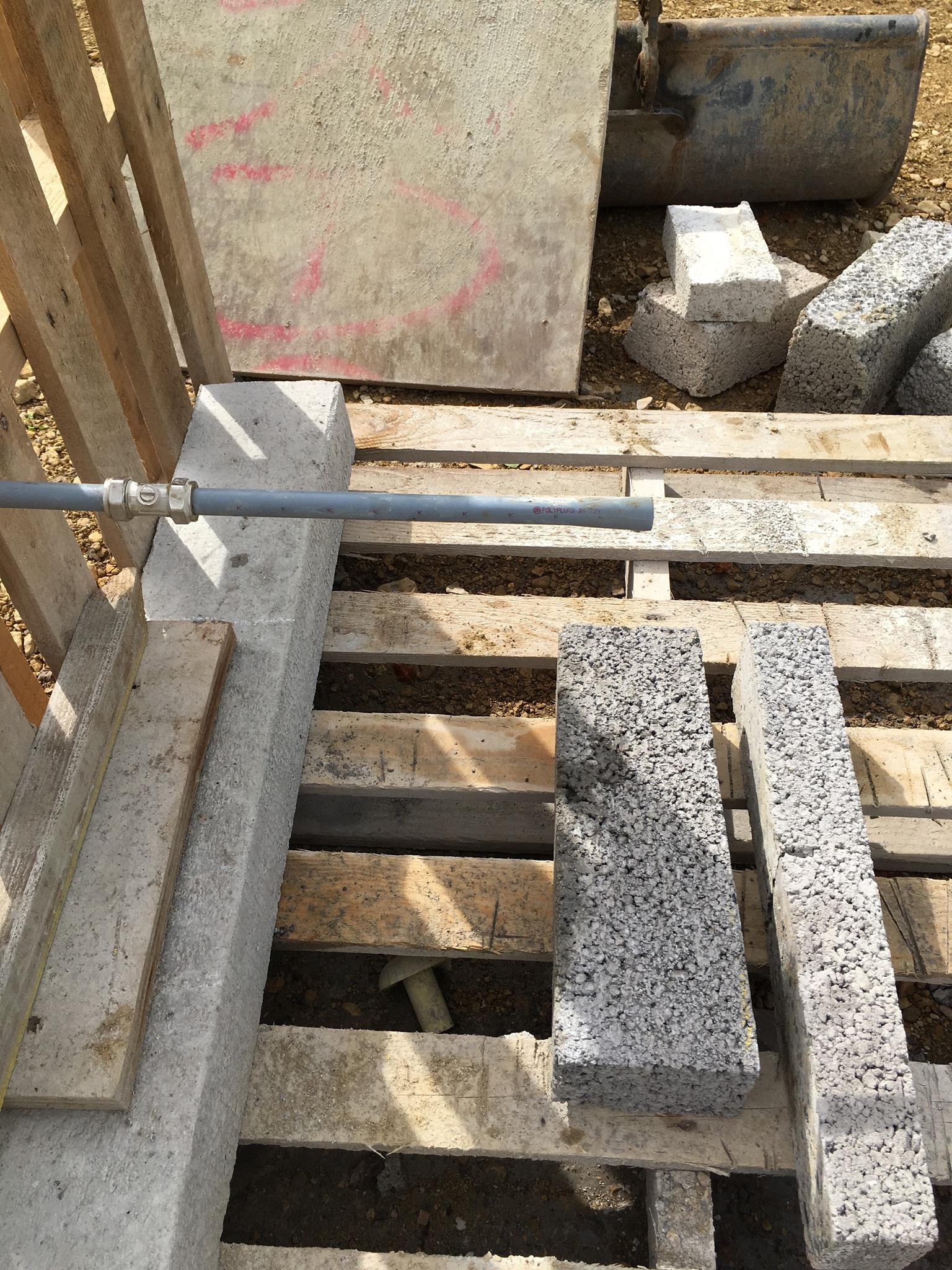

Russell griffiths Posted August 24, 2018 Share Posted August 24, 2018 As Peter said and as I said previously get a pallet put it on the floor put block on top cut through block if you put your foot on it your a fool asking for trouble. you should not be making any dust it’s very bad for you. I hope you have the correct PPE eye protection, ear defenders. Common sense number 3 is normally lacking in the vast majority of people I meet. Pic to folow. Link to comment Share on other sites More sharing options...
Vijay Posted August 24, 2018 Share Posted August 24, 2018 1 hour ago, Russell griffiths said: As Peter said and as I said previously get a pallet put it on the floor put block on top cut through block if you put your foot on it your a fool asking for trouble. you should not be making any dust it’s very bad for you. I hope you have the correct PPE eye protection, ear defenders. Common sense number 3 is normally lacking in the vast majority of people I meet. Pic to folow. Exactly how I cut all my blocks and worked well Link to comment Share on other sites More sharing options...

Russell griffiths Posted August 25, 2018 Share Posted August 25, 2018 No more complicated than this. My cutter has the hose attachment at the side, but I inadvertently turned the pressure up to high one day and blew a hole in the pipe. Waiting for a new one to turn up. v 2 Link to comment Share on other sites More sharing options...
Vijay Posted August 25, 2018 Share Posted August 25, 2018 even having the water gravity fed works on keeping the dust right down. Mine was just a small barrel with hose connector that was on a bench (so higher than my cutter). Link to comment Share on other sites More sharing options...
