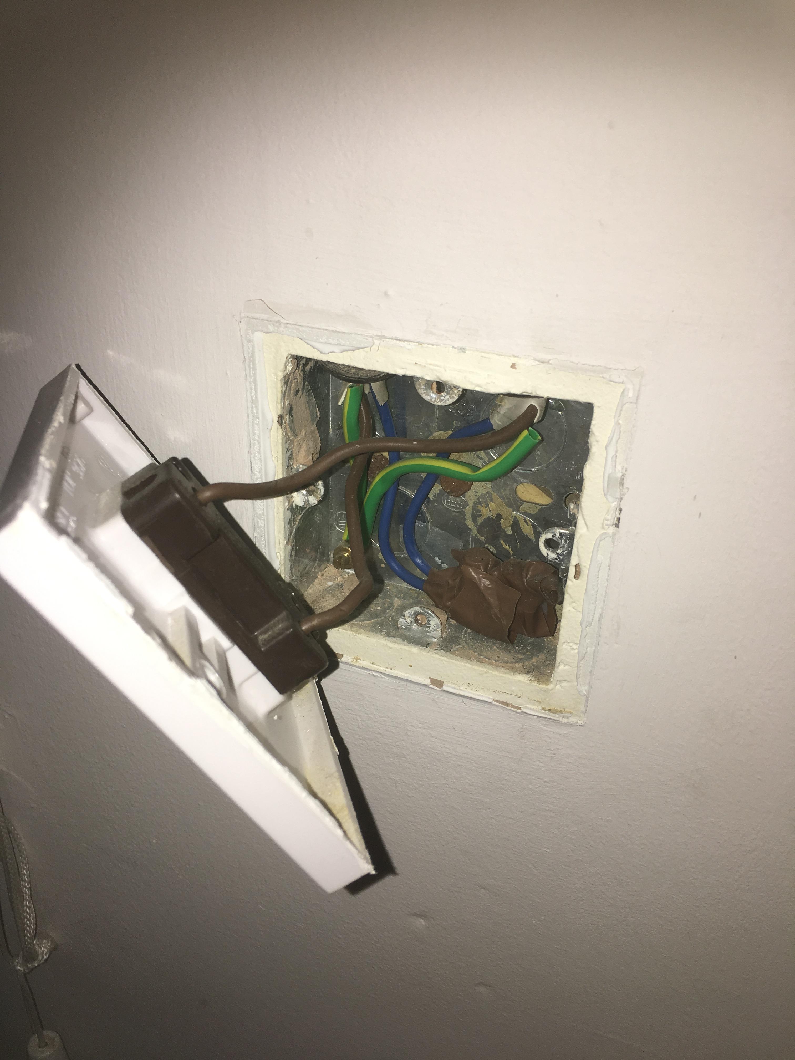

Wes Posted August 13, 2018 Author Share Posted August 13, 2018 I had a look inside the switch yesterday and it has two brown wires, one to COM and the other to L1. There are some blue wires in the box with the ends taped up. Link to comment Share on other sites More sharing options...

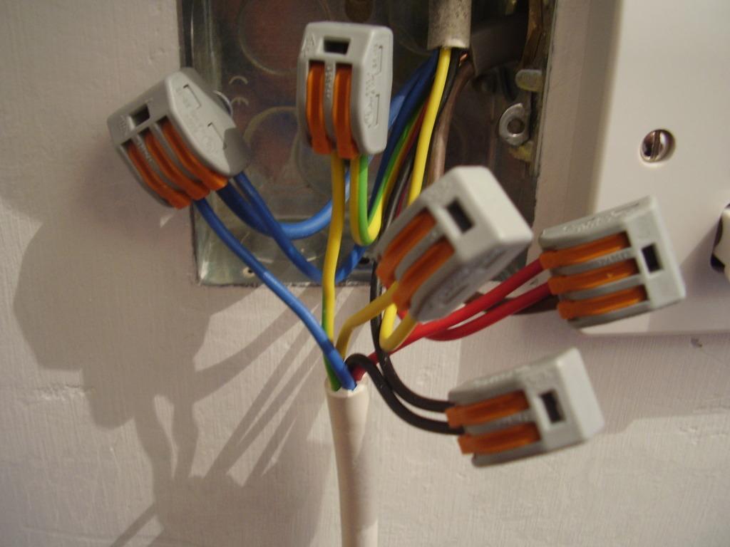

Nickfromwales Posted August 13, 2018 Share Posted August 13, 2018 3 minutes ago, Wes said: I had a look inside the switch yesterday and it has two brown wires, one to COM and the other to L1. There are some blue wires in the box with the ends taped up. With the power turned off, expose the blues ( neutrals ) and ensure they're all made off together in the same block. A pic would really help here. With the blues checked out the power back on with the switch open. Test between COM and blue reading voltage and then do the same between L1 and blue. Then flick the switch and do L1 to blue again to see if the switch changes the state of L1. Sounds like a dodgy neutral to me but impossible to say down the Internet. Link to comment Share on other sites More sharing options...
Wes Posted August 13, 2018 Author Share Posted August 13, 2018 3 minutes ago, Nickfromwales said: With the power turned off, expose the blues ( neutrals ) and ensure they're all made off together in the same block. A pic would really help here. With the blues checked out the power back on with the switch open. Test between COM and blue reading voltage and then do the same between L1 and blue. Then flick the switch and do L1 to blue again to see if the switch changes the state of L1. Sounds like a dodgy neutral to me but impossible to say down the Internet. Hi Nick Couple of questions: When you say all made off together in the same block, do you mean all the neutrals ends connected up as one? (I will load up a pic later.) Should the test between COM and blue and L1 and blue show 240V? And if the L1 to blue voltage is different when the switch is flicked, what is this telling me? Cheers Wes Link to comment Share on other sites More sharing options...

Wes Posted August 13, 2018 Author Share Posted August 13, 2018 Ok, so I have tested at the light fitting and here are the results: Live and Neutral: 3V......clearly not right! Live and Earth: 240V Neutral and Earth: 211V See picture of the light switch below: Link to comment Share on other sites More sharing options...
dpmiller Posted August 13, 2018 Share Posted August 13, 2018 definite neutral fault then Link to comment Share on other sites More sharing options...
Wes Posted August 13, 2018 Author Share Posted August 13, 2018 Now to find it.... can it be anywhere in the room, as in plug sockets, lights, appliances. etc? Link to comment Share on other sites More sharing options...

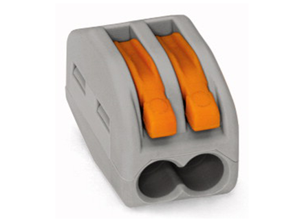

Onoff Posted August 13, 2018 Share Posted August 13, 2018 1 minute ago, Wes said: I changed a light and the neutral was a pain. Checked it tonight and looks ok. Fits in to one of those in line clip connectors...rubbish in my opinion so perhaps I should change that. Also changed a plug socket so will check it. In line clip connector? You don't mean one of these, a Wago? They are foolproof. But when you think they're "down" the orange lever goes a little more. Link to comment Share on other sites More sharing options...
Wes Posted August 13, 2018 Author Share Posted August 13, 2018 No, not that one, it came with the Ikea lamp..I’ll get something like this and change it out. Link to comment Share on other sites More sharing options...
Onoff Posted August 13, 2018 Share Posted August 13, 2018 (edited) 7 minutes ago, Wes said: No, not that one, it came with the Ikea lamp..I’ll get something like this and change it out. The beauty of the pictured Wago is it also has a little test probe hole. Handy little set: https://www.screwfix.com/p/wago-basic-installer-box-75pcs/48808? Screwfix don't sell them individually. TLC do. Where are you? Maybe one of us is local and can drop one in. Just a regular connector block if desperate. Edited August 13, 2018 by Onoff Link to comment Share on other sites More sharing options...

ProDave Posted August 14, 2018 Share Posted August 14, 2018 20 minutes ago, Wes said: Having a look at the indoor light which was replaced - there is no ceiling rose....clearly where the problem is coming from as there is no loop. If I am correct, there should be wires for loop in, loop out, and switch? Will check again after work what wires are there. Unless I am getting confused, your earlier picture showed neutral at the light switch. So your house is wired "loop at switch" so you should only have a single L, N and E at the light fitting. Perhaps 2 of each if the switch controls more than 1 light and it loops off to another light fitting. Time for some dead testing to check the continuity of the L and N connections all the way. Link to comment Share on other sites More sharing options...
