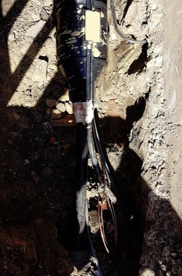

We are getting a new 3 phase supply and from the mains joint in the trench there is a reel of thick copper wire exposed. Is this part of the PME system?
Also when you change from a TT earth (temporary power supply to building site) to PME earth is it compulsory to disconnect the copper earth rod. If it's not compulsory to remove the rod, is it helpful to leave it connected as additional earthing for the future?

Yes that pigtail of wire is one of the multiple earths of a PME system.  If you ever see the work n a new pole where a new transformer is installed they run a new LV earth in one direction, and an HV earth in the other in the trench
You can leave your rod connected, I have one at out house, here is talk if this becoming a requirement for PME systems.
