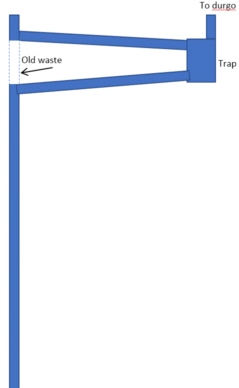

jack Posted August 8, 2018 Share Posted August 8, 2018 Air admittance vales are at their best when you have a large slug of water draining all at once - think toilets, sinks (if draining from full) and baths. In your case, you're draining something that will generate a steady but relatively small flow of water. It therefore won't build up a slug of water in the vertical pipe to which your durgo attaches. In that case, the only source of the vacuum is whatever happens below the vertical run shown in your pic. Because that's so far away from the durgo, the large volume of air in the circuit (all legs) between the durgo and the bottom of the pipe may be preventing an effective vacuum from forming. Whatever low vacuum is building may be enough to slow drainage but not enough to allow the durgo to open properly. The vacuum may also be intermittent if whatever's causing it down below isn't continuous (eg, if it periodically allows air to burp up from further down the pipework), which will again prevent the durgo from operating correctly. If any or all of this is true, putting a trap directly below the "T" to the durgo might help, and isn't too expensive or disruptive an option to test. Optionally, you might put an elbow on the left hand pipework to take it over to underneath the durgo pipework, then put a trap below with vertical up to the durgo, and then another elbow back to the existing vertical pipe (or maybe vertically down to wall, then across to the left lower down, if that isn't in the way). That would drastically reduce the volume of air in the circuit within which the durgo is operating. Please note that all of this might well be nonsense, as it's just based on me thinking about how all this might work, rather than having any real knowledge of how it does work! Link to comment Share on other sites More sharing options...
Minky Posted August 8, 2018 Author Share Posted August 8, 2018 Thanks Jack, if I understand correctly you're suggesting moving the shower trap to below where the waste pipe forks off to the durgo - as that might increase the force of the shower water entering the pipe? The problem is that this is a wet room so the shower trap is "built-in" to the floor. But I agree that maybe the force of the water moving through this isn't enough to force the air across to the durgo. CC45 - I see what you're saying here and it might be easy enough to try. It would be annoying having a soil pipe in the middle of the garage but probably not as annoying as a slow draining shower! Link to comment Share on other sites More sharing options...

jack Posted August 8, 2018 Share Posted August 8, 2018 31 minutes ago, Minky said: Thanks Jack, if I understand correctly you're suggesting moving the shower trap to below where the waste pipe forks off to the durgo - as that might increase the force of the shower water entering the pipe? Not quite - I was suggesting putting another trap at that location and leaving the shower as it is. Picture's worth a thousand words and all that: 1 Link to comment Share on other sites More sharing options...
Minky Posted August 8, 2018 Author Share Posted August 8, 2018 Thanks Jack, and excuse my ignorance but how would putting another trap below the durgo help the pressure? (without being too technical if that is possible). CC45 - that would be an option, thanks for that. Link to comment Share on other sites More sharing options...

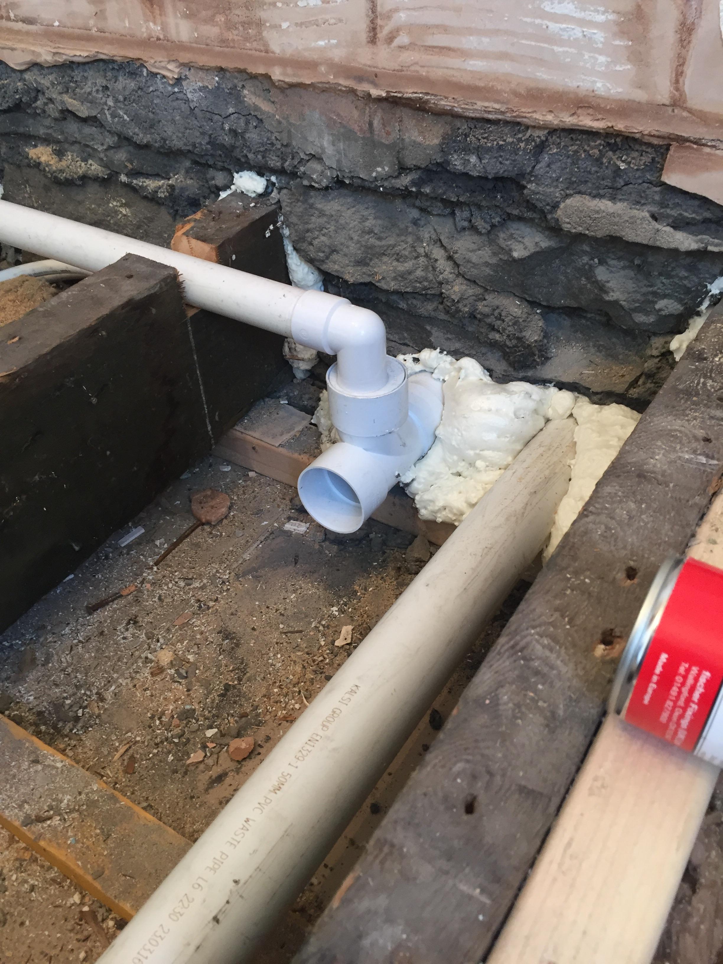

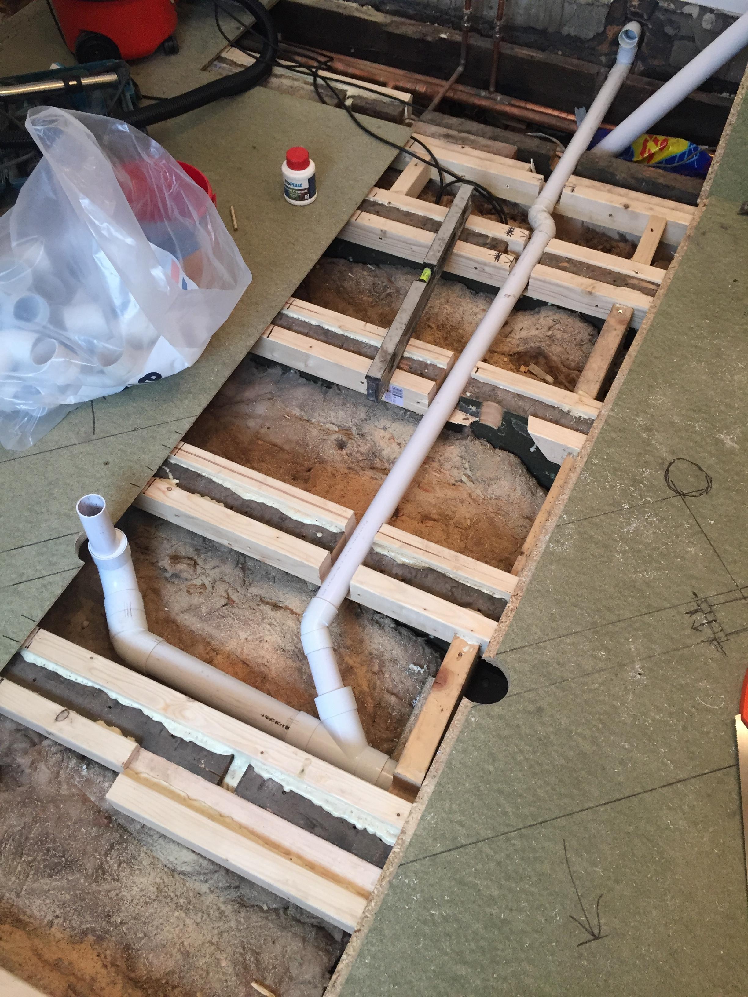

Nickfromwales Posted August 8, 2018 Share Posted August 8, 2018 (edited) Thats on my current wetroom job. Right hand 50mm goes to the free standing bath and basin as shown below. The first pic shows the 50mm tee ( for the shower ) with a 32mm branch going off to the new airing cupboard. In there will be a short section of 32mm pipe, a 32mm tee, a 32mm AAV in the top of the tee, and then the boiler condensate into the same tee on a 32x21.5mm reducer. The pipe going down the wall should have been 50mm TBH, as you then get a massive improvement on air break. It'll basically be almost trying to form a syphon as it falls vertically so not the best bit of plumbing TBH. The rule is when dropping like that to oversize to get an air break. Yes, an AAV will allow air in, but not at the tornado rates that you'll be needing. Edited August 8, 2018 by Nickfromwales Edited because Apple won't let me spell the bastard word syphon ffs. Link to comment Share on other sites More sharing options...
