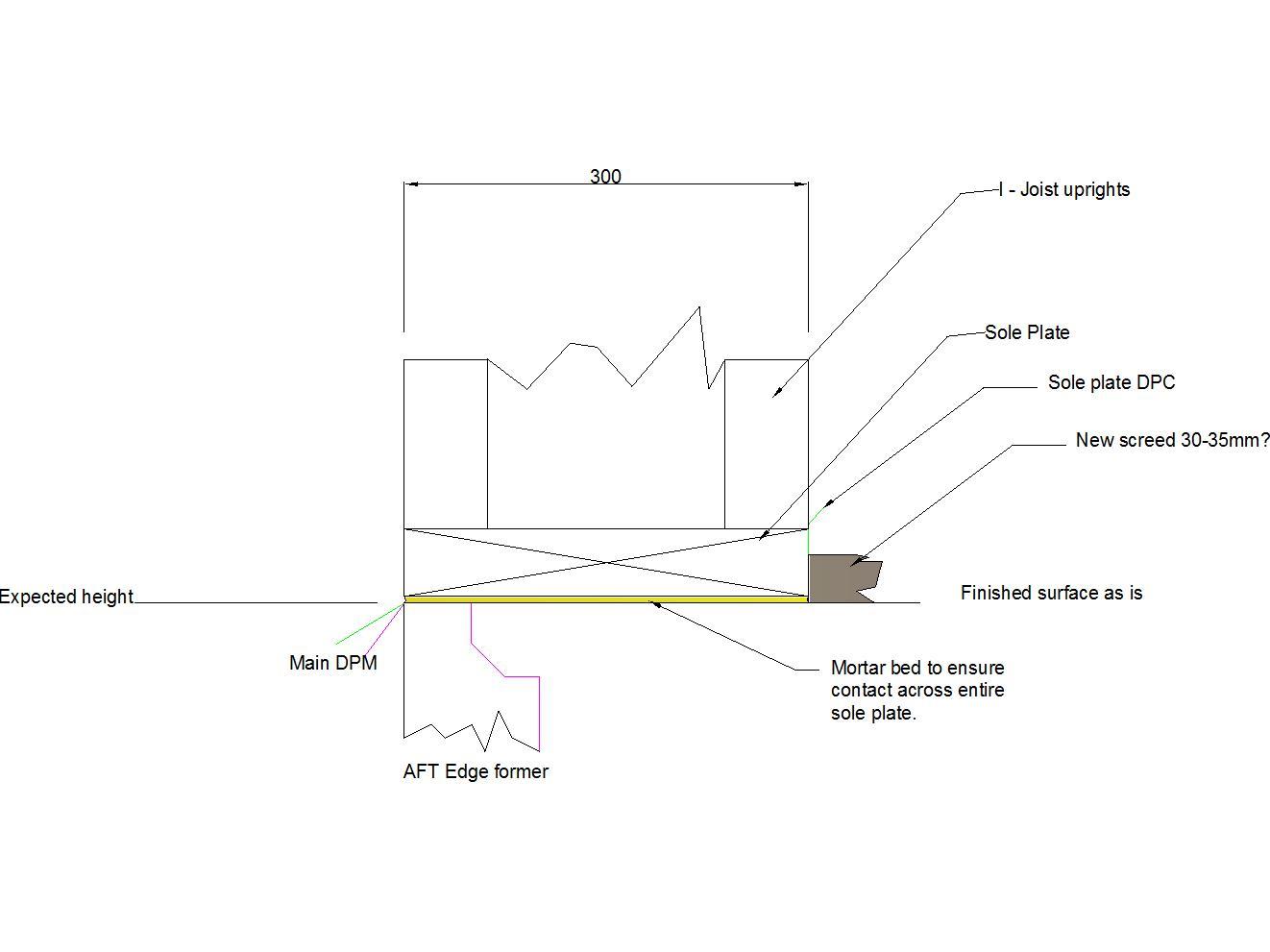

MikeSharp01 Posted August 8, 2018 Author Posted August 8, 2018 Ok so I am getting there with potential solutions but I want to press on so I thought I would move ahead allowing for all permutations when fitting the sole plate. The cost of the finish won't change much once the sole plate is down as long as I leave the internal walls out for now. SO I need to get a sole plate detail that ensures we can either go down (easy) or up with a screed. Its all about making sure the DPC comes out above the screed - so here is my thinking which would allow up to 60mm of screed assuming the mortar bed, which sits on the DPC, is about 10mm: Is this a runner, any thoughts?
