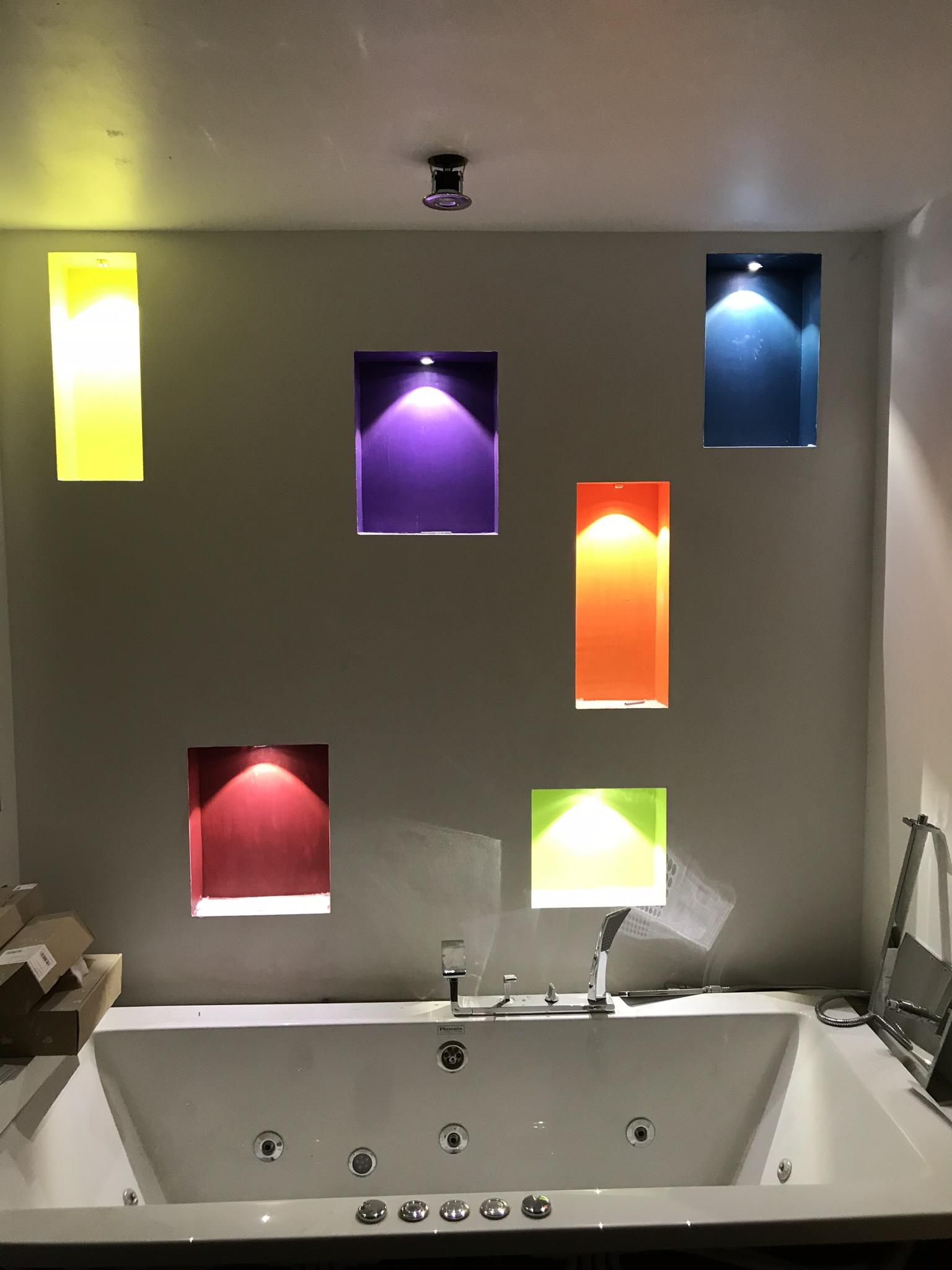

More ideas!
What about basement style light wells outside? Perfectly screened but actual light at room level? Could be quite exciting? Imagine these recesses are all windows down the wall...
it could be immense in style.
