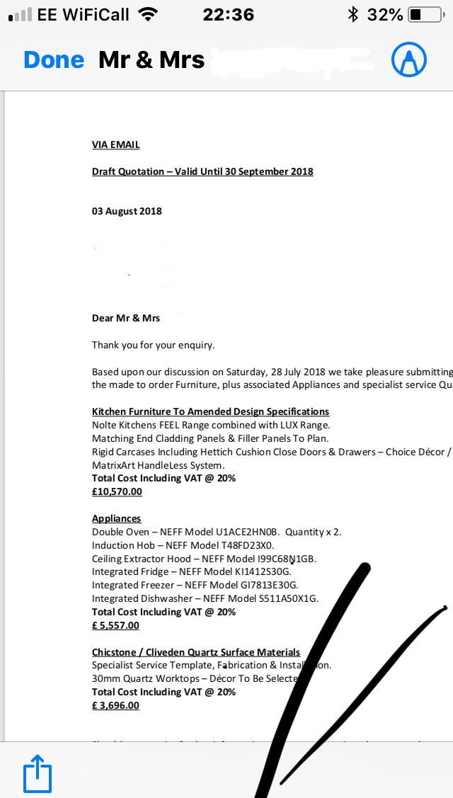

nod Posted August 3, 2018 Posted August 3, 2018 Time to make a decision on a kitchen How much of the total below would we be able to claim the vat back [Edited by Jeremy to remove your name and address details, just as a security precaution, hope you don't mind]
lizzie Posted August 4, 2018 Posted August 4, 2018 If they are supply and fit they should not charge you vat on anything other than appliances - you cant claim vat on appliances - if they are supply only you can claim the vat back on everything except the appliances
ragg987 Posted August 4, 2018 Posted August 4, 2018 As @lizzie, if supply only you can reclaim VAT. Extractors are claimable, other appliances are not. However, if supply and fit you need to get supplier to zero the VAT as you cannot subsequently reclaim it. Your worktop should be zero-rated at source as they fit, cabinetry I cannot tell as they do not mention fitting. 1
newhome Posted August 4, 2018 Posted August 4, 2018 If there is a mix of supply only (kitchen units?) and supply and fit (worktops?) I would ask for separate invoices to avoid any confusion with the reclaim unless supply only things are clearly stated as such. I ordered my kitchen and appliances from a single supplier (supply only - the worktop came from somewhere else). The appliances were on a separate invoice all with vat included and I marked up the extractor and claimed the vat back for that in full. You may not have an issue but from reading the experience of others sometimes HMRC queries specific invoices and then don't pay out on those initially meaning you have to wait even longer for the vat to be refunded. So just make sure that it's all very clear and unambiguous. 39 minutes ago, ragg987 said: Extractors are claimable, other appliances are not. . If they fit the appliances should the extractor be zero rated too? 1

lizzie Posted August 4, 2018 Posted August 4, 2018 As I understand it extractors are only zero vat if they are vented to outside recirculating ones are vatable. Mine is recirculating as MVHR designer advised not to have outside vented one with MVHR so I have not reclaimed my vat on the extractor.....being part of my Bora hob too may have been interesting.
Guest Alphonsox Posted August 4, 2018 Posted August 4, 2018 56 minutes ago, lizzie said: As I understand it extractors are only zero vat if they are vented to outside recirculating ones are vatable. Mine is recirculating as MVHR designer advised not to have outside vented one with MVHR so I have not reclaimed my vat on the extractor.....being part of my Bora hob too may have been interesting. Were does your info on vented extractors come from ? According to the HMRC notes you can claim VAT on electrical appliances that are “designed to provide ventilation, air cooling or purification or dust extraction.” A recirculating extractor would seem to pass the “purification” test.
lizzie Posted August 4, 2018 Posted August 4, 2018 2 minutes ago, Alphonsox said: Were does your info on vented extractors come from ? According to the HMRC notes you can claim VAT on electrical appliances that are “designed to provide ventilation, air cooling or purification or dust extraction.” A recirculating extractor would seem to pass the “purification” test. hmrc helpline
newhome Posted August 4, 2018 Posted August 4, 2018 Just now, Alphonsox said: Were does your info on vented extractors come from ? According to the HMRC notes you can claim VAT on electrical appliances that are “designed to provide ventilation, air cooling or purification or dust extraction.” A recirculating extractor would seem to pass the “purification” test. I claimed for my extractor (it's not vented to the outside due to MVHR). 1
ragg987 Posted August 4, 2018 Posted August 4, 2018 Internal recirculators here as well. Zero rated as supply and fit. 1
