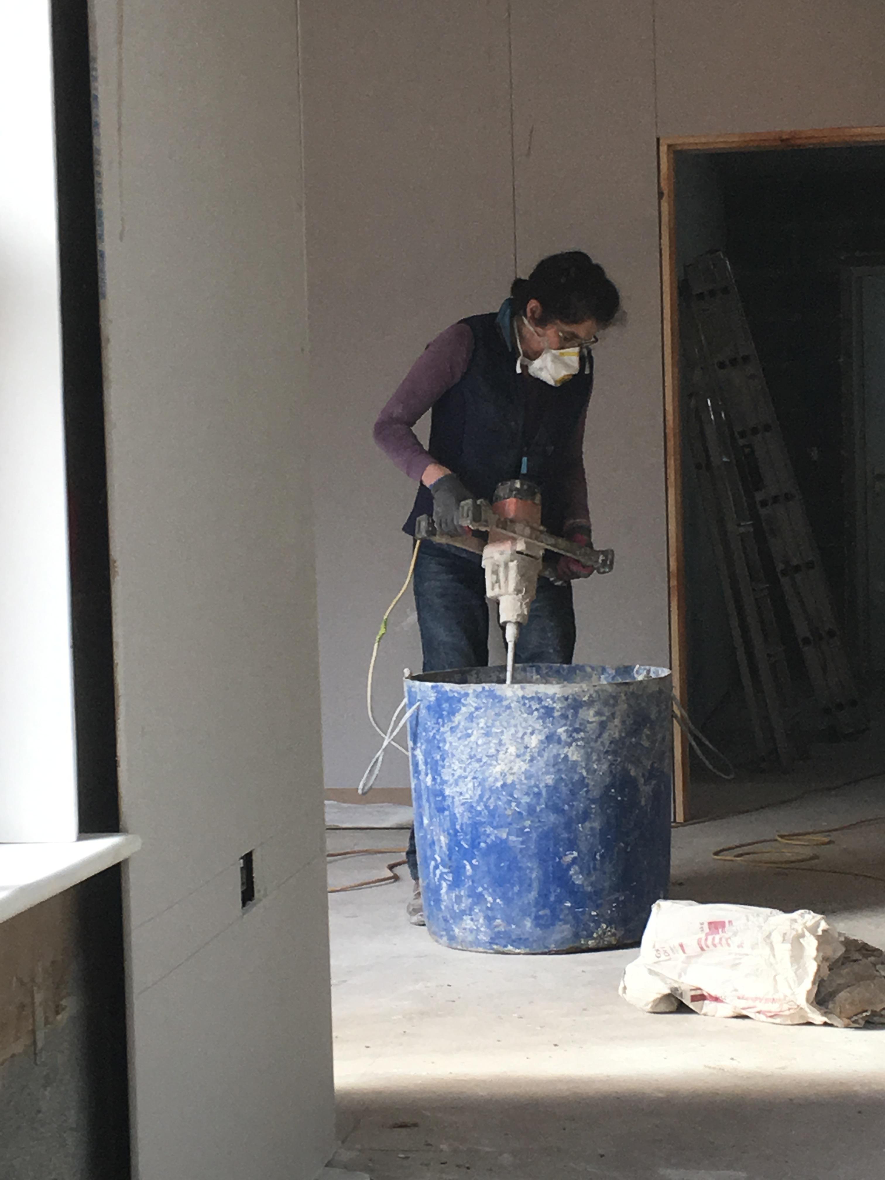

nod Posted August 1, 2018 Share Posted August 1, 2018 6 minutes ago, recoveringacademic said: Send her round. She's got the job. She knows where we live. Free cakes and coffee. Ian Will do Ian debs always worked in an office But loves building work She taped the house out and stapled the beads on prior to us skiming out And kept telling that she hadn’t had proper training and to stop rushing her Link to comment Share on other sites More sharing options...
