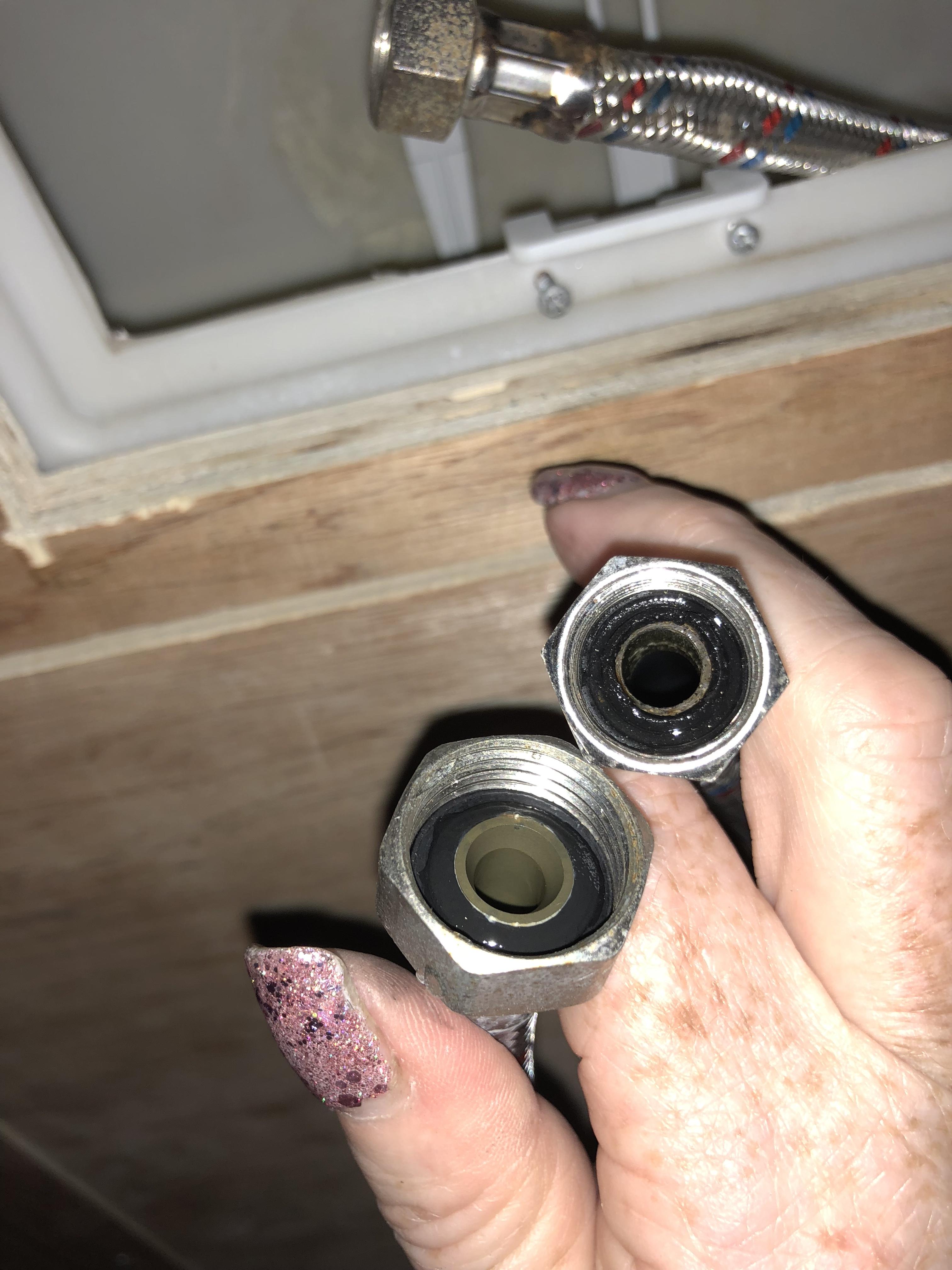

newhome Posted July 29, 2018 Author Posted July 29, 2018 12 hours ago, PeterW said: In fact .... in that shower in the spare ensuite, there should be a hose ..! Nick one from that ..! Too big. I had to change the fitting on the inlet valve to the 3/8" one so assume I need 3/8" washers? These be ok? https://www.amazon.co.uk/Assorted-Tap-Washers-Inch-Pack/dp/B008IFOK5A/ref=sr_1_4?s=diy&ie=UTF8&qid=1532857538&sr=1-4&keywords=tap+washer+3%2F8"

newhome Posted July 29, 2018 Author Posted July 29, 2018 1 minute ago, Nickfromwales said: Dont overtightnen it So you mean my plan of getting the grippers and doing it up as tight as I could get it wasn't a good one then ...
Nickfromwales Posted July 29, 2018 Posted July 29, 2018 1 minute ago, newhome said: So you mean my plan of getting the grippers and doing it up as tight as I could get it wasn't a good one then ... If you use a rubber seal and its plastic components, the rule of thumb is tighten it so far and try it, if it drips, give it another 1/4 turn, repeat. 1
newhome Posted July 29, 2018 Author Posted July 29, 2018 1 minute ago, Nickfromwales said: If you use a rubber seal and its plastic components, the rule of thumb is tighten it so far and try it, if it drips, give it another 1/4 turn, repeat. The components are metal. Metal pipe screwing onto metal pipe, rubber washer.

newhome Posted July 29, 2018 Author Posted July 29, 2018 This might sound like an odd strategy given that I hadn’t fixed loo number 1 but I dismantled number 3 so that I could fix number 1. I removed the flexible hose from guest bed 2 and moved it to the downstairs shower room. I didn’t want to do that with the second one I dismantled as the inlet valve seems ok in that one so I’m leaving that be and just fitting a new flush valve. That bedroom has only been slept in for 6 nights since the house was built. The inlet In number 3 wasn’t even attached properly which meant it was affecting the flush valve operation! ? The washer I need doesn’t look like a normal tap washer with a small hole, it’s more a ring that goes around the outside as per the photo. Larger size is half inch, smaller is 3/8” and that’s the one I need. If not called ‘tap washers’ what are they? Anyway I fitted the swapped hose, (tightened carefully by hand @Nickfromwales ?) and it all seems to work. No leaks, water shuts off immediately when it gets to the correct level and flushes ok. Happy days. I still have to refit the flush plate but I’m going to leave that for a few days to ensure that everything is ok first. Just numbers 2-6 to sort now ? 1
