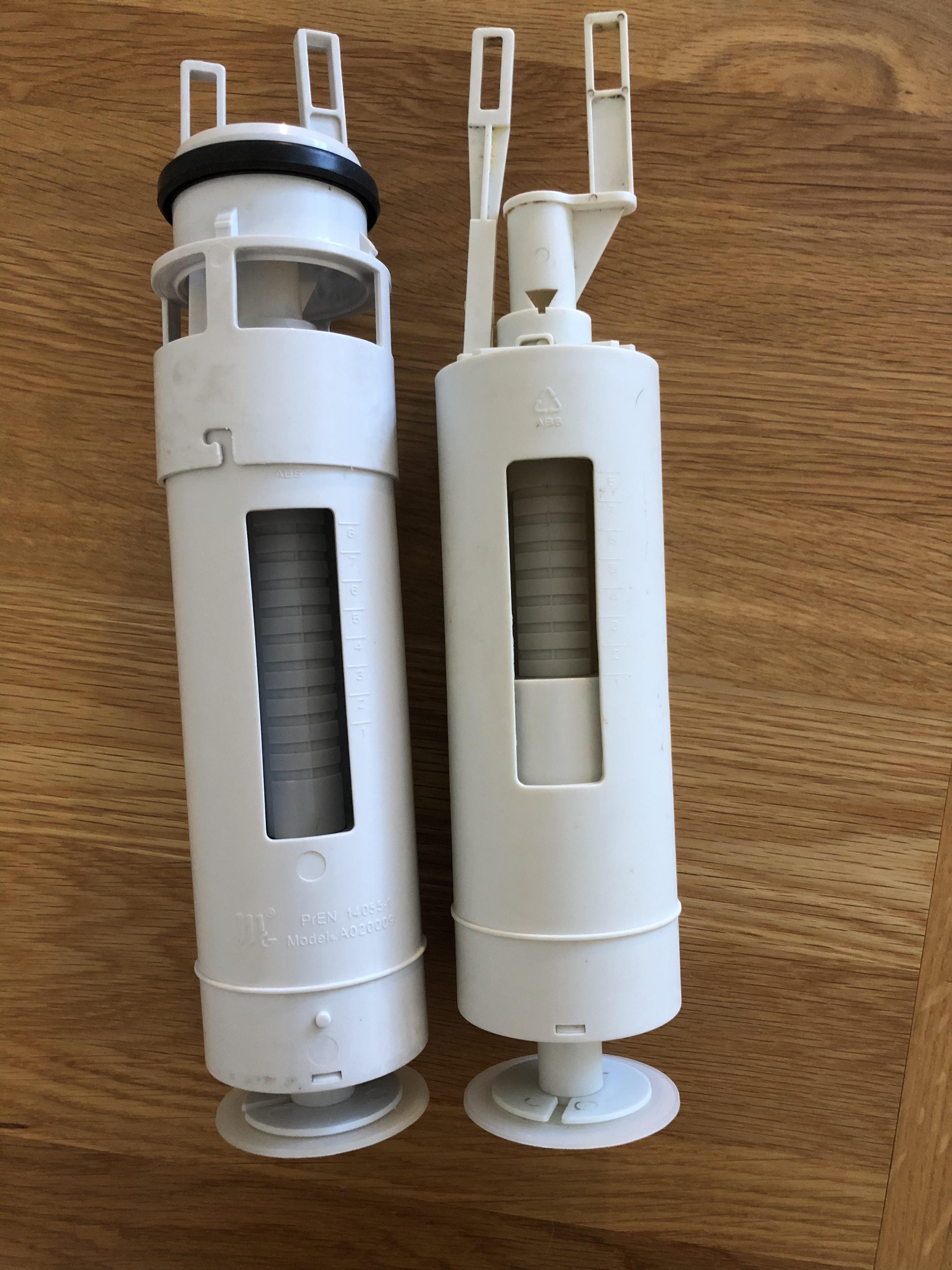

Posted
The new bits arrived today so I thought I would have a go at fitting them however the flush valve looks different. The one on the left is the new one, and the one on the right the old one. The old one looked the same as the one on their website but that’s not what has turned up.
Here is the one I ordered.
http://www.toiletspares.co.uk/ag1378-flush-valve.html
I’ve emailed them. Why is it that everything takes longer than planned ?

Posted
Rotate the top bit clockwise slightly and it will come off and the two will look the same ...
Thanks! He just emailed back and said this:
“The new one has the basket on the wrong end, we pack them like that to fit them in the box. Pull the basket off the top with the black rubber on and it should look exactly the same as your original. You will need to pull out you existing basket, put the new one on the new valve by twisting it in to place and fit the whole lot”
How the hell was I supposed to know that? How do you know that? Cos it’s obvious? :S
What does ‘pull out the basket’ mean? There’s another bit to remove? Where the hell is that?

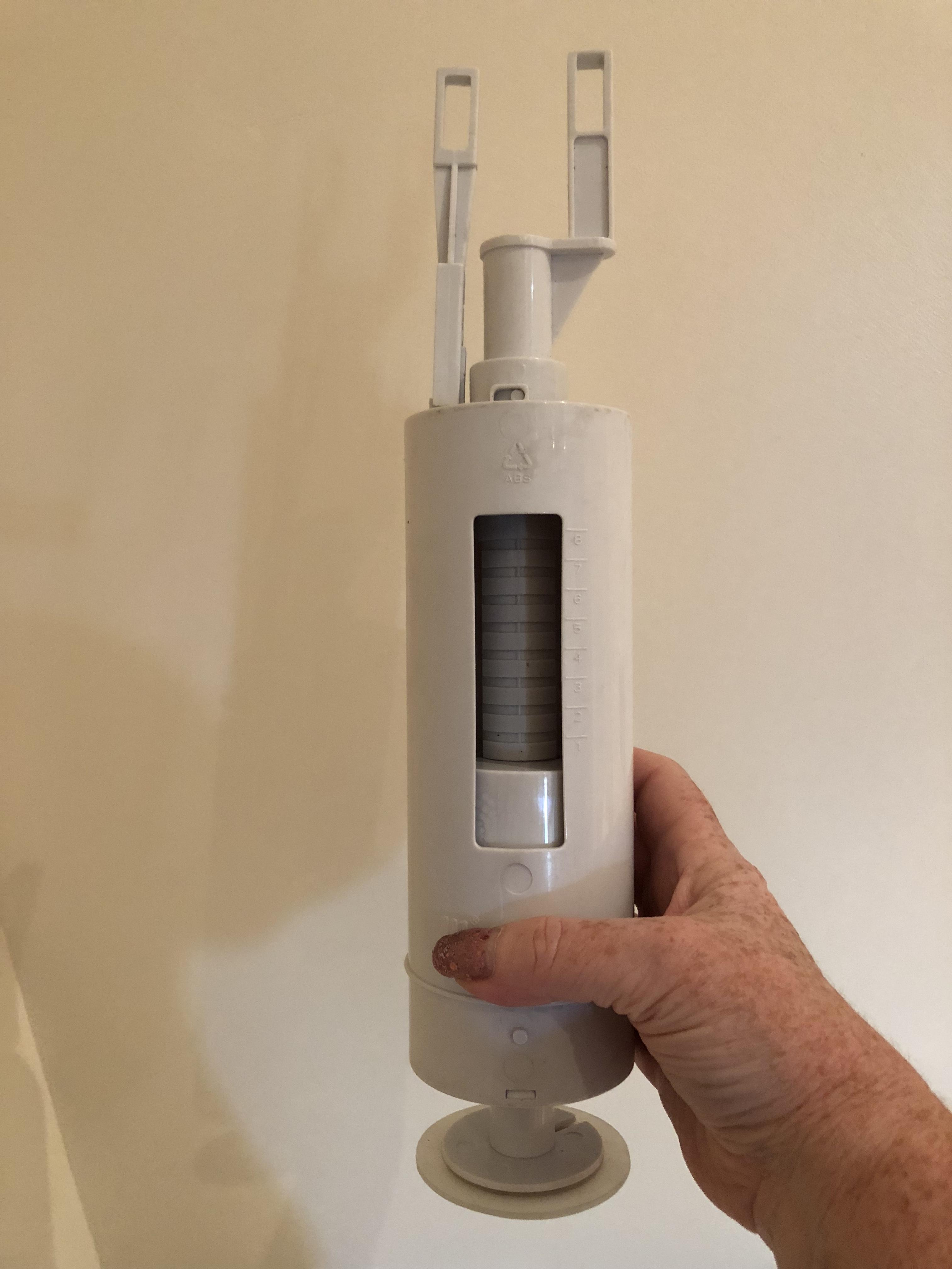

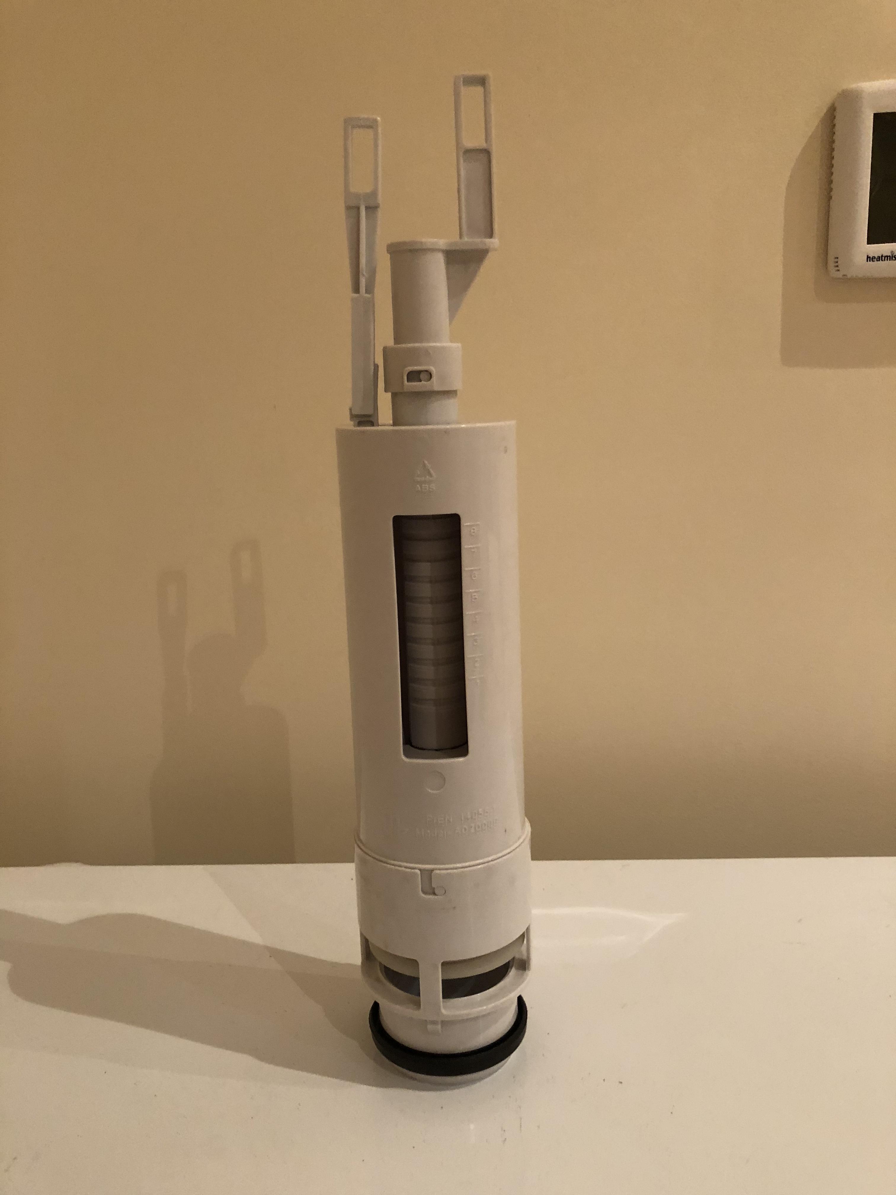

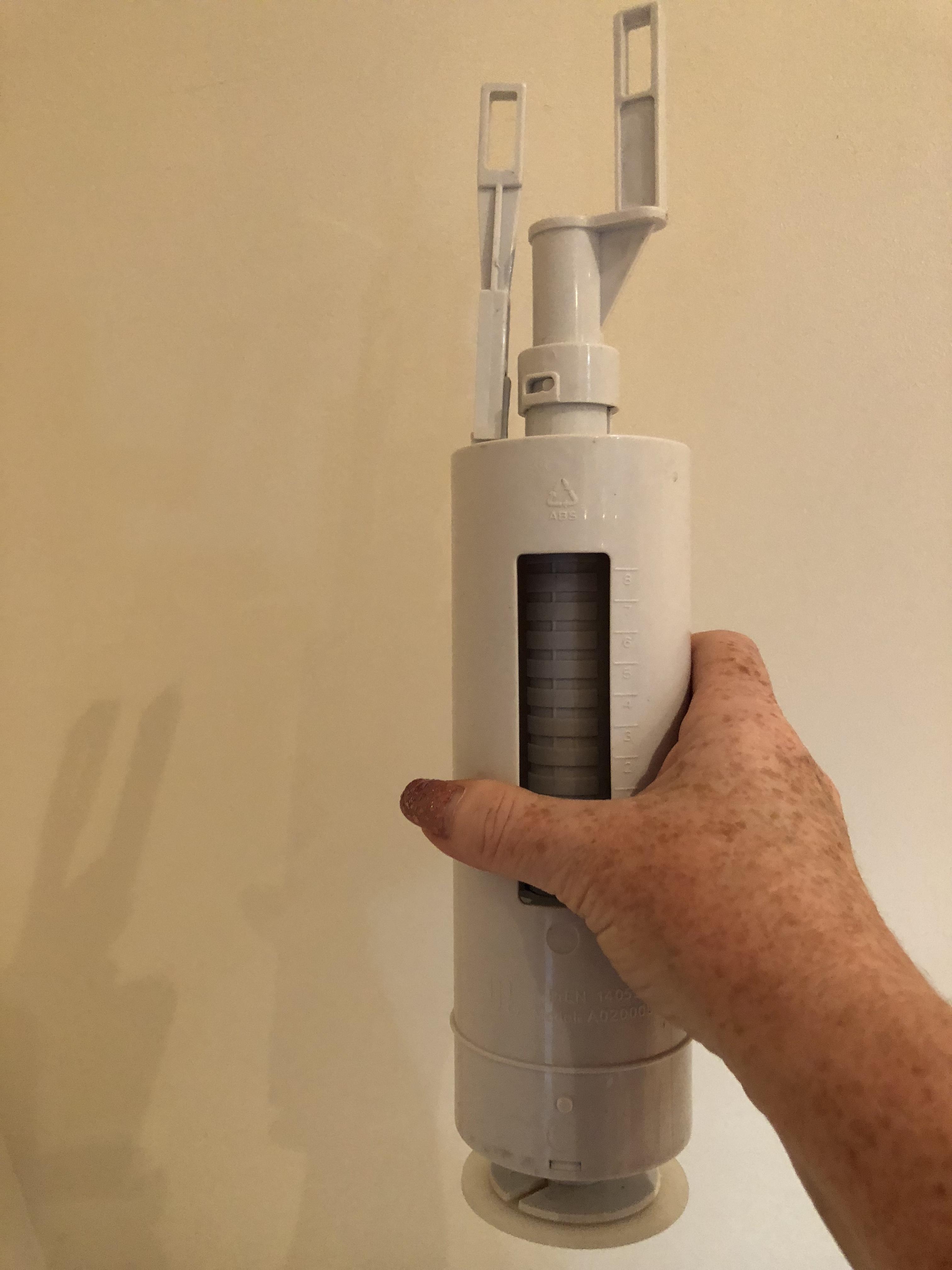

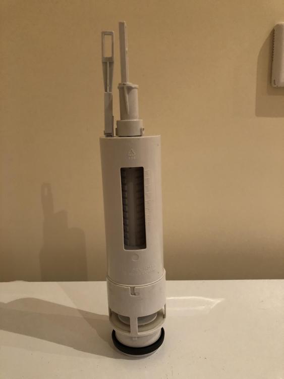

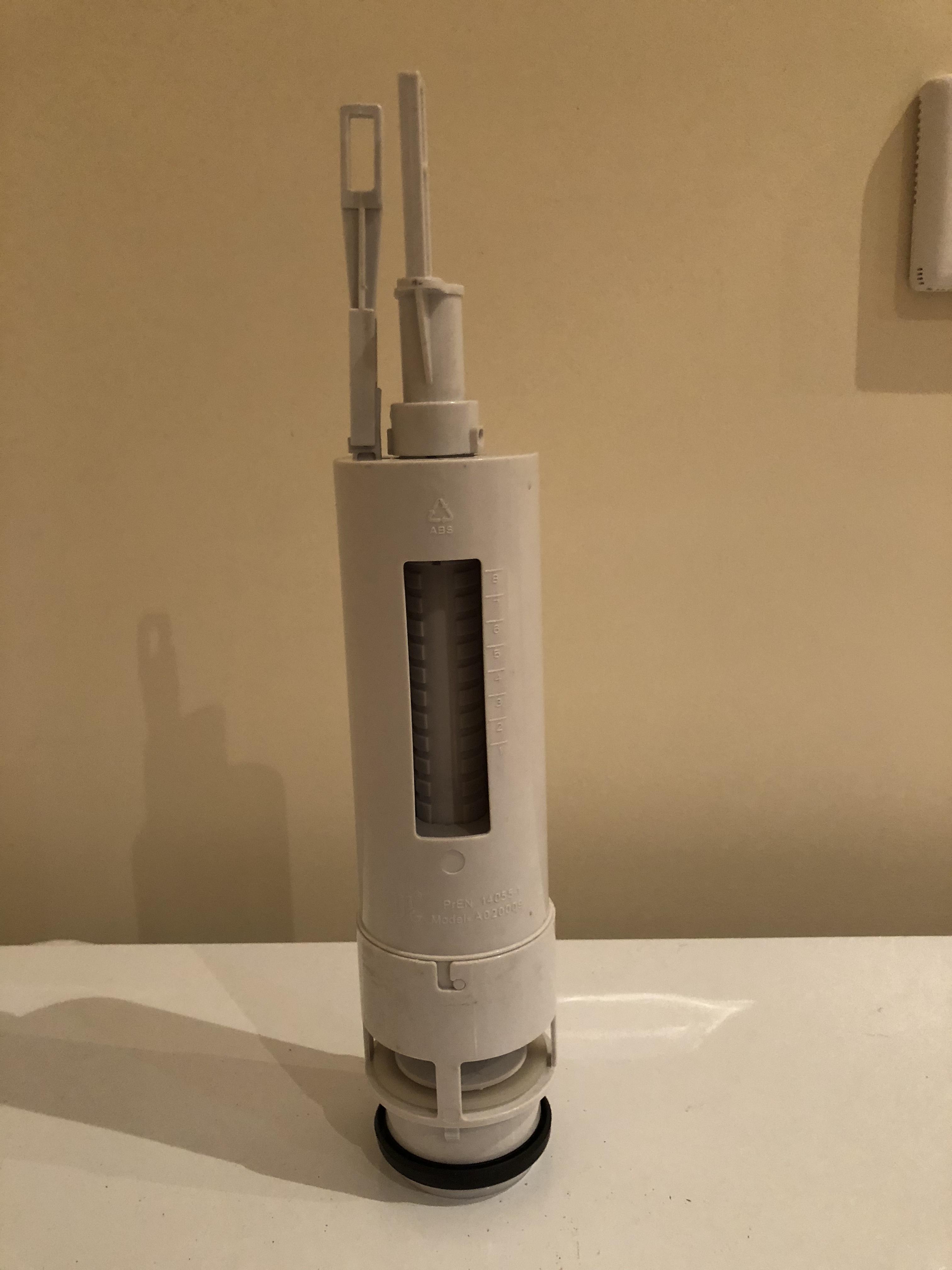

Progress of sorts. Flush valve is fitted and seems to be working ok. The second one I bought doesn’t seem right though.
The top bit that lifts to cause the flush is supposed to sit right down on the main unit like so.
There is a groove that it slides down as here
That one is the one I’ve fitted and seems ok.
The other one doesn’t sit flush with the main unit like so.
And there is no groove for it to slide down.
It only slides down if I twist it 90 degrees but the flush plate won’t ioerate it like that. Not sure if I should be twisting it somehow but can’t see how.

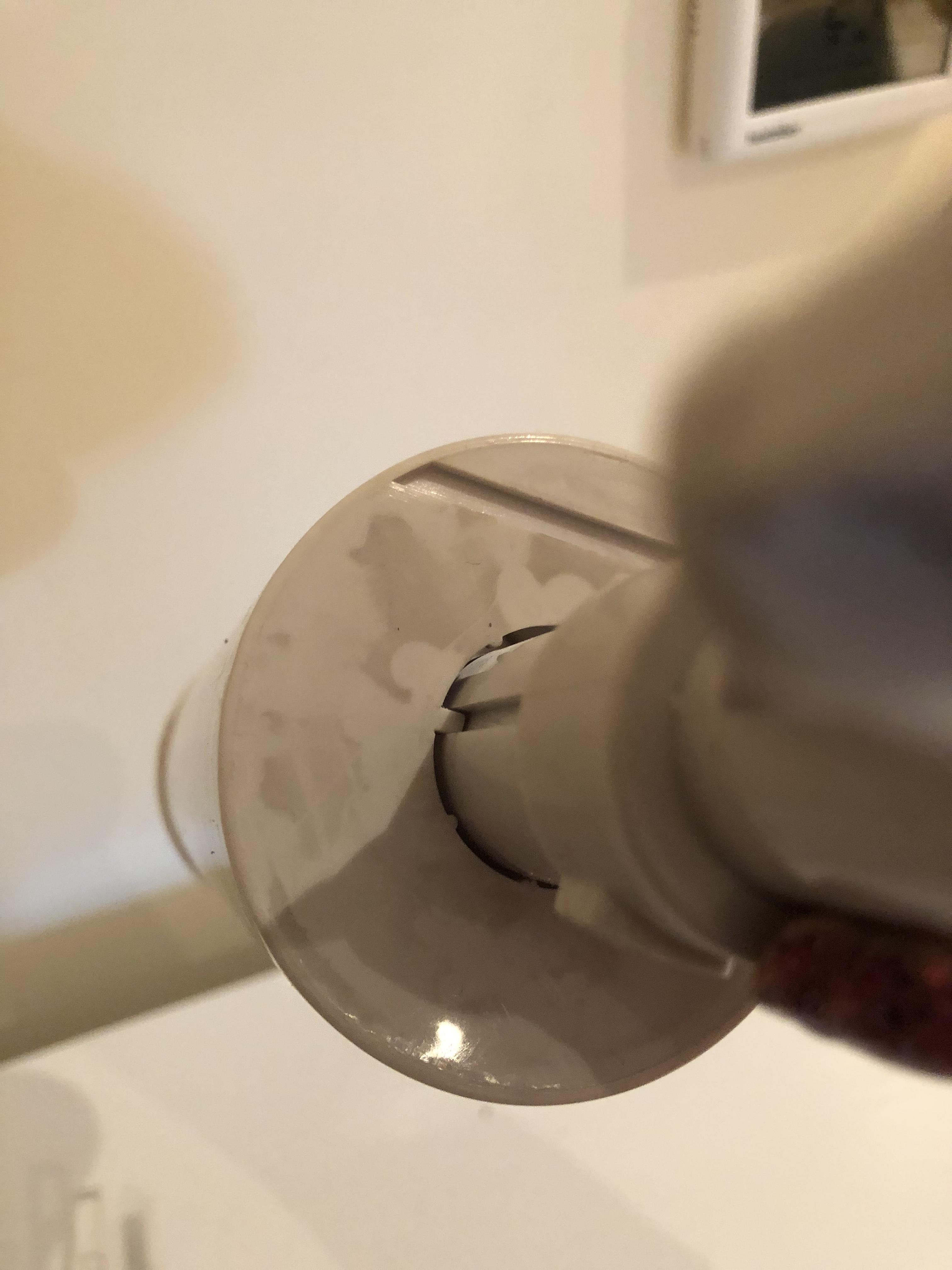

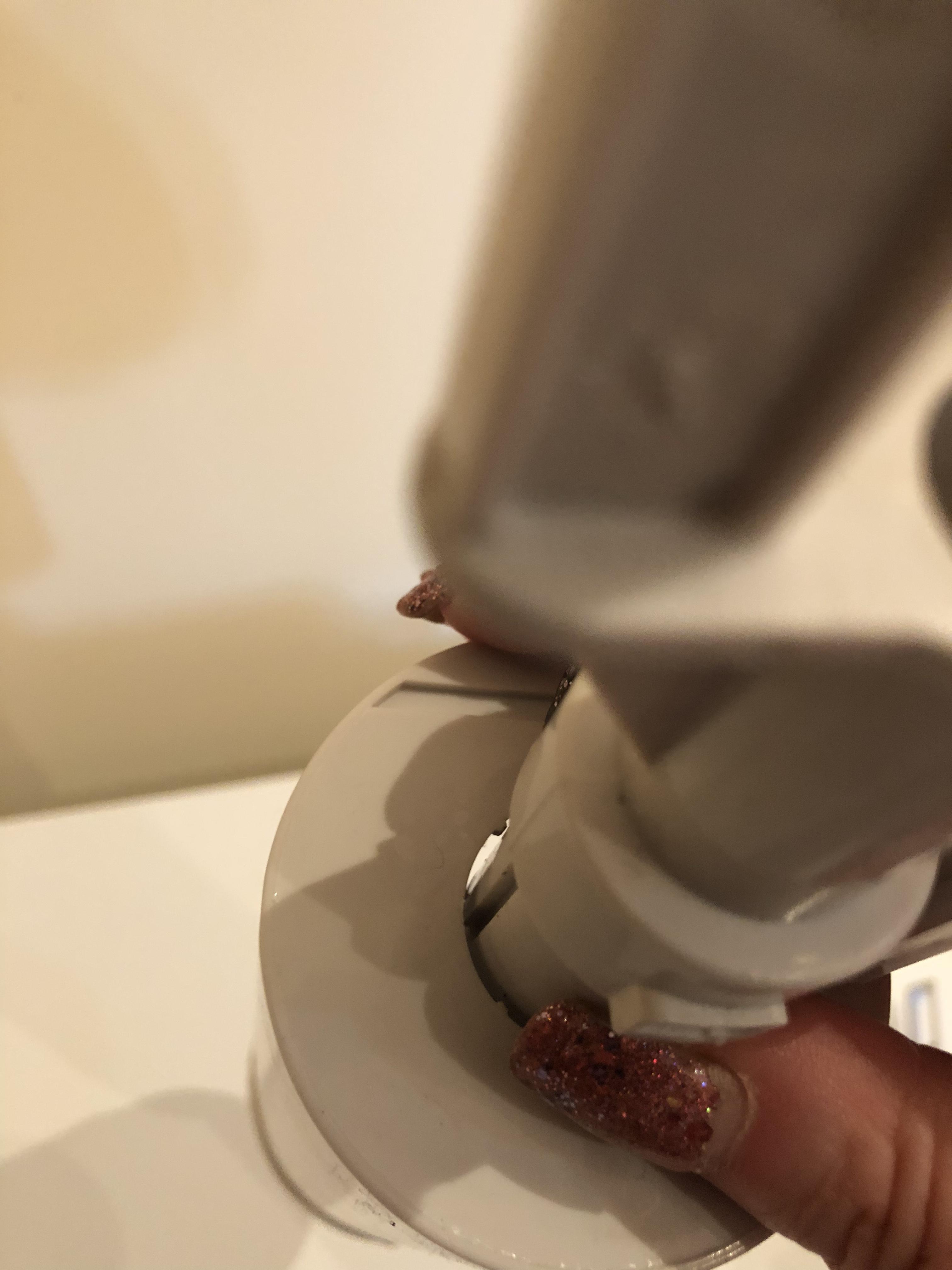

Posted
3 minutes ago, PeterW said:
You’ve put the funny black bit in at 90 degrees out ... (bit that was on top of the new flush when it came)
That’s not fitted though. That bit goes right on the bottom :S
Here it is with that bit fitted. When it’s facing the right direction it doesn’t go down to make the seal.
It only goes down if I twist it 90 degrees and it clearly won’t work like that.

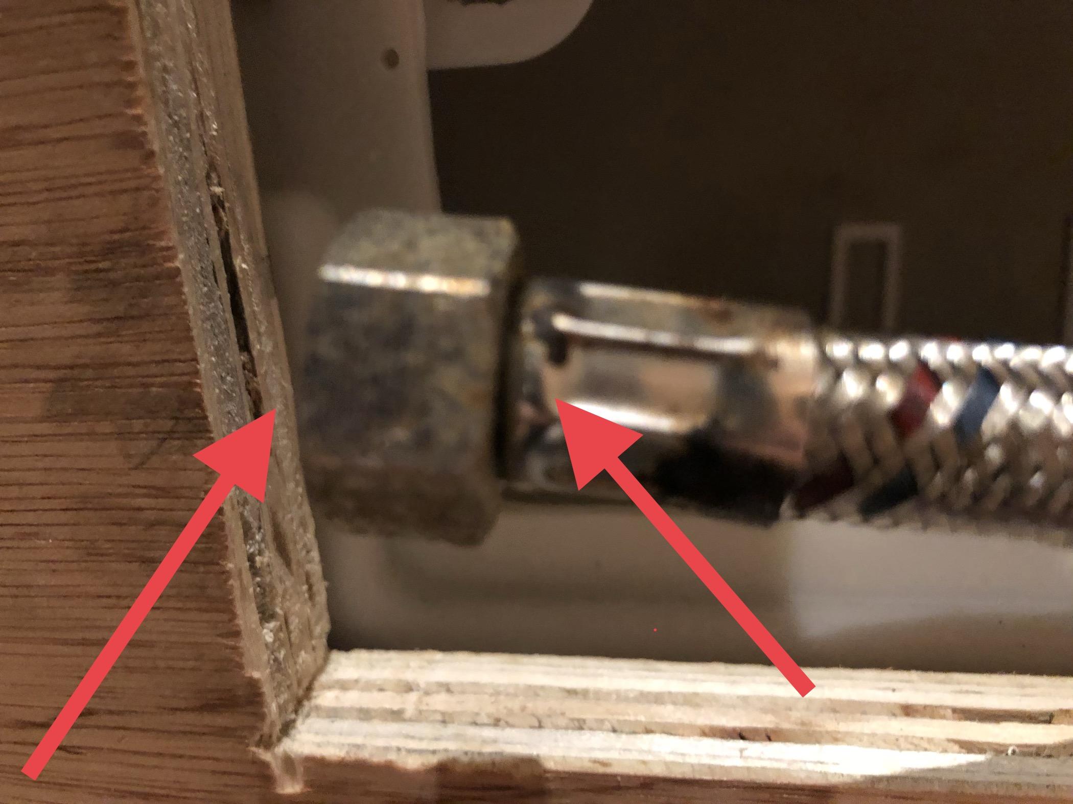

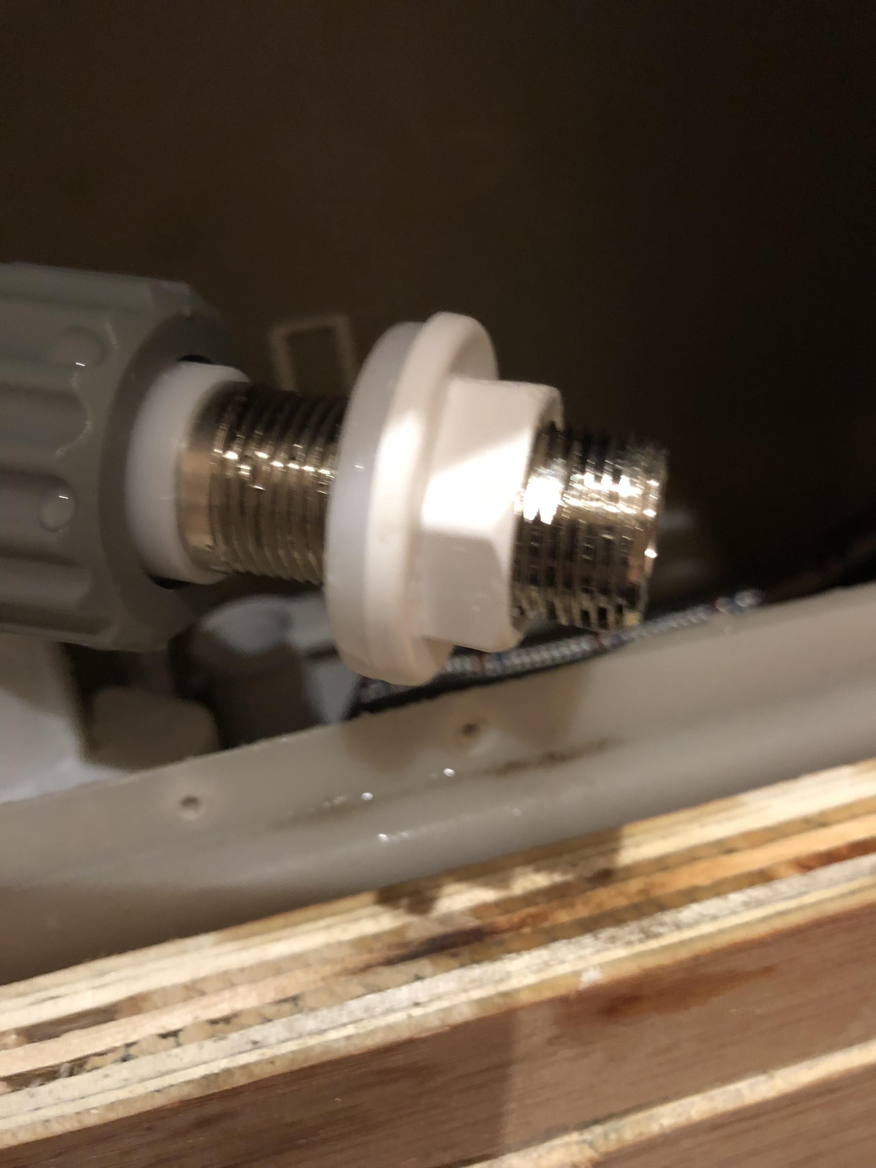

I also tried fitting the inlet valve. I had to change the 1/2” fitting to the 3/8” fitting. The good news is that it stops filling immediately when it reaches the right lever. The not so good news is that it leaks where it connects to the pipe. Both sides where the arrows are. Do I need washers or something?
It also doesn’t sit right into the bracket as it’s a different shape so will have to cable tie it on or something.
Posted
Should be a rubber washer inside the end of the silver pipe ..?
Perished. Fell to bits.
Posted
13 minutes ago, PeterW said:
Need a new one then ...
Aye, but being thick and not knowing what size to get should I just go for something like this? Will a washer stop the water leaking from both sides of the connector?

Posted
Its leaking both sides as the hose flange isn’t tight up against the end of the fill valve so water is leaking around it. Washer will sort that.
These will fit. Hose washer
Posted
Just now, PeterW said:
In fact .... in that shower in the spare ensuite, there should be a hose ..! Nick one  from that ..!
