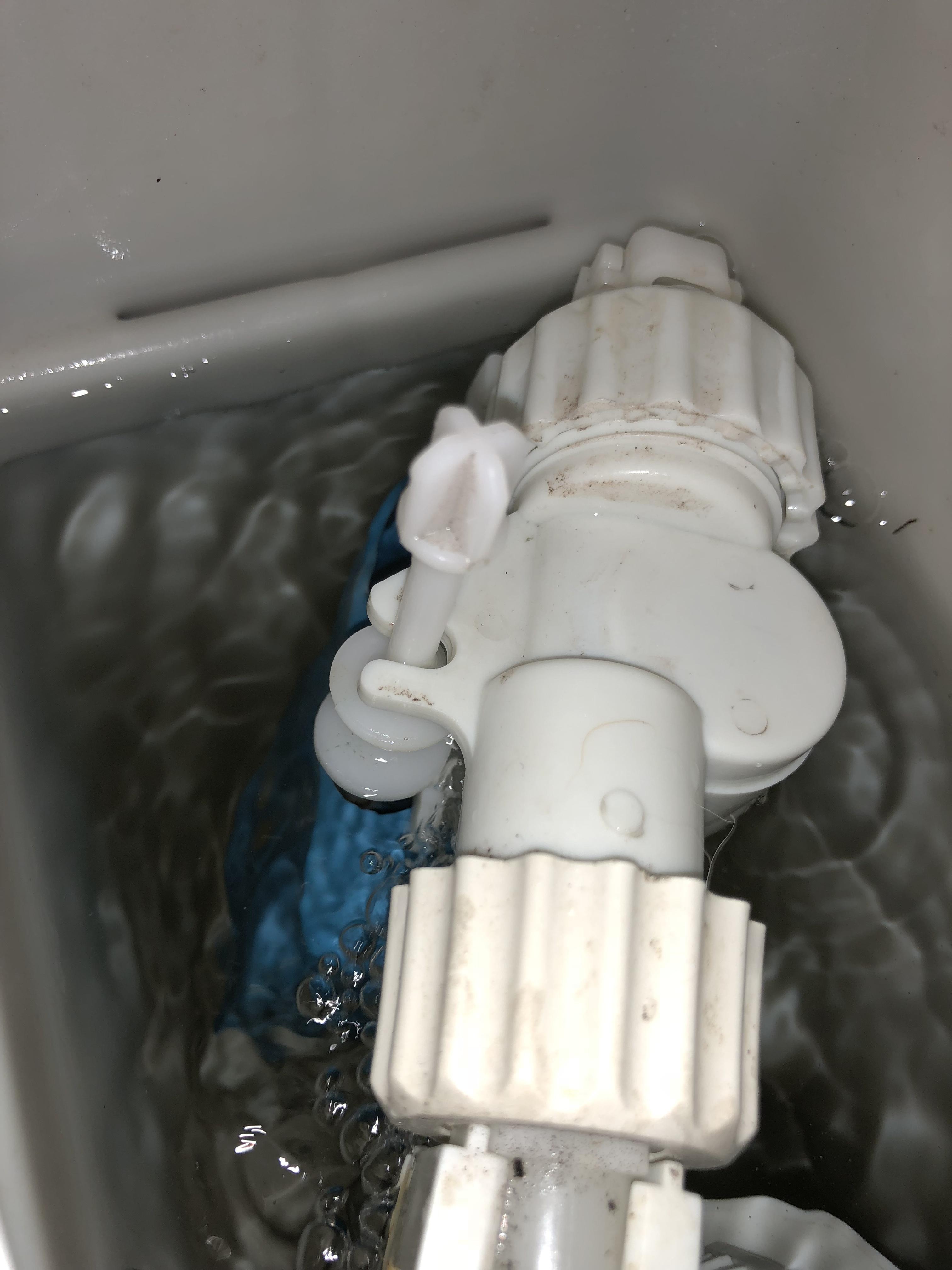

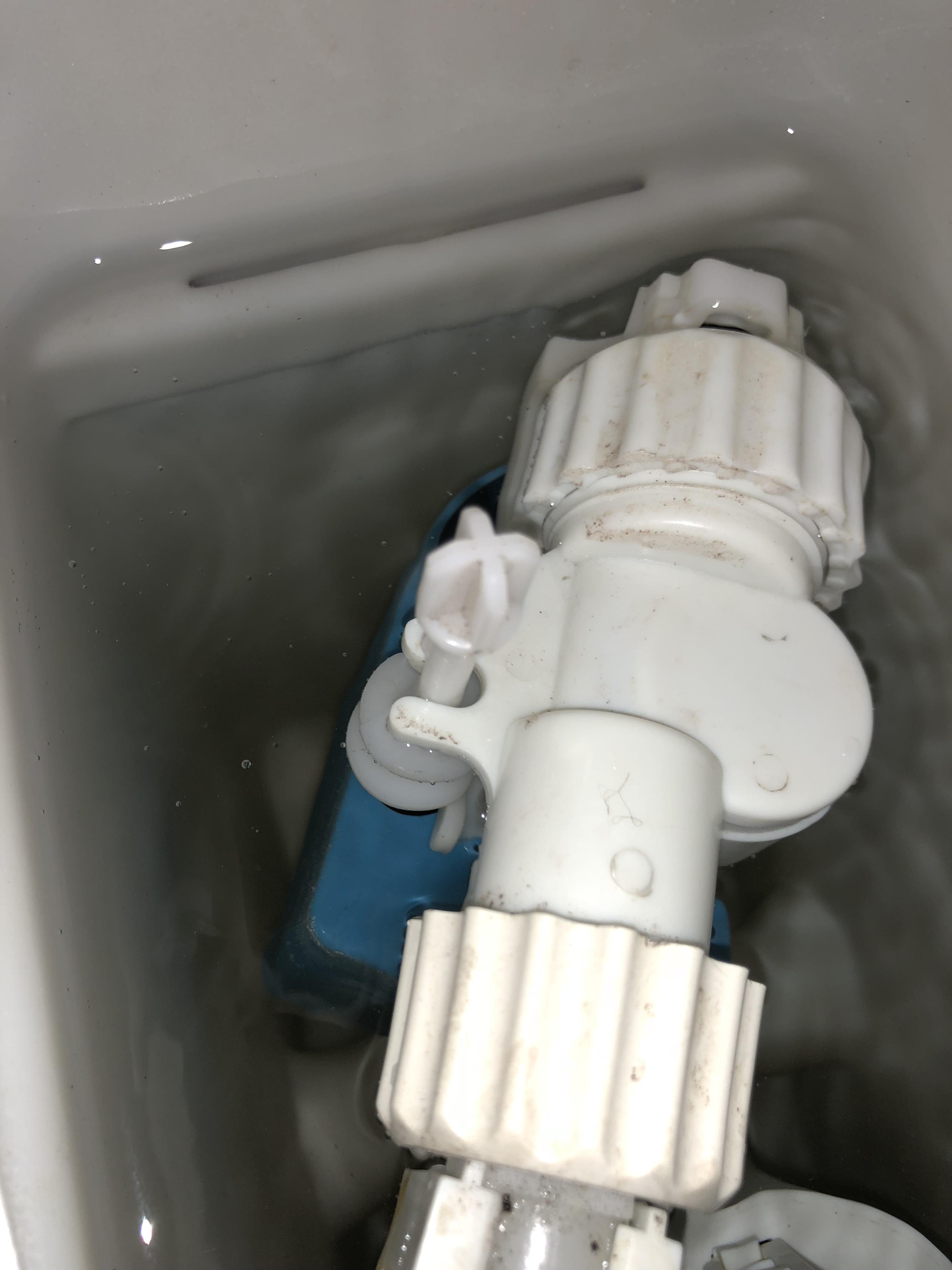

newhome Posted July 20, 2018 Author Posted July 20, 2018 (edited) 35 minutes ago, PeterW said: Screw the big valve back in... turn the arrowed thing so the blue float goes down. And no, won’t come off The thing screwed back in ok I think, well it’s no longer loose anyway but the water is still pissing leaking out. Tried turning that thing both ways but still no joy. Edited July 20, 2018 by newhome

PeterW Posted July 20, 2018 Posted July 20, 2018 5 minutes ago, newhome said: The thing screwed back in ok I think, well it’s no longer loose anyway but the water is still pissing leaking out. Tried turning that thing both ways but still no joy. Yep water is going over the weir in the middle. Where is the blue float thing

ProDave Posted July 20, 2018 Posted July 20, 2018 28 minutes ago, newhome said: The thing screwed back in ok I think, well it’s no longer loose anyway but the water is still pissing leaking out. Tried turning that thing both ways but still no joy. Turn it ALL the way. One way will shut the water off. Is the float free to move up and down? Sometimes things can get assembles wrong so the float is not free to move up and down, then it will not rise and shut the water off, so make sure the blue float can freely move up and down. If it really won't shut off, then the problem is with the fill valve and you need to start examining that. 1

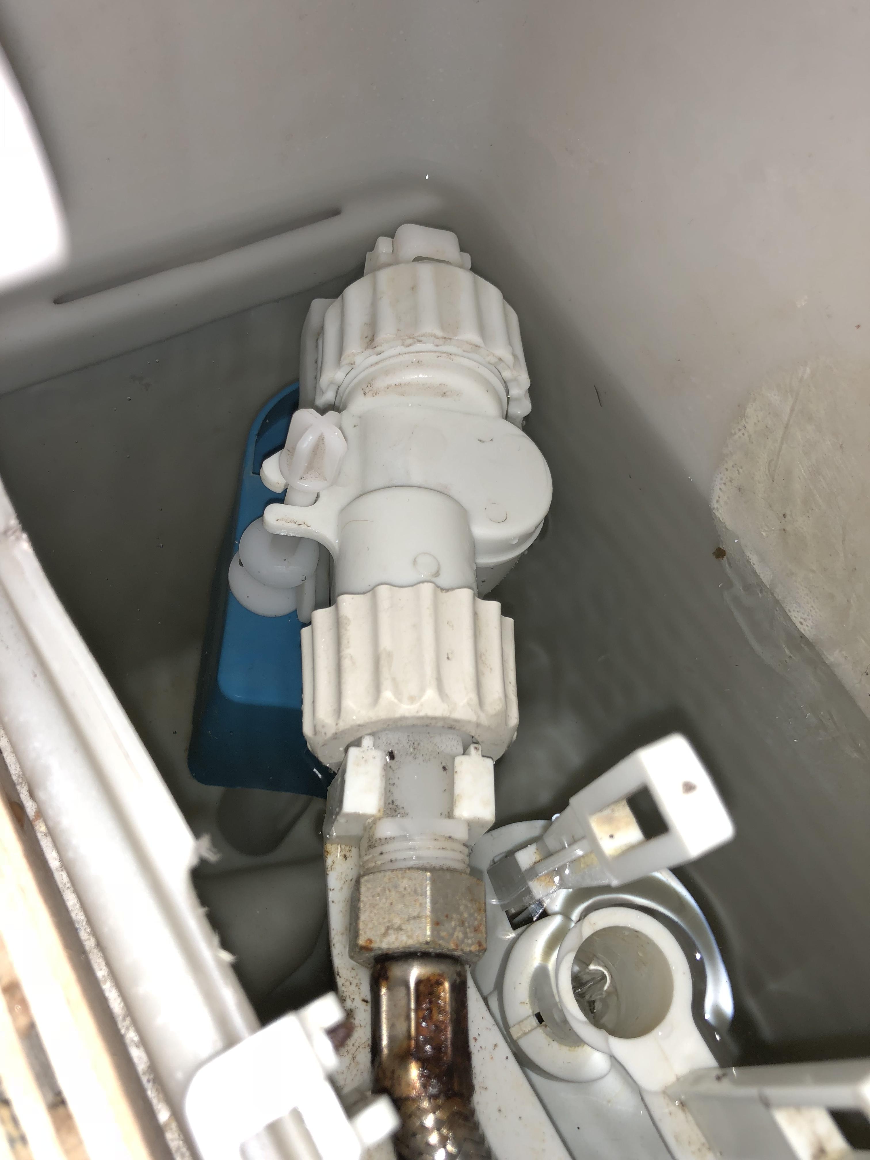

newhome Posted July 20, 2018 Author Posted July 20, 2018 26 minutes ago, PeterW said: Yep water is going over the weir in the middle. Where is the blue float thing Here. It’s as bad as it can be now so the only way is up
ProDave Posted July 20, 2018 Posted July 20, 2018 That looks to me like the float is wedged against the side if the cistern at the bottom and not floating up. Turn the whole fill valve a little anti clockwise to clear the float away from the side of the cistern. 1

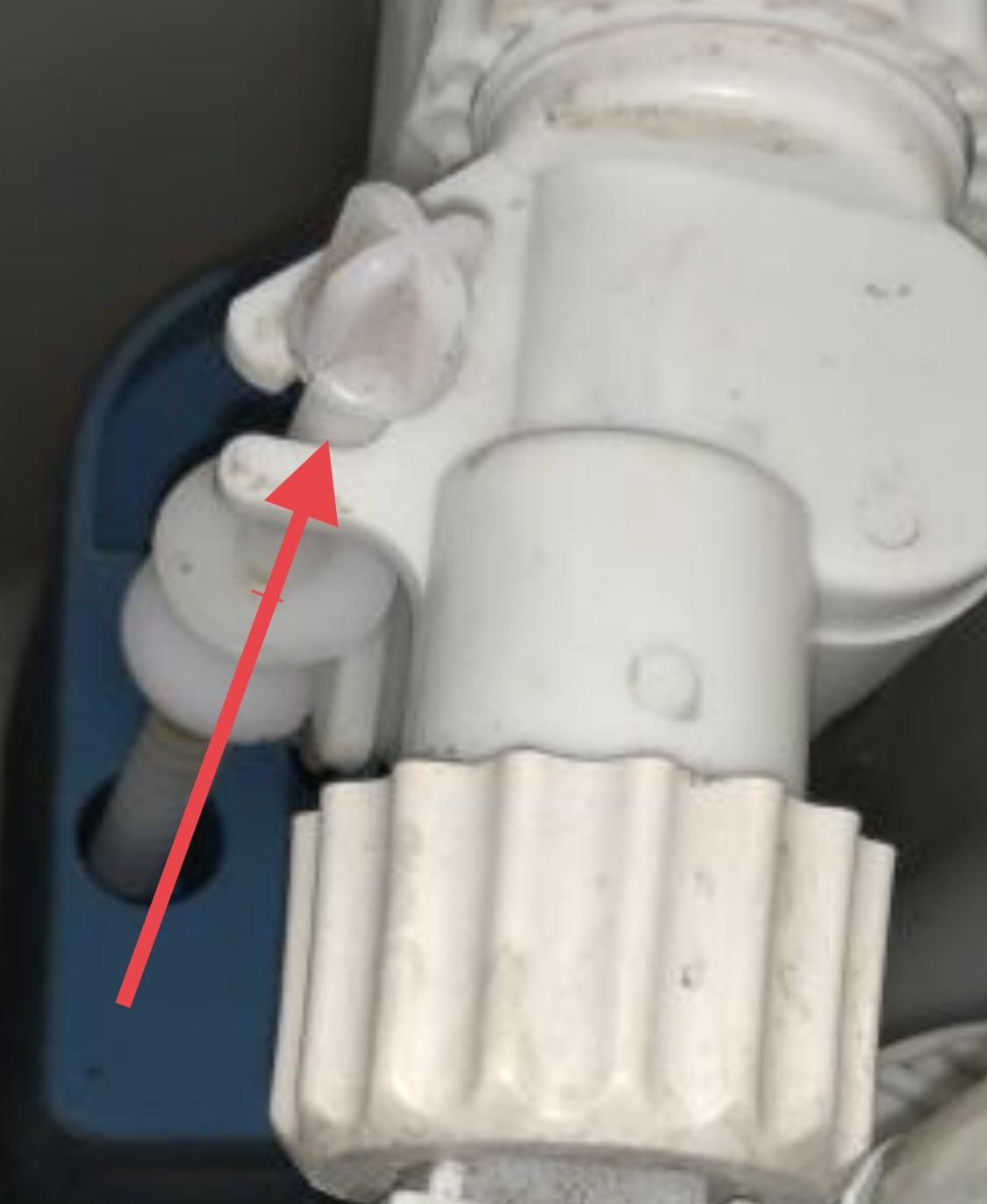

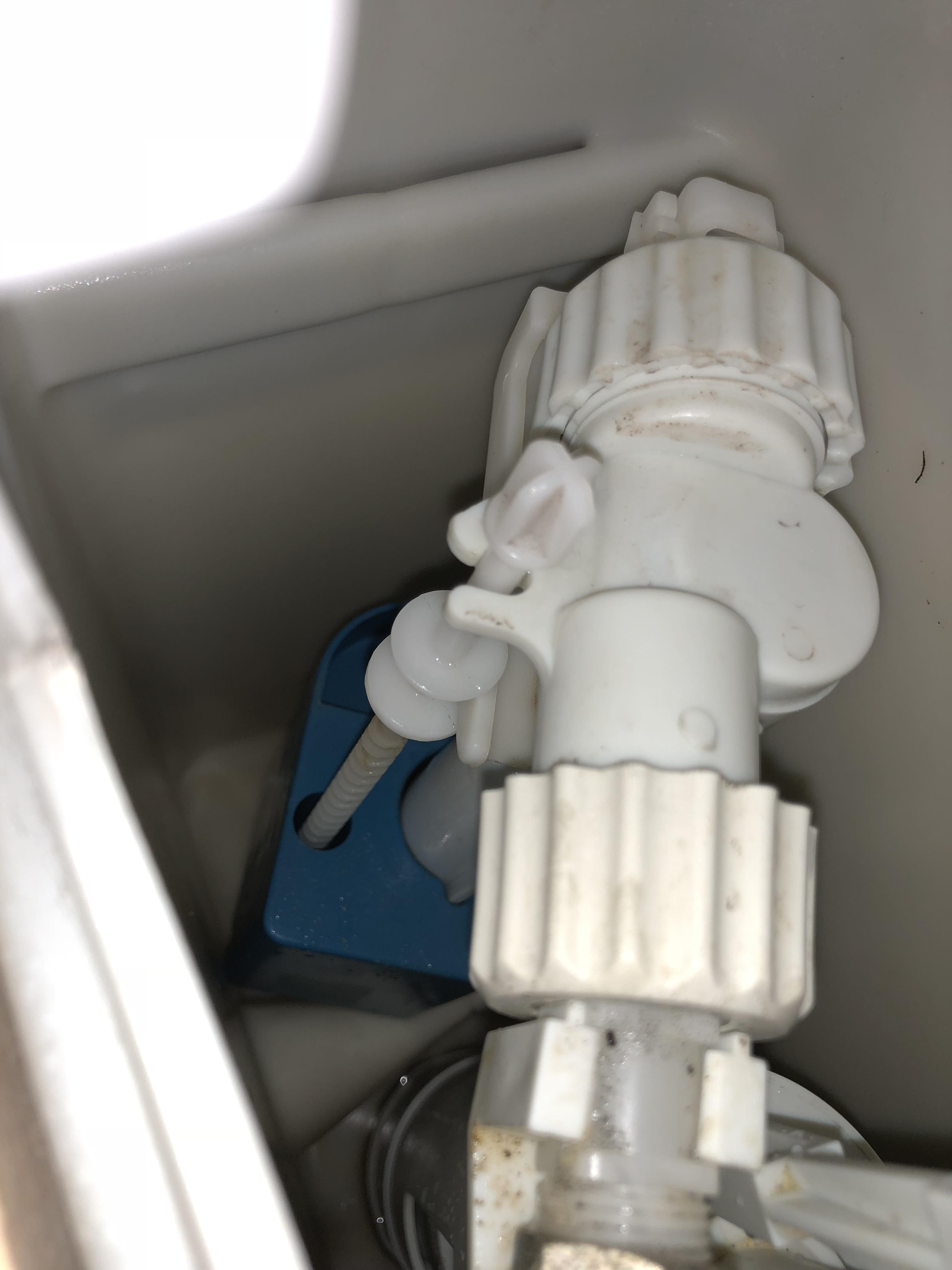

PeterW Posted July 20, 2018 Posted July 20, 2018 Think I’ve spotted the issue. The float should lift the lever marked with a red arrow. It should be between the two flanges arrowed in blue. That’s why when you lift the rod it shuts the valve. You may be able to push the rod sideward a little to get the lever back in. 1

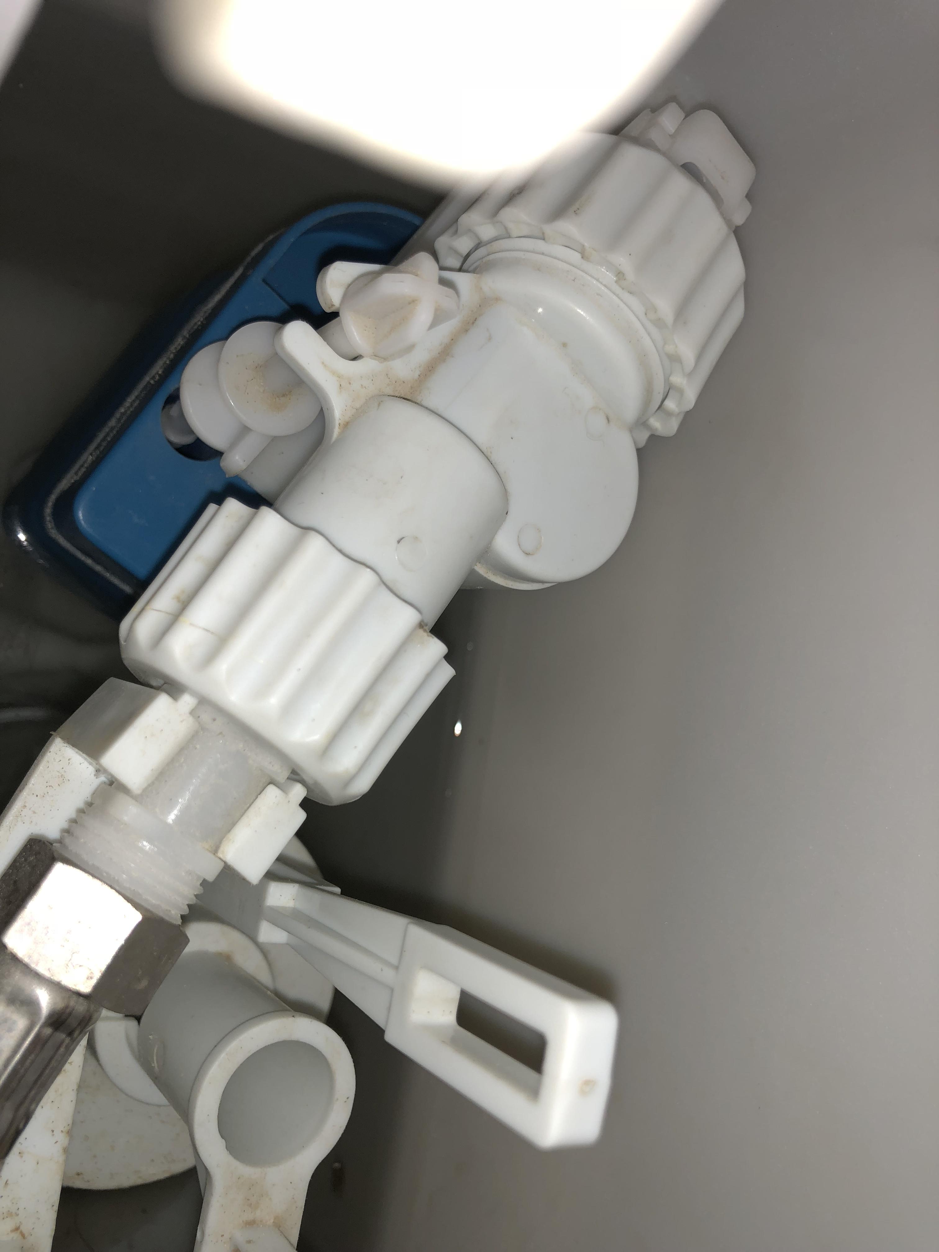

newhome Posted July 20, 2018 Author Posted July 20, 2018 So, turned all the way anti-clockwise in photo 1. Water peeing out. Turned all the way clockwise and it’s better but still leaking out the same as when I started. Friday night, sitting backwards on a bog in my first plumbing ‘twatclass’ having only ever connected up a dishwasher previously. Oh I know how to live . Come on guys I need a bit of pee taking (pun intended) to keep me going, or are you all in the land of nod ?
PeterW Posted July 20, 2018 Posted July 20, 2018 Right need you to try and unclip the rod and move it down slightly to move the lever up and down.
newhome Posted July 20, 2018 Author Posted July 20, 2018 12 minutes ago, PeterW said: Think I’ve spotted the issue. The float should lift the lever marked with a red arrow. It should be between the two flanges arrowed in blue. That’s why when you lift the rod it shuts the valve. You may be able to push the rod sideward a little to get the lever back in. Yes that’s different from the one upstairs here and I’ve clearly screwed that up as I think it was in that position earlier.
PeterW Posted July 20, 2018 Posted July 20, 2018 It will lift up when the float hits the top and then the lever lifts and the valve stops. 1
newhome Posted July 20, 2018 Author Posted July 20, 2018 I’ve ‘fixed’ the lever thing I think. Photo 1 is all the way anti clockwise and photo 2 all the way clockwise. Photo 2 is better but still about the same as when I started ?

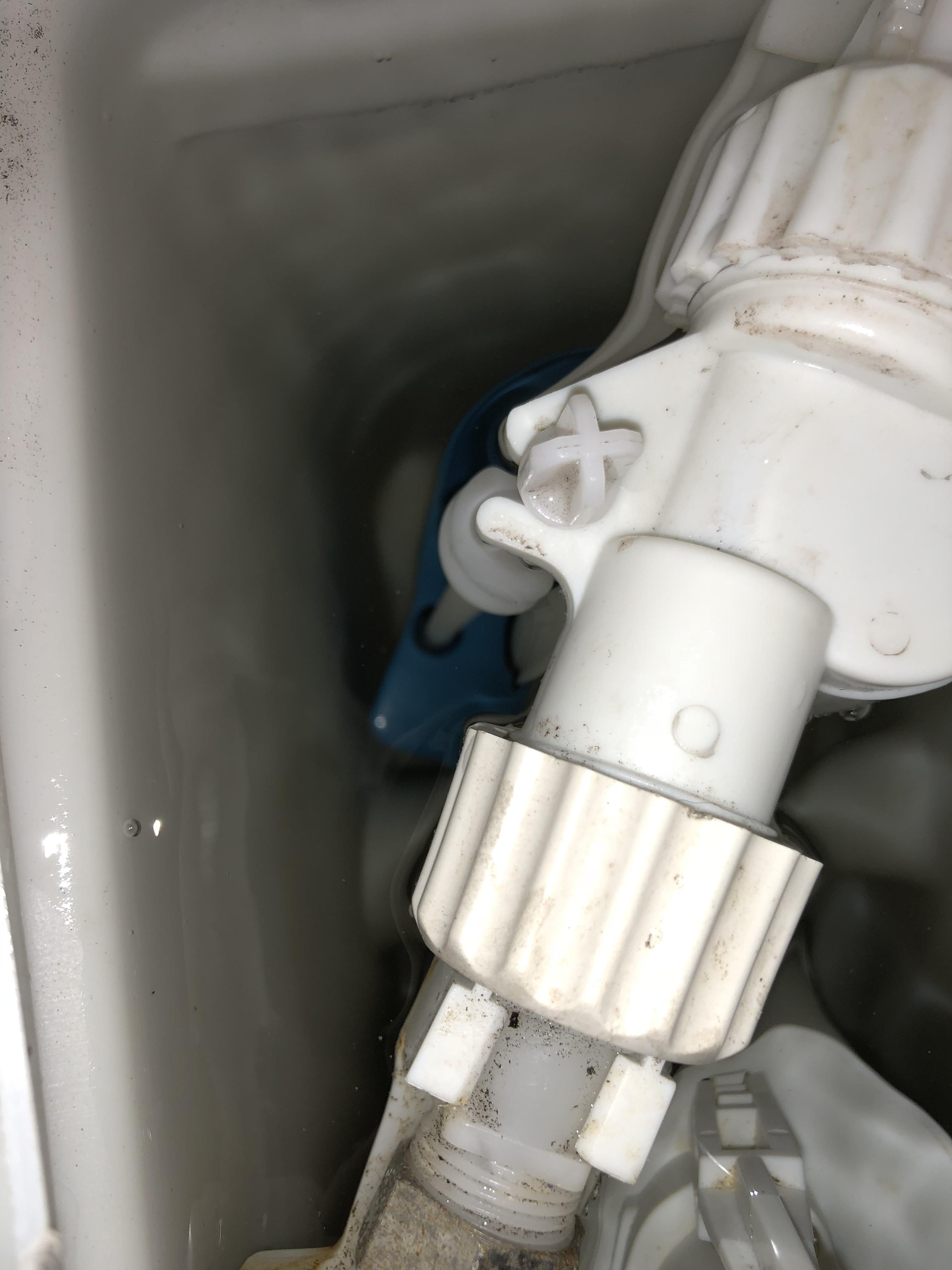

PeterW Posted July 20, 2018 Posted July 20, 2018 Ok the float is too far up - turn it anti clockwise so the float moves downward. Flush it and see if the water level stops below the top of the white tube. 1

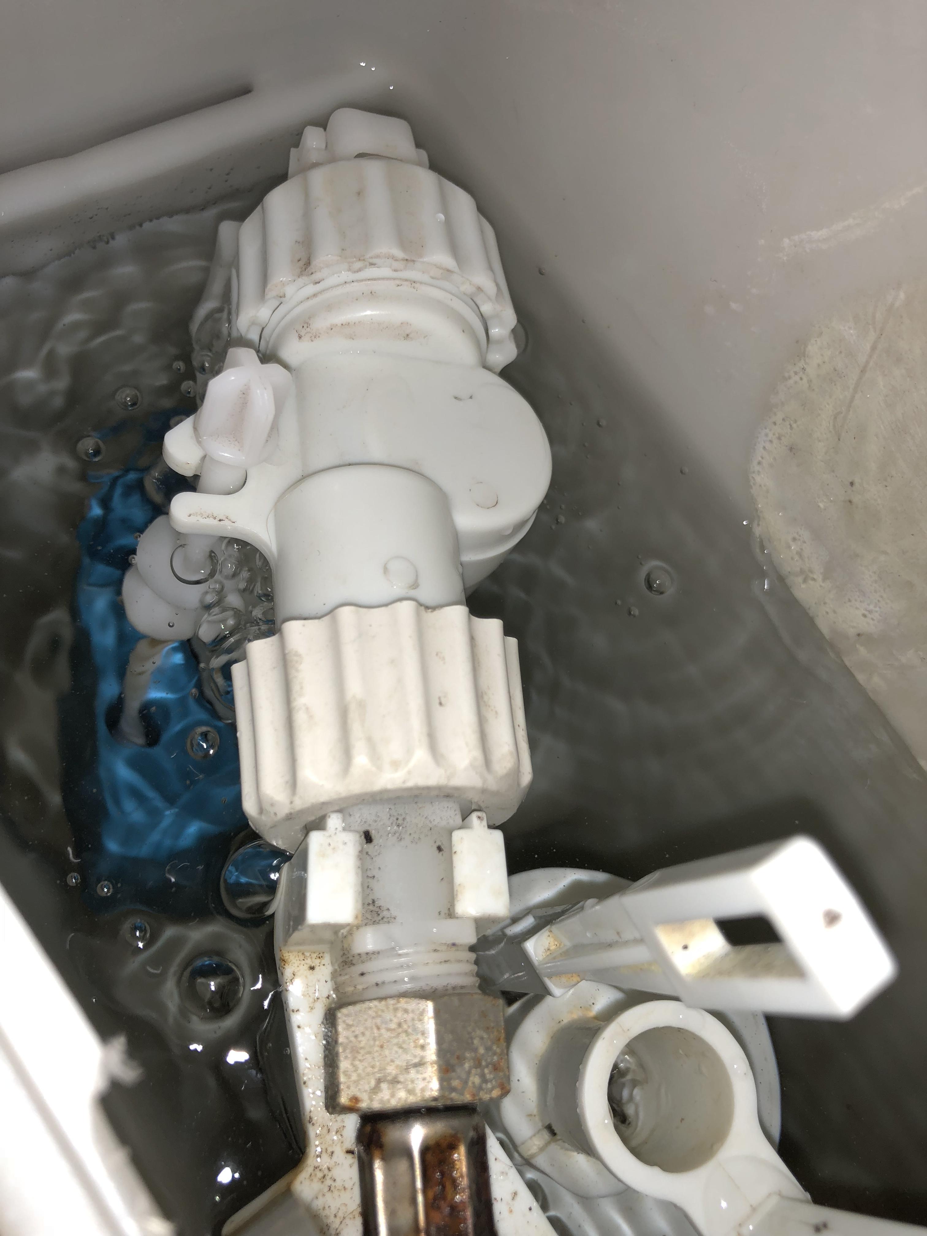

newhome Posted July 20, 2018 Author Posted July 20, 2018 Tried that. The water starts syphoning out into the loo before it reaches that point as in here, and the water keeps rising.

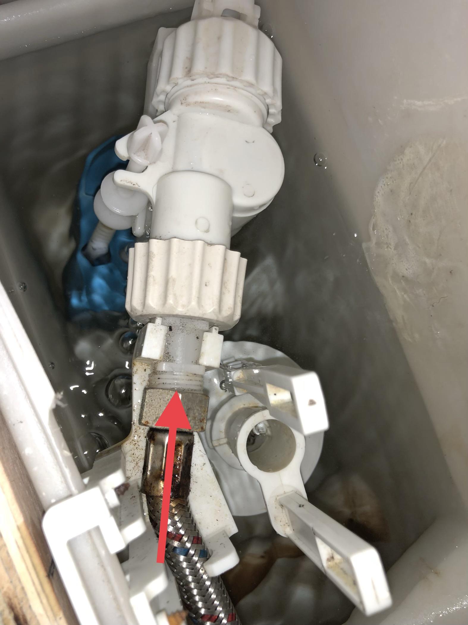

PeterW Posted July 20, 2018 Posted July 20, 2018 Fill valve is fecked then. Can be replaced fairly easy - silver valve turned off and the plastic bit before the threaded hose clips into the white retainer. All comes out and the hose detaches. Should have a manufacturer on the valve as they need the slim plastic section to clip in. 1
newhome Posted July 20, 2018 Author Posted July 20, 2018 5 minutes ago, PeterW said: Fill valve is fecked then. Can be replaced fairly easy - silver valve turned off and the plastic bit before the threaded hose clips into the white retainer. All comes out and the hose detaches. Should have a manufacturer on the valve as they need the slim plastic section to clip in. Unscrew this metal bit you mean?

PeterW Posted July 21, 2018 Posted July 21, 2018 7 hours ago, newhome said: Unscrew this metal bit you mean? Yes but only when you’ve got it out.... water valve off and then grab the top of the fill valve near the middle and lift it up and back - it should come loose. Bring it out through the front then undo the nut.
