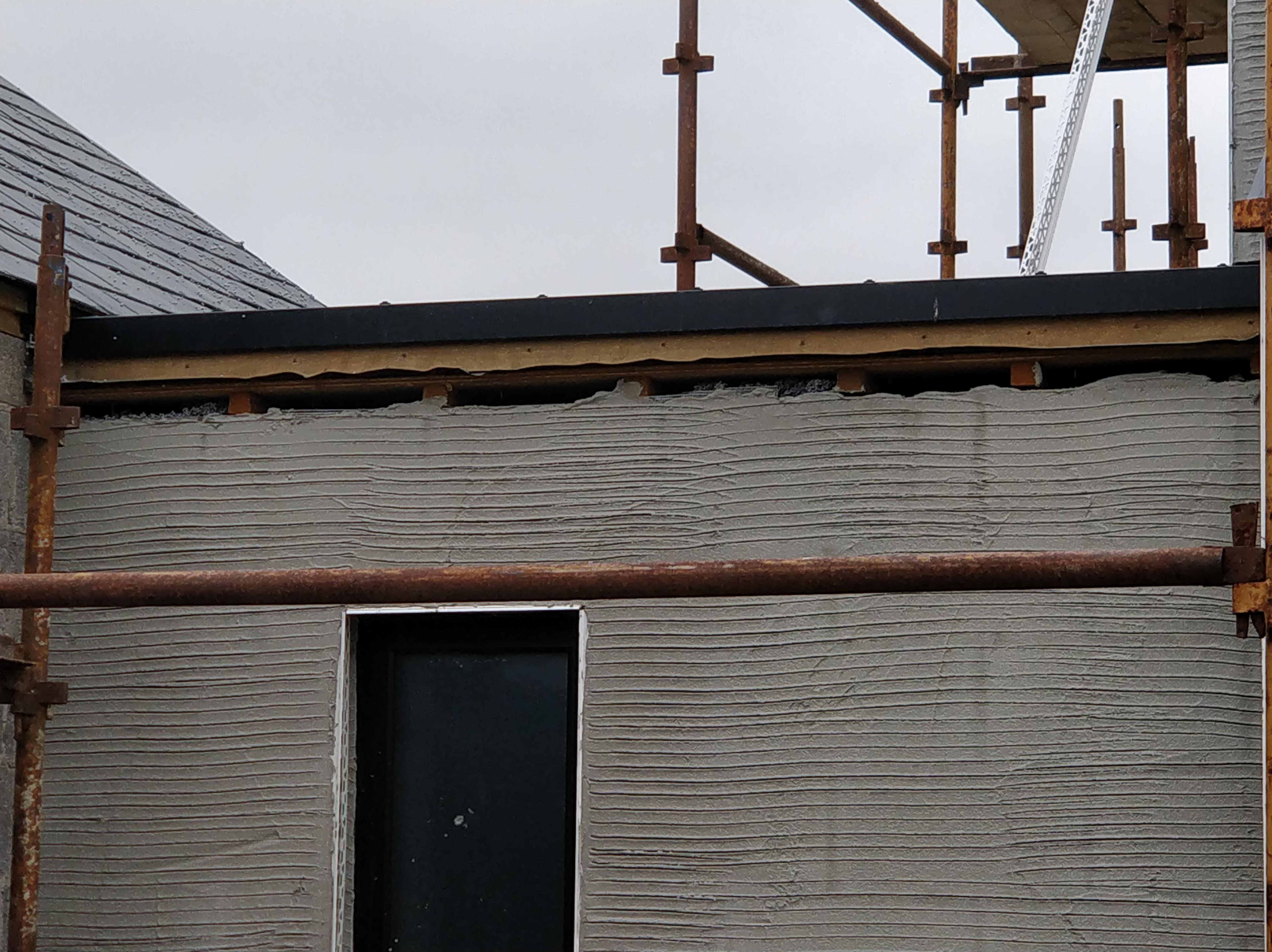

vfrdave Posted July 12, 2018 Share Posted July 12, 2018 Any ideas how to render this off nice and neat to flat roof trim. Walls were built without considering the fall of the flat roof hence why roof timbers are above wall. Haven't managed to ask the plasterers yet. Link to comment Share on other sites More sharing options...

vfrdave Posted July 12, 2018 Author Share Posted July 12, 2018 We don't have facia other than around the other flat roof so not sure it would look right. 8 minutes ago, Onoff said: Black upvc? Link to comment Share on other sites More sharing options...

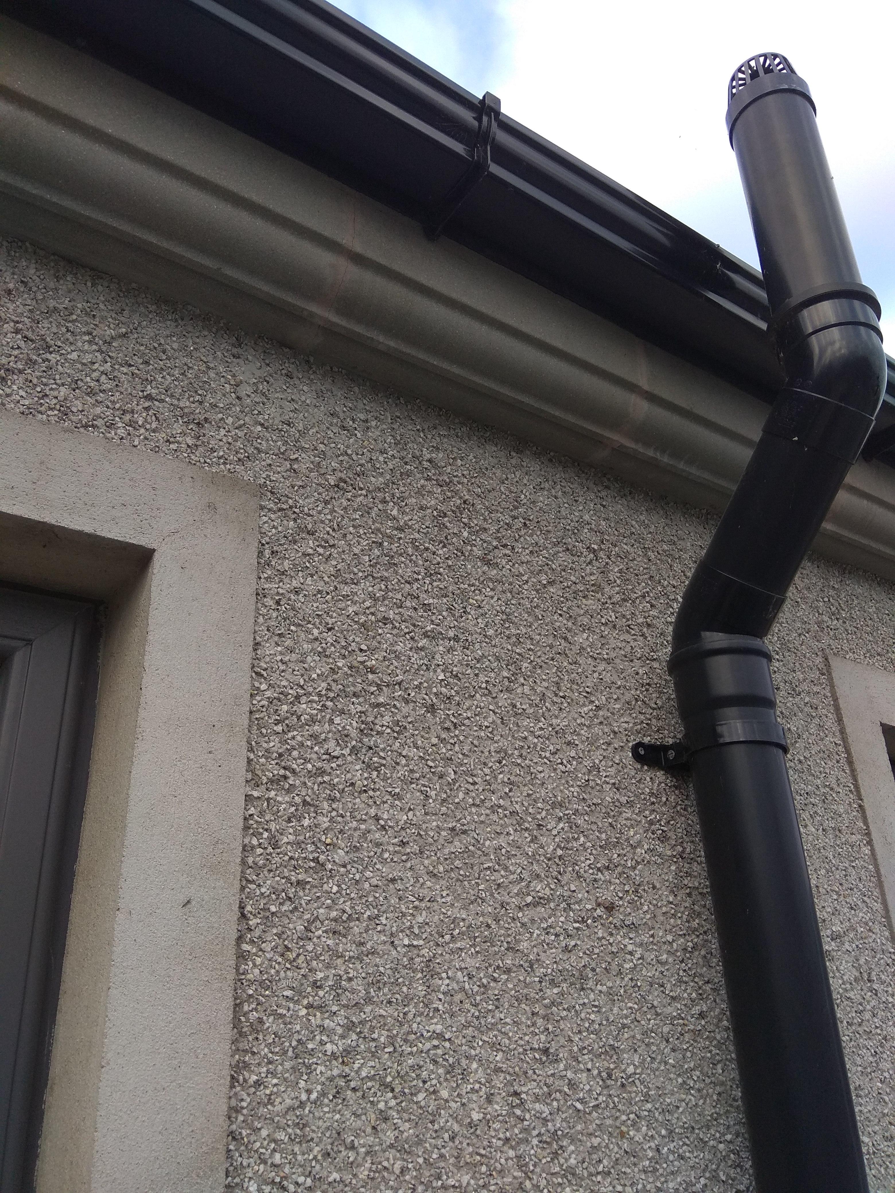

Declan52 Posted July 12, 2018 Share Posted July 12, 2018 (edited) A L strip of cement board from the underside of the black bit too the blocks. It will step out so will look like a feature. I used roof block for the same kind of look. Edited July 12, 2018 by Declan52 Link to comment Share on other sites More sharing options...
vfrdave Posted July 12, 2018 Author Share Posted July 12, 2018 22 minutes ago, Declan52 said: A L strip of cement board Does cement board come pre formed in an L shape, not familiar with it. Link to comment Share on other sites More sharing options...
Declan52 Posted July 12, 2018 Share Posted July 12, 2018 No comes in a sheet like ply so will need cut and a L made. Nail a batten across the roof line where the line is in the pic. It will be whatever depth it needs to be to get out so the piece of cement board screwed up to the black bit is plum. Then cut another piece of cement board to hide the underside of the batten. Or just use uPVC fascia as the L shape on it might be enough to cover it. If your putting a gutter on that side most of it will be covered anyway. Much cheaper and easier to do. Link to comment Share on other sites More sharing options...
Russell griffiths Posted July 12, 2018 Share Posted July 12, 2018 Eps insulation cut to look like a continuation of the wall, mesh it up with the fibreglass reinforcement, render whole wall as one. Link to comment Share on other sites More sharing options...

mvincentd Posted July 17, 2018 Share Posted July 17, 2018 On 12/07/2018 at 19:06, vfrdave said: Walls were built without considering the fall of the flat roof hence why roof timbers are above wall. So is that the ends of furrings beneath the deck we are seeing?....and clear space through into your joist cavity. in which case don’t you want those elements seriously protected. How much distance available from wood to render face? Link to comment Share on other sites More sharing options...
